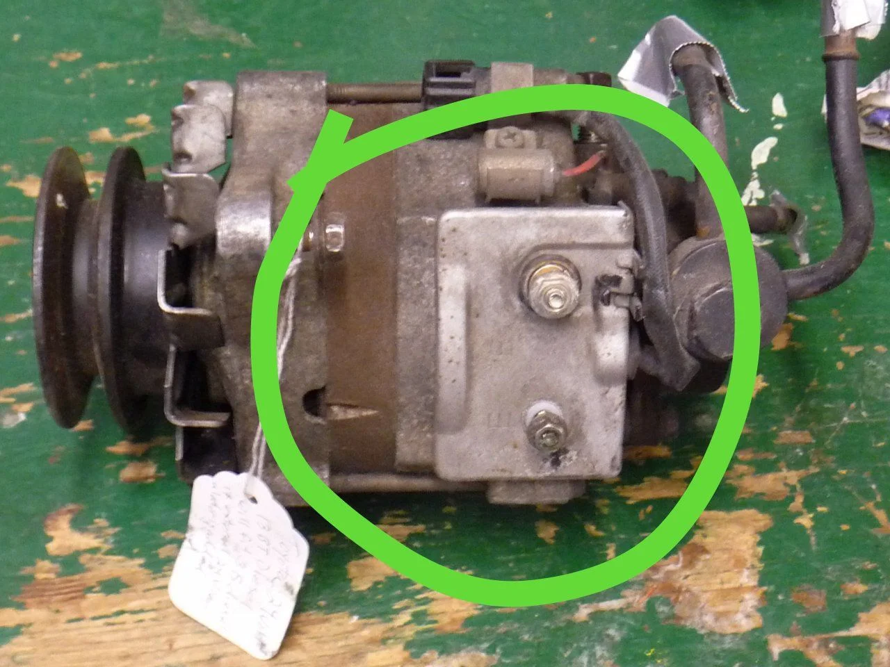

Maybe im just confused by terminology but my 12v 3b's have the voltage regulator mounted on the side into the alternator. I would have called that an internally regulated alternator?
Maybe its a difference between 12v and 24v but I have at least one 24v kicking around and it's looks the same.
A
Edit: A little more info aparently some were externally regulated. In here a guy talked about gutting a 2h to swap the internals. 3b 3.4 4 cylinder diesel alternator
If the bearings are good there's not a lot to go wrong with these. voltage regulator, brushes or a diode none are big deal to replace or rebuild.
iirc you can add an internal regulator to a non internally regulated alternator fairly easily. If you take the two to A&B starters by the airport they can rebuild it to use an internal regulator. I have had them build/modify a few for me over the years. The ear mounting pattern changed slightly over the years and model to model 24/12, 2h/3b but a lot of parts are interchangeable.
