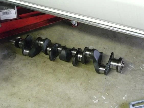

here are some pics of one i did on a 2F for a guy. having the crank turned was only 98 bux and that was goin .020 over on mains and .010 on rods.
the above motor ran great and had no noises. the whole reason for pulling the crank was because the crank pulley came loose and tore up the crank, once the pan was off I found some other more important things goin on.

and this is the guy's truck i did it on. :cool:
BTW how is she running? did you drive it back to Austin? No problems i would hope. I assume no rods came flying out the side of the block.
It ran awesome when i pulled it out of the garage. Defiantly one of the quietest 2F's that i have ever heard (or not heard) one of the smoothest running as well without a dought. and ive seen, driven, worked on enough of em to see just about everything.
