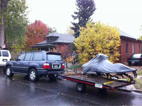

I can attest to the fact that the 295/65R18 Duratracs fit the hundy stock. I have an '03 LX that I bought a couple of months ago and put these tires on a couple weeks ago. There is no rubbing at all! Well, I get just the slightest bit of rub at full turn, but I rarely ever turn the wheel that far.
My truck is basically stock for the time being. My AHC still works great so I'm riding at stock height most of the time.
I will say, though, I almost wish I had gotten bigger tires, but the next step up to 305s and you would definitely rub at least the UCA. Right now I have about a 1/4" between the inside of my tire and the UCA.:clap:
I wish more people rode these shoes and brought that price down. It's a beautiful looking tire and quiet too. Not as quiet as the BFG ATs I had on my 80, but I kinda like that I can hear something telling me that I'm driving a bad-a$$ truck and not some fancy pansy grocery getter.
Only photo I have at the moment.
art - Those look really nice. I would love to see more of a close up, if you could.

My LX is new to me too. I thought my tires might get me through the winter, but being that I'm going up to the mountains a lot this winter (every winter) and hauling a trailer with two snowmobiles I thought I'd rather be safe than sorry. Well, that was my excuse. I was just dying to get some new, fat tires :grinpimp: So happy I did. I just can't figure out what to do with the spare. It fits in the stock location, but not with my integrated tow hitch installed.
The ride is only slightly more harsh, which I don't really mind, honestly, since I came from an 80 series with 35" BFG ATs. It's still way too soft in my opinion, but at least I can adjust that with the AHC. I think these tires made the truck perfect and I am so happy I took the risk of buying them and hoping they fit :rolleyes:
