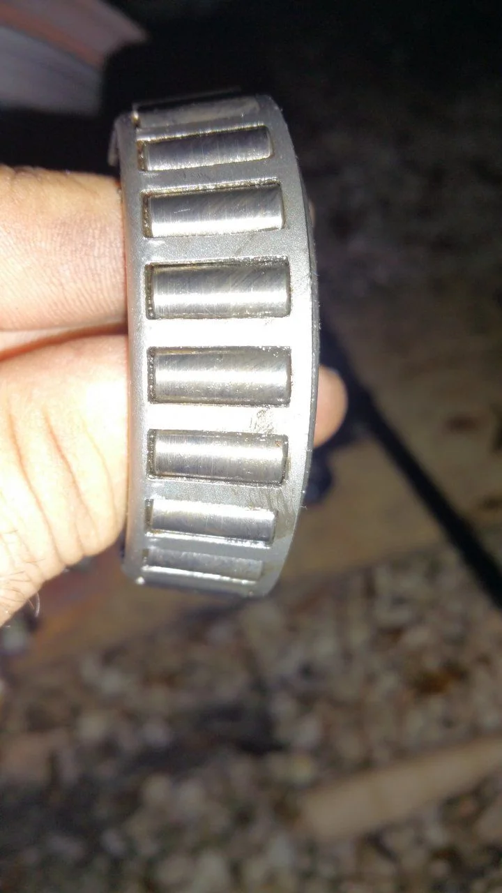

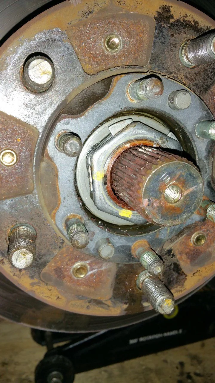

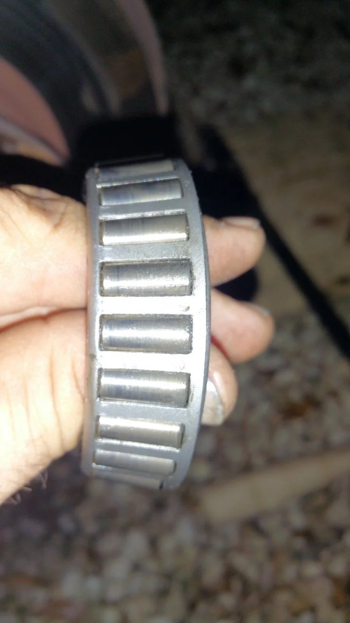

As far as I know these front bearings were installed in September of 1999. Perhaps the yellow markings suggest the same. I personally don't see any signs of wear and they seem to spin mighty nice.

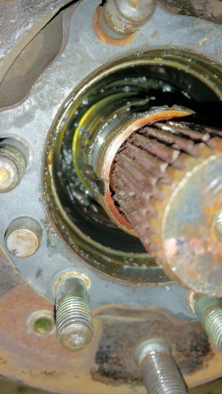

I decided to enter the hub and repack bearings due to a mechanic said there was play in the wheel perhaps causing the VSC and violent braking that I inquired about in another thread this morning.
When I tried to move the wheel it just barely moved at all. I was expecting more but none given.
Currently I am not able to get the caliper bolts off (because they have never been off) and stopped trying when my extension begain to twist. So, I'm done trying for now.

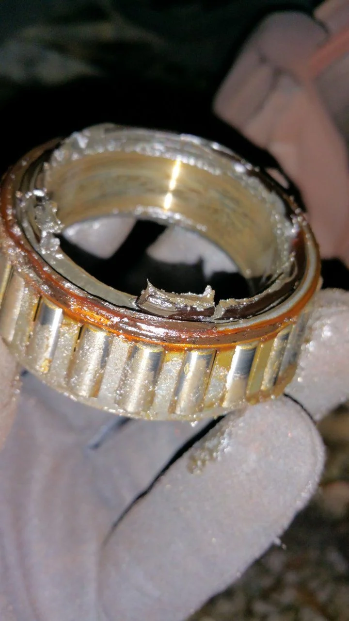

I'd use 1/2" drive on them, not 3/8". Also a 1/2" drive impact is pretty handy. The inner and outer bearings will need to be packed. The hub will need to be cleaned out. You might want to consider replacing the seal. I had to replace the two washers on each side when I repacked my bearings.

Color of old grease looks a bit like water contaminated.
Appears you have some minor scoring & pitting on bearings, not to bad. But bearings need a really good cleaning with solvent, water then compressed air to see clearly. But for $80 a side I just replace. Cruiser Outfitters
