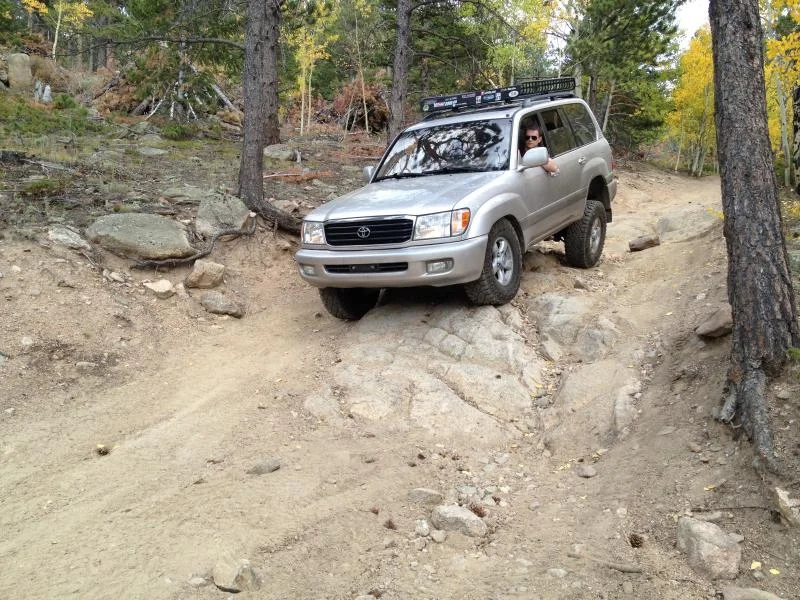

If you're not going offroad you can run 295s. I swapped my 295s onto my new stock rig last week and drove 300 miles, some on mountain roads. But no off road.
That being said, spend the $50 on spring spacers if you're going to run 295s. If you really don't want to run any lift, get 285/75/16s.
Stock clearance while turning with 295s.
