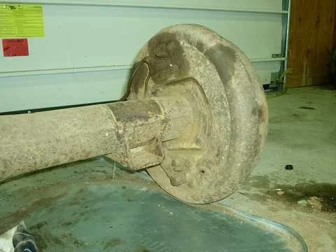

Dug this out of my pile, a PO's way to modernize, FJ 40 brakes adapted to 25 rear axle with a 90 deg twist, thought I'd share this with Steve before he shot himself...it could be worse...somehow

Awww, they're not THAT bad...but I'm having a hard time thinking up anything worse! :D ...except maybe the rear drums on my GMC dually van. Pull the rear full float axle shafts, remove the wheel bearing nuts then remove the 80 pound drum with hub and bearings as one piece. :rolleyes:

The one I have with with 40 brakes has the brake cylinders top and bottom so I guess it was a 25 axle converted and not a early 40 axle. My early 40 axle has the wheel cylinders side by side. The wheel cylinders on the 25 have spring clips over the ends of the rubber boots. Has anyone seen this before?
