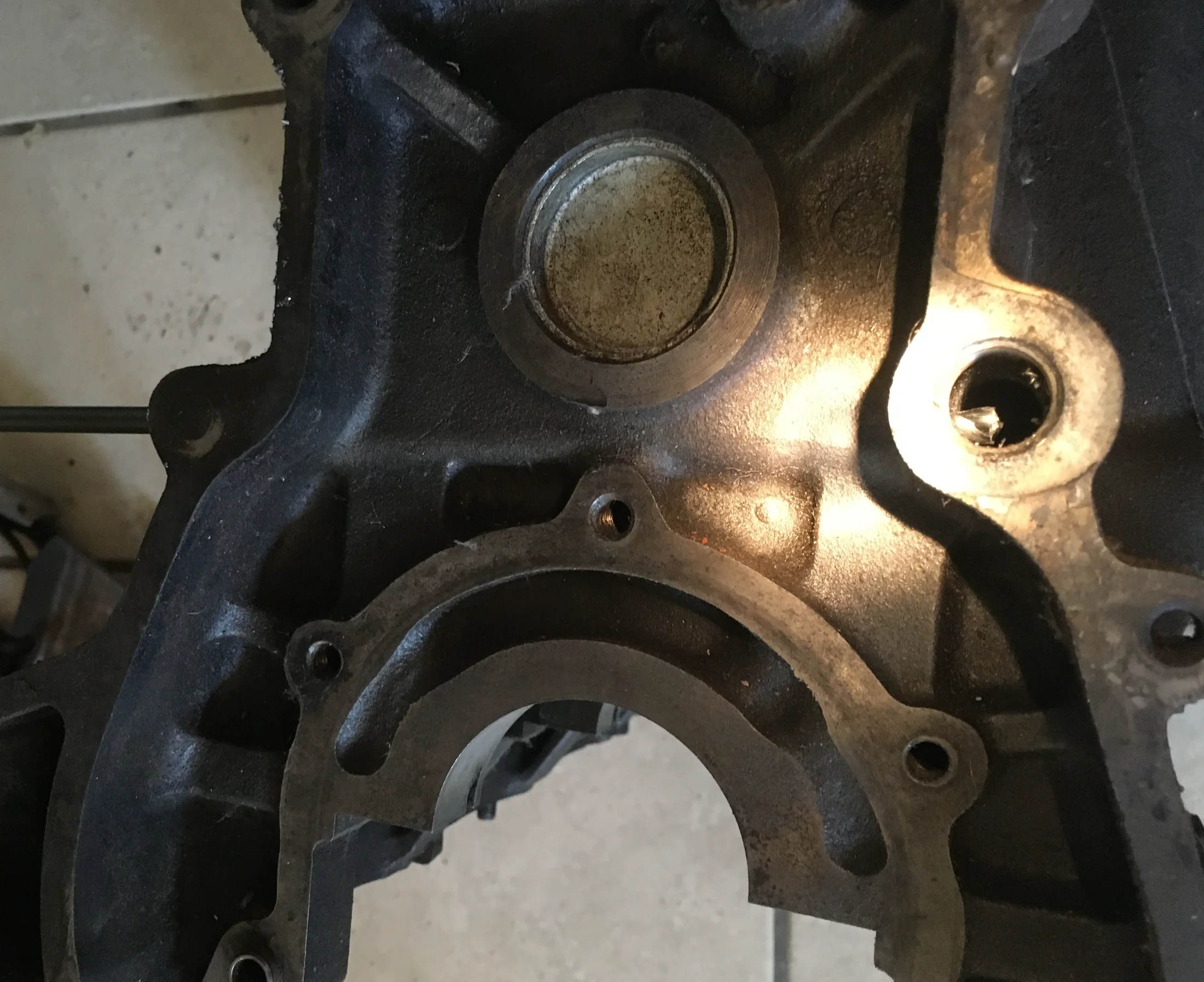

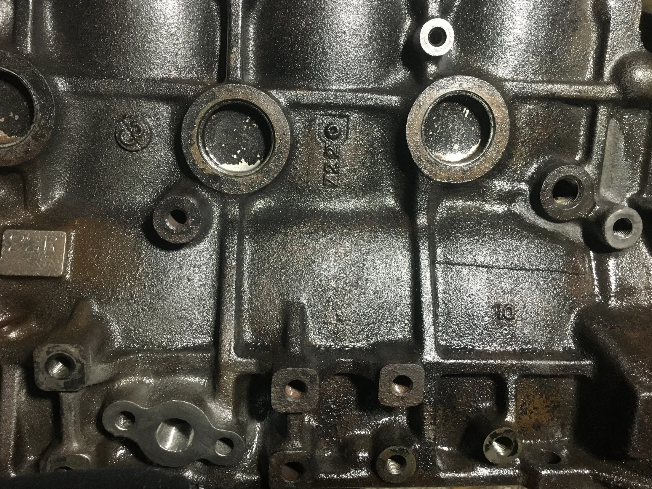

Turbo oil feeds from the oil gallery on the air intake side of the engine to the exhaust side through a long hole at the rear of the engine block. The oil drains back into the engine through a hole in the "bow tie" on the exhaust side. Both holes must be drilled and the machine work for mounting hardware completed.
Long oil feed hole drilling accomplished.
"Bow tie" machine work finished.
This engine block has been in use with a turbo for years with no issues.
