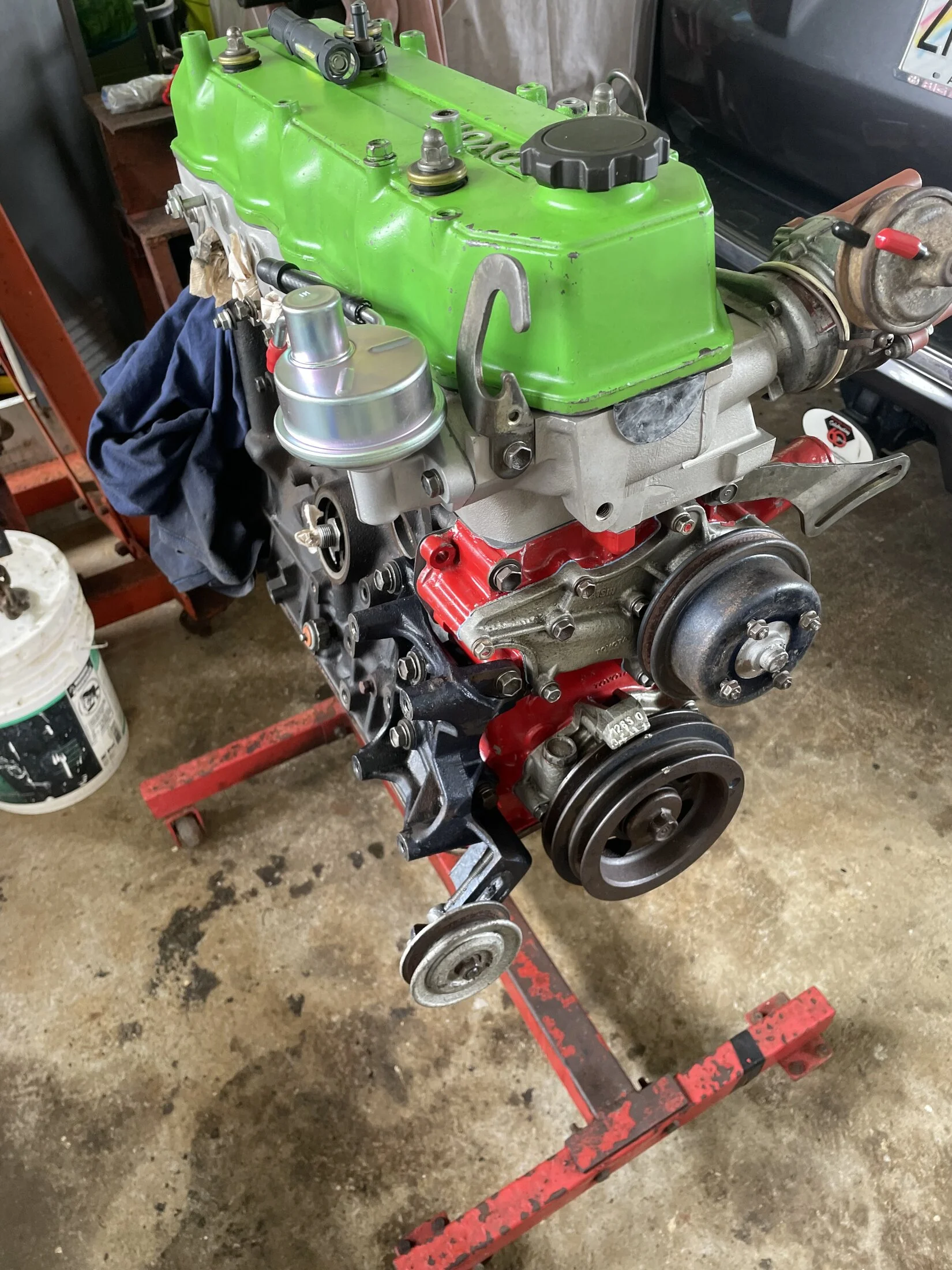

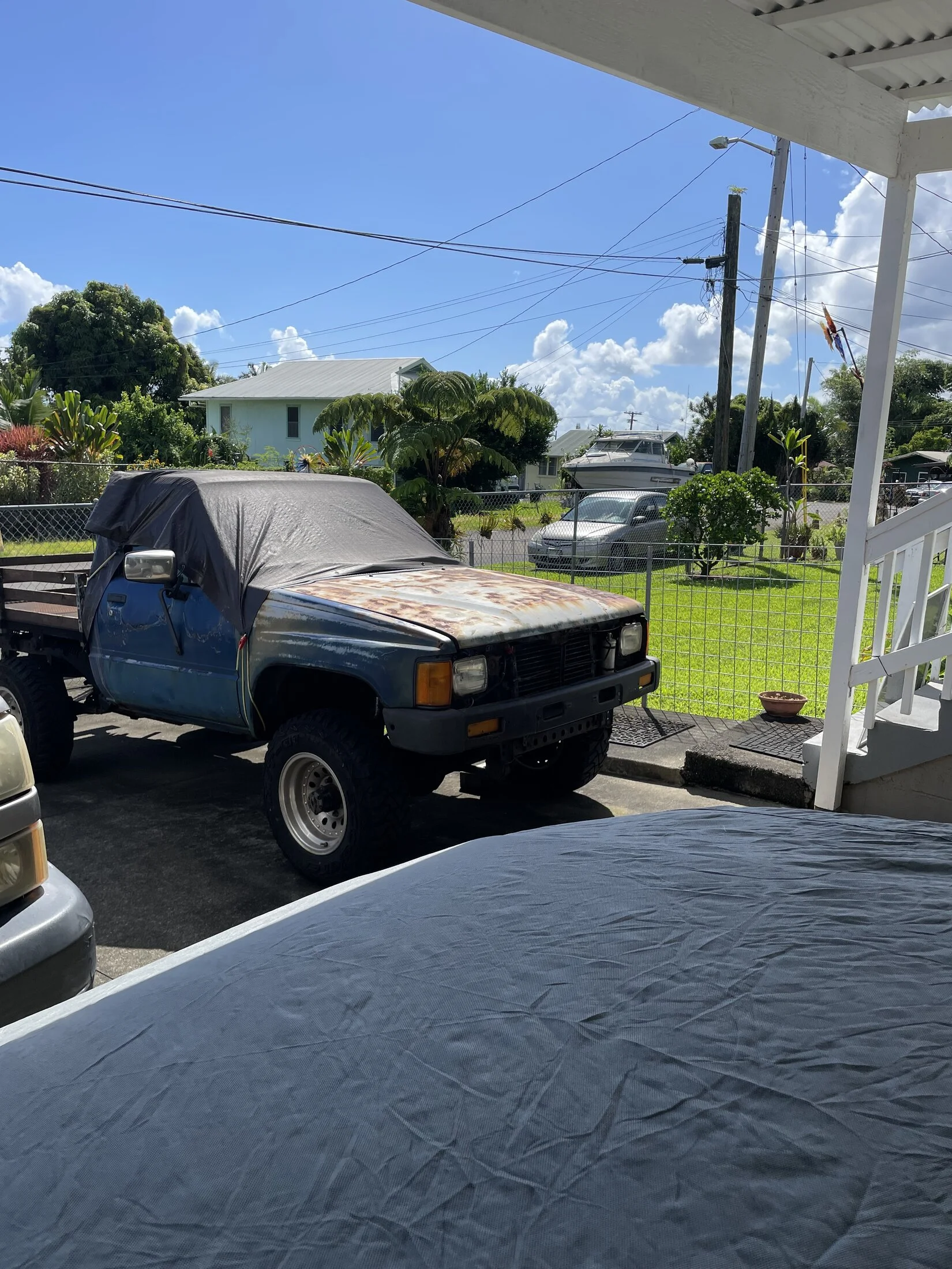

That green valve cover is hideous (PO I promise) I have not had time to strip and repaint. Bed was falling off so I fabbed up a flatbed.

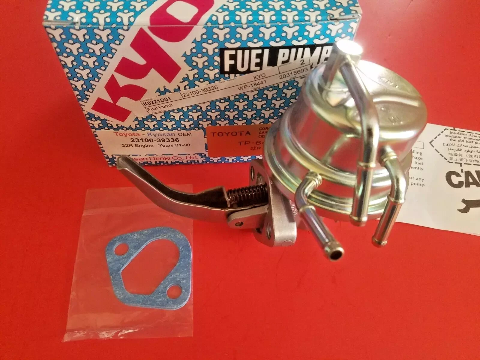

You will damage the pump with no spacer. The Kyosan that I just installed specifically states this.

That green valve cover is hideous (PO I promise) I have not had time to strip and repaint. Bed was falling off so I fabbed up a flatbed.View attachment 3787005View attachment 3787003

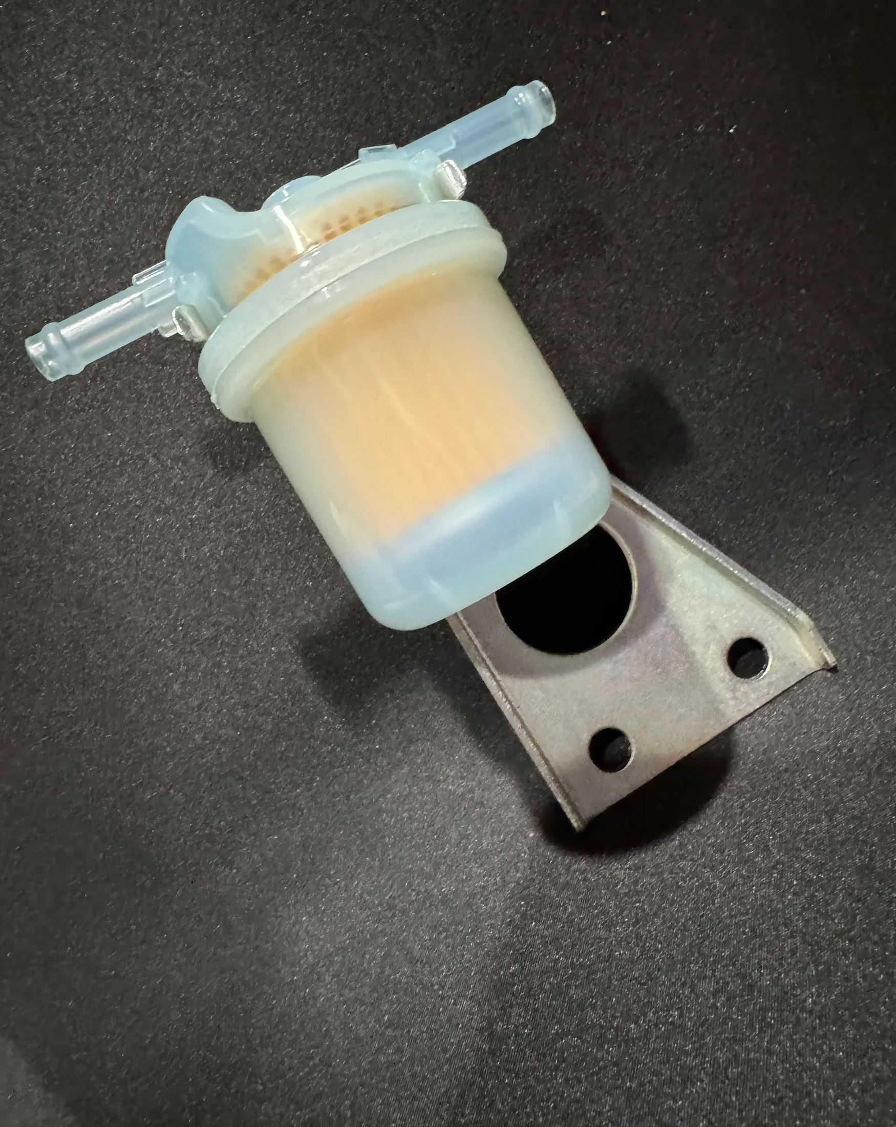

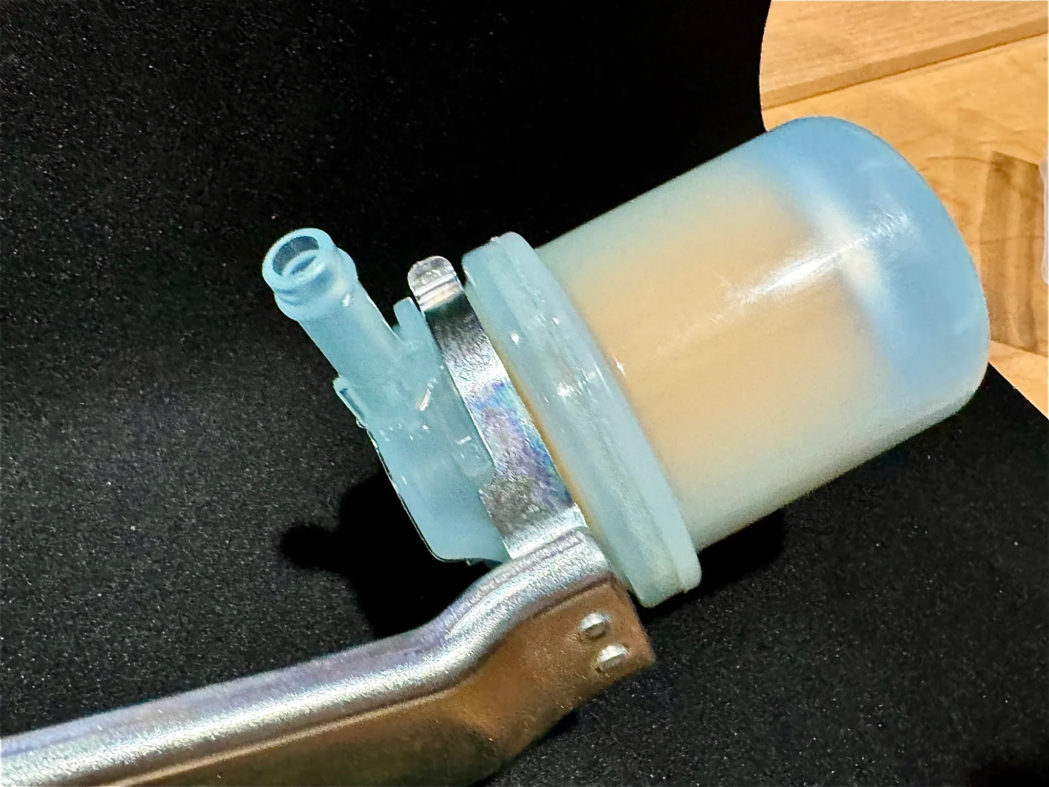

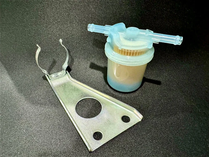

how come you did not purchase the OEM 23100-39336 / TP643
oem KYOSAN ?

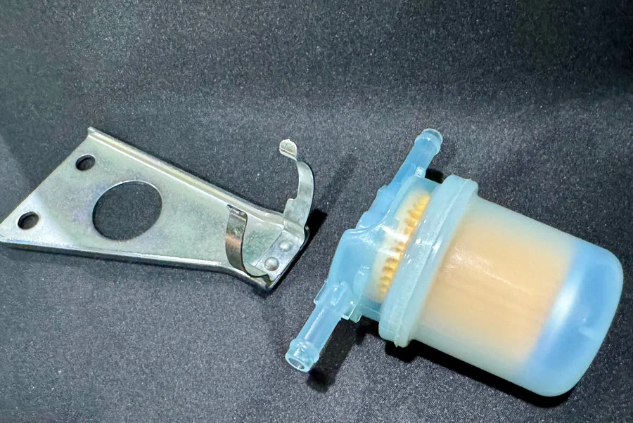

OEM KYOSAN Fuel Filter too is A Must must here ///
i offer these now ,
Bracket can be mounted in either vertical position
WILL hold securely any TOYOTA translucent fuel filter like the 15020 or the big-mac-daddy 2F FJ60 one
