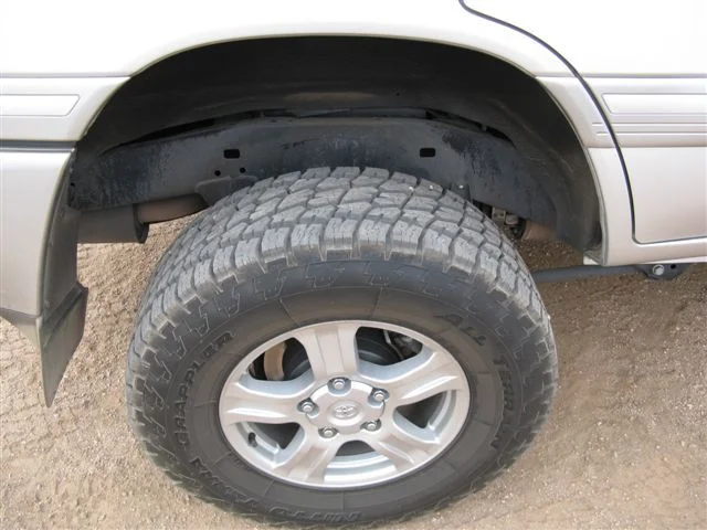

Nice to know they don't rub. I thought in "normal" the usual spot of the back front well plastic nub would rub on a turn.
Very close as you said but no rub, part of the reason I went with tire I did. I was lucky that I had the '99 with larger tires to measure off of prior to purchasing tires.

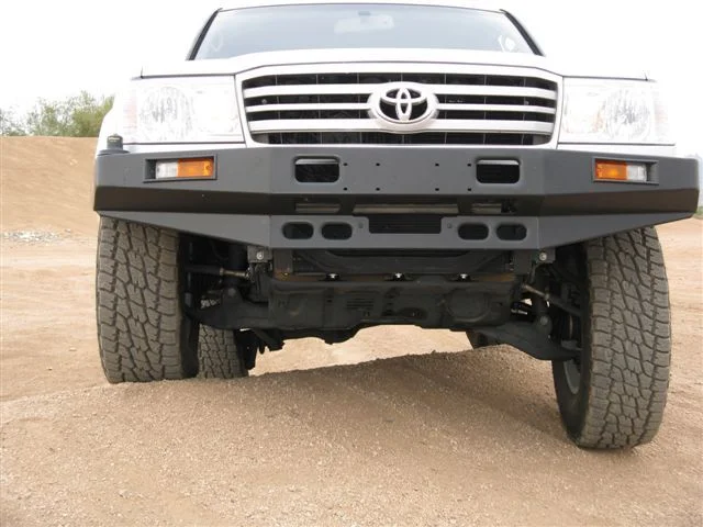

I have AHC and it flexs easier and more then a 100 without AHC so unless you have AHC there are others that could give a better answer.
Wow. This is the first I've heard this. You're saying AHC offers more travel in the front and rear compared to non-AHC model?
I could not get my '99 with stock springs and T-bars to this is the same spot Im sure OME is not going to do it any better then stock.
The OME shocks (not the L's ;) ) are the same lengths open and closed as the AHC rams (from a 2001 anyway) so OME should have the same travel as AHC (had a measuring session recently when I got rid of the AHC and put the Bilsteins on). That says nothing about none AHC OEM of course or how easily stuff flexes.
Hmm, interesting. Thanks for posting.
Front end? I have a hard time believing that AHC offers more than the 7.5" travel spec. I can surely believe that AHC stuffs/flexes easier than OME due to spring rate. If you carry the added rate up front then OME setup will travel for sure. It's from a different angle however both wheels apprear to travel about the same.

From what I can tell from wheeling with 2000UZJ, AHC does not offer any more flex than a stock 100. The only advantage is that AHC seems to allow the suspension to flex more easily.....essentially softer spring rates/different valving. Basically stock AHC vs Stock Non AHC = same amount of total travel.
Shotts isnt that picture of the rear of your 100 after you mounted N74L shocks? If so, then thats not a fair comparison.
Post of picture of the front of your with the front fully stuffed (if you can fully stuff it) and you will see the difference.

FWIW - The comparision was a stock T-bar '99 and a stock AHC '06. I own both, I tested both, and both run the same center of hub to fender lip when the AHC is in normal mode.

Here is what full stuff should look like and a picture of the bump stop to back it up.

I've already been out with LX's with AHC. I luv the ride! Smooth, good cycling suspension, a great setup. That said, they do lift wheels compared to what I'm now used to and so do Cruisers without L's. The 3" wheel travel gain is easily noted in the above pictures. I do wish my front spring rate was a tad less and the shock a tad firmer. It'd cycle better (like a stock Cruiser...like your AHC).
