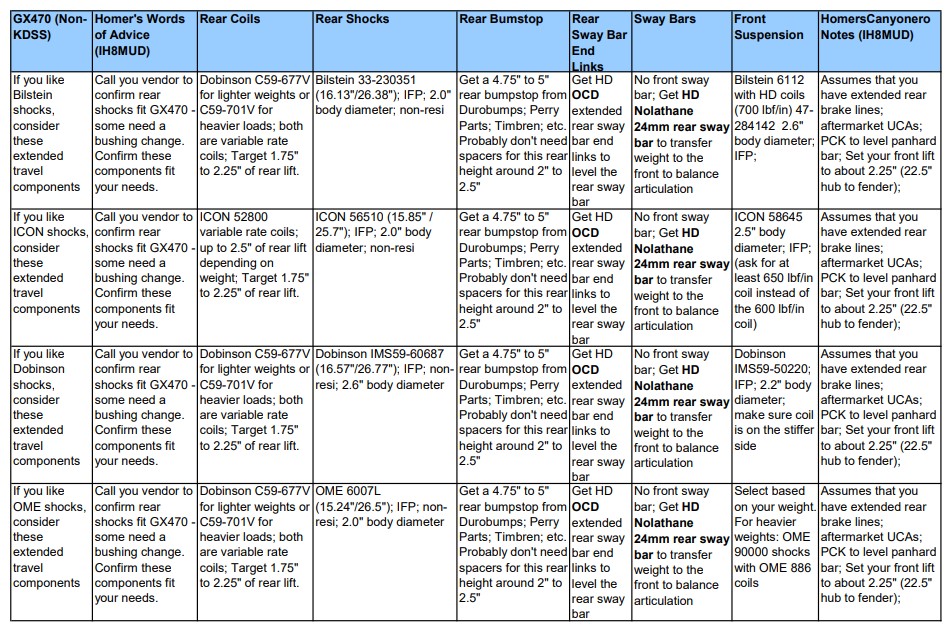

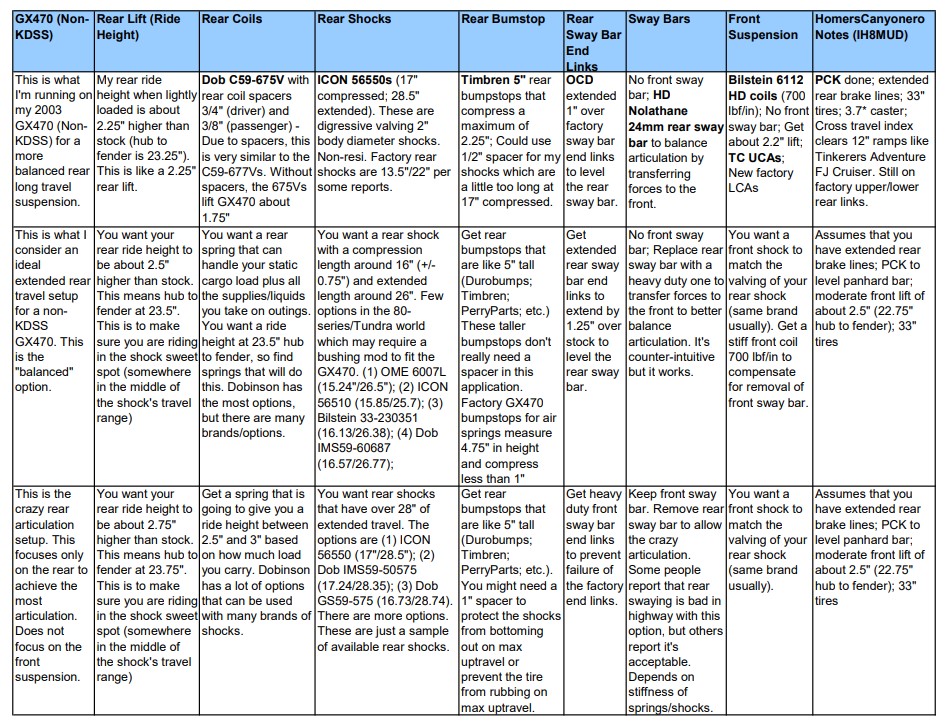

Check out this chart…

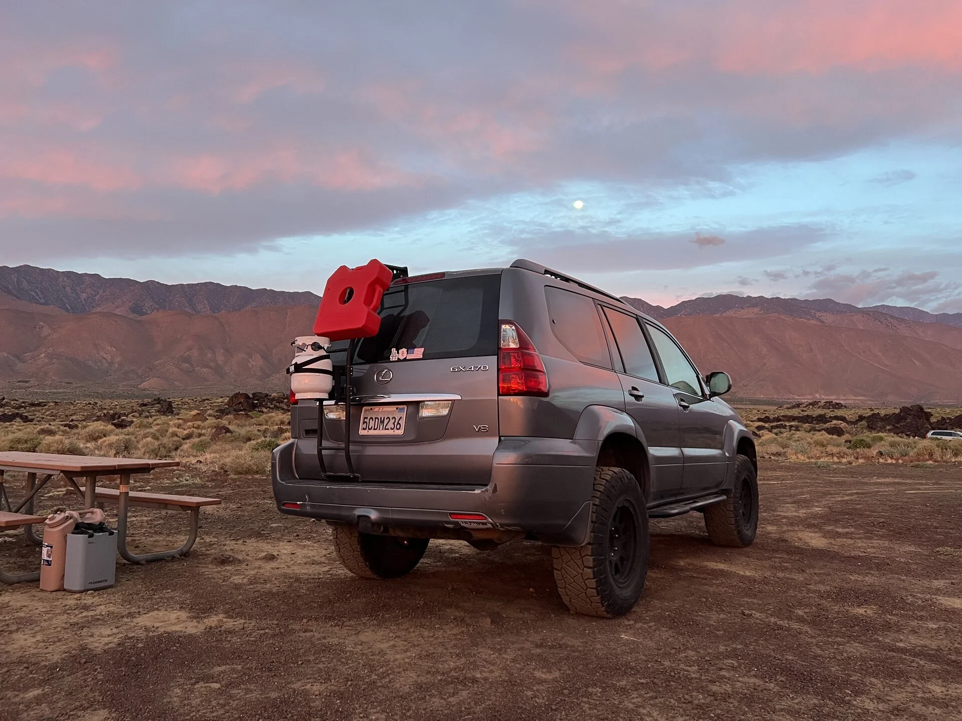

This is what I run in my 2003 GX470 for the last 6+ years:
  • 17x9 -12 offset rims
  • 285/70R17 Nitto Ridge Grapplers E (32.76” tall by 11.6” wide)
  • 3.7* caster
  • No front sway bar
  • 2.2” front lift
  • 2” rear lift
  • OPOR rock sliders
Zero rubbing, no BMC, only had to trim front fender liner like a couple inches
