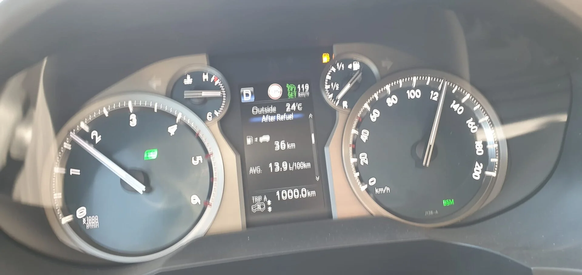

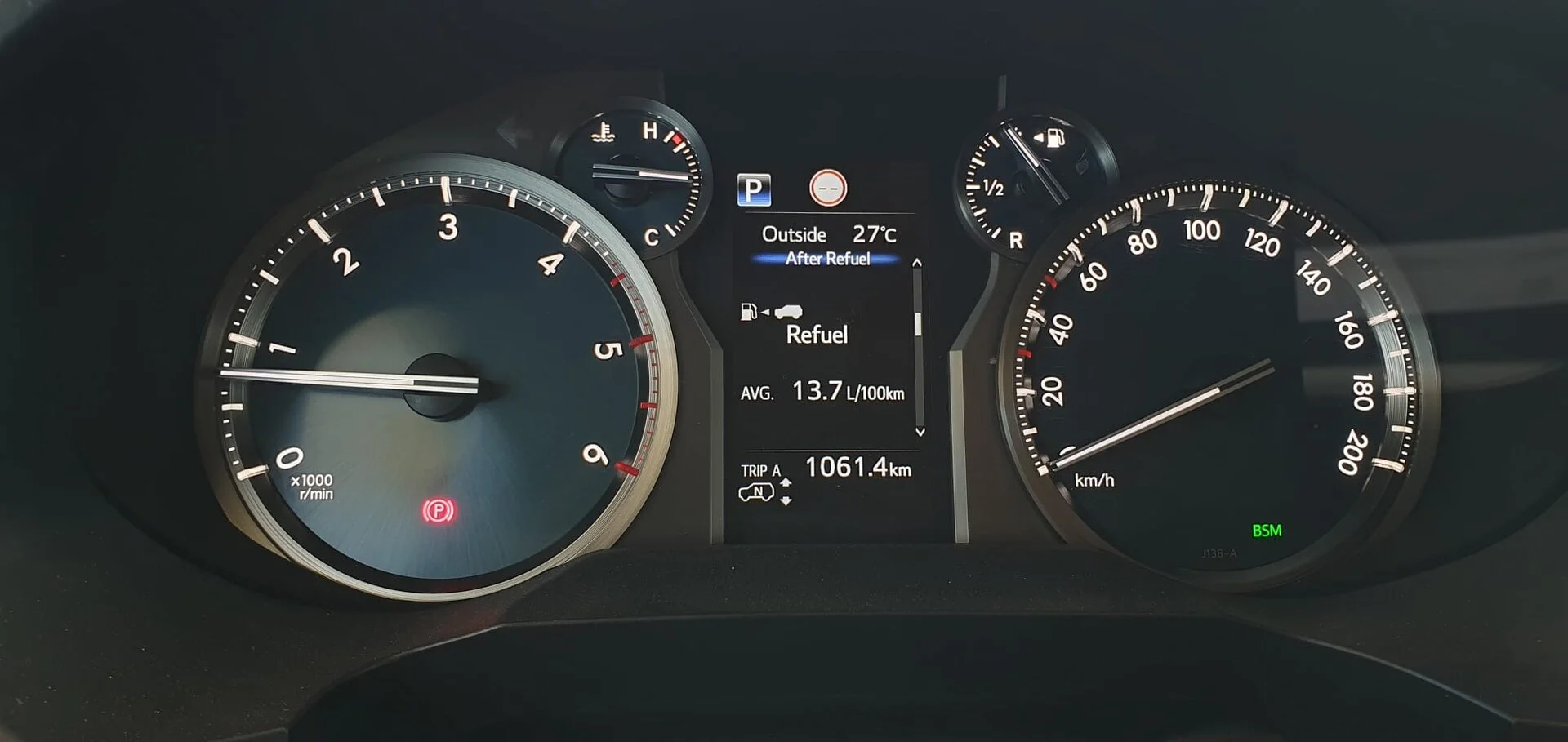

After refuelling, it takes 30 seconds to display the expected autonomy and here we have a problem!!! It does not display more than 550 kms of autonomy, even with 150L of fuel capacity full of fuel. What it does is decreasing 1 or 2 kms per 5 or 6 driven, assuming different autonomies randomly.

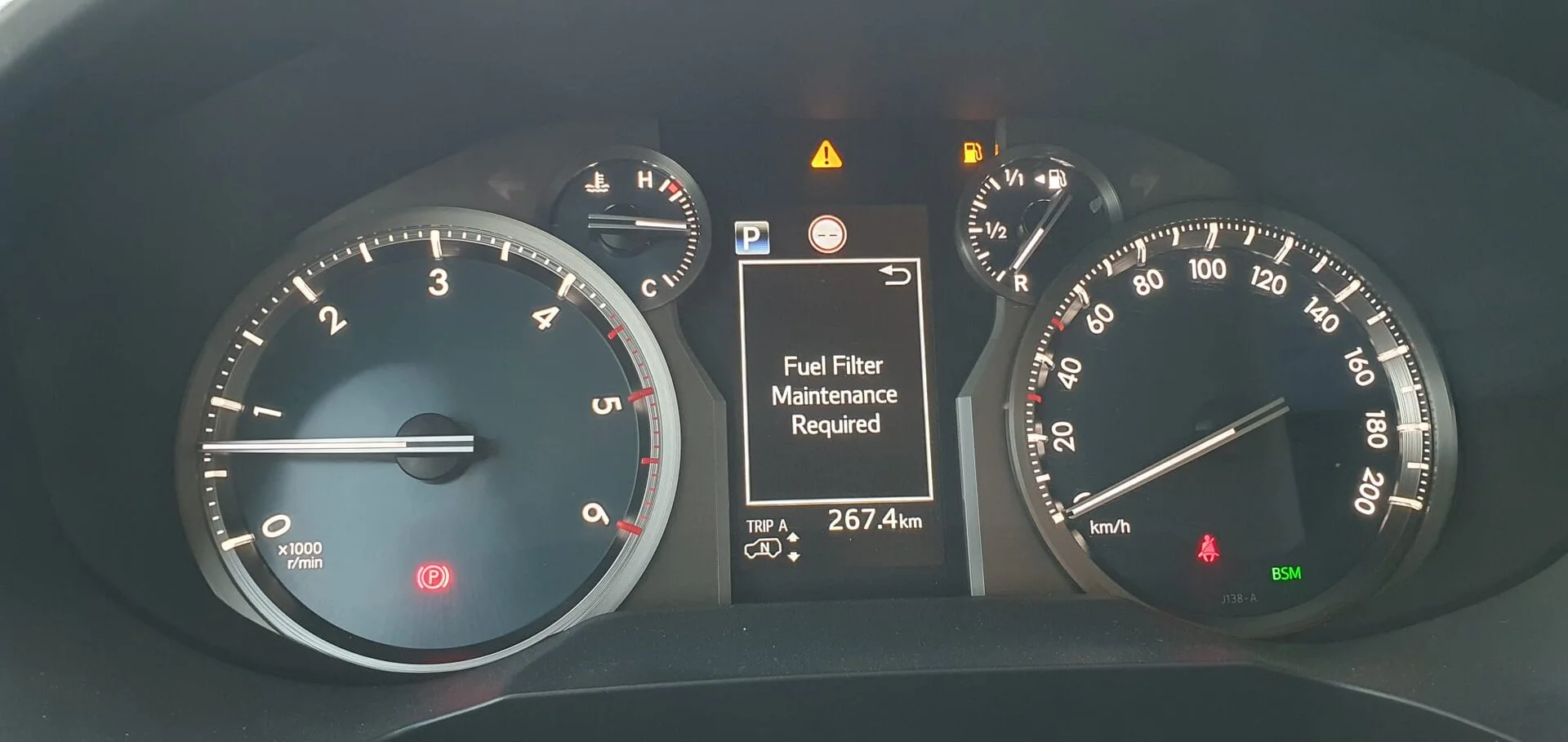

The main issue is when you drive constantly (cruise-control) at more than 120 kms/h and suddendly this message comes up...
I've replaced the Fuel filter, reset the message and if driven under 120 kms/h, everything is normal, no message whatsoever.
After driving for at least 25 kms above 120 kms/h, this message comes up and only resetting the fuel filter will it disappear...
The car drives normally to 180 kms/h, without any issue, no power lost, other than this message, so I believe not to be a short fuel debit to the engine, but...
I think that this problem is only a gauge/message issue, due to not having the new correct fuel capacity (150L) on the software system of the car, on the gauges, since the car only had a 87L fuel tank and now has an 87L plus a 63L additional tank.

Maybe the fuel filter message is due to the injection pump not seeing enough pressure from the tanks. That would make it think the filter's clogged. Do you have access to an OBD2 reader, or Techstream? You can scan for codes and possibly monitor the fuel pressure between the tanks and injection pump. I'm assuming there is a pressure sensor there but I can't think of any other way they'd measure the fuel filter effectiveness in order to put up the warning.
The plumbing could be wrong, or a pump defective, or a fuel pickup or line damaged.

I have some update on this matter.
TOYOTA told me that the fuel filter is different in the same model, depending if it has or not, double fuel tank.
I will replace the existing filter with the new one (part# 23390-36760) and test it to find out if the problem is solved.
