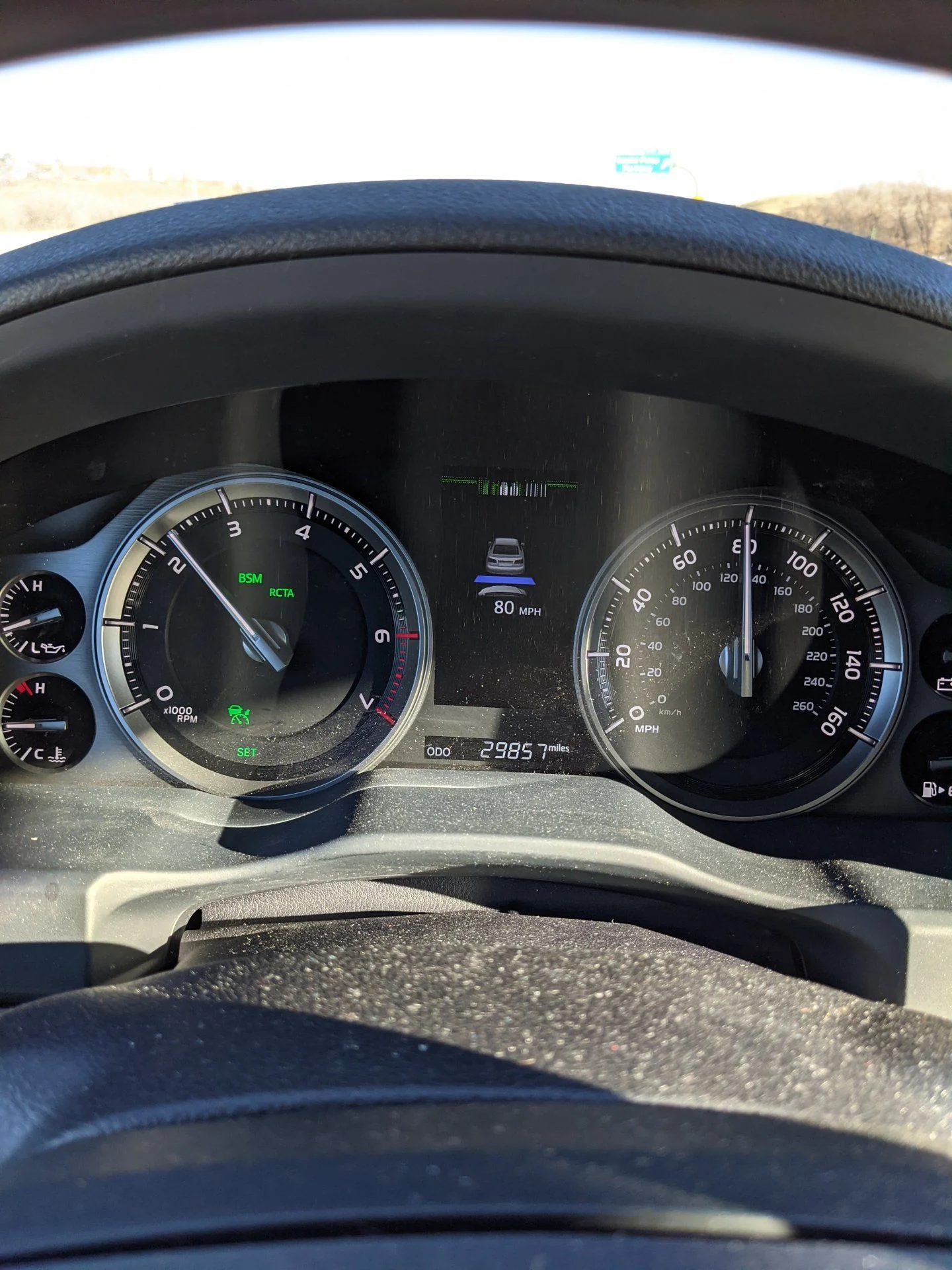

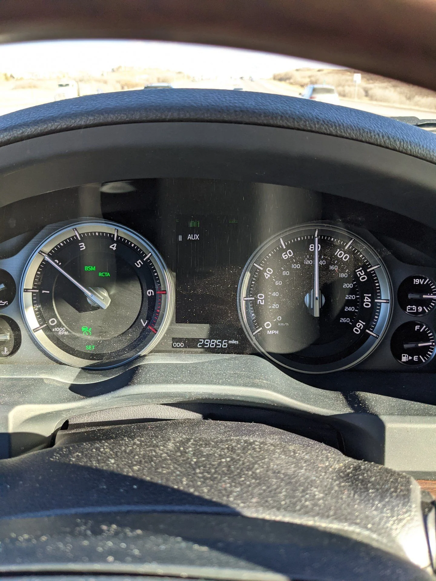

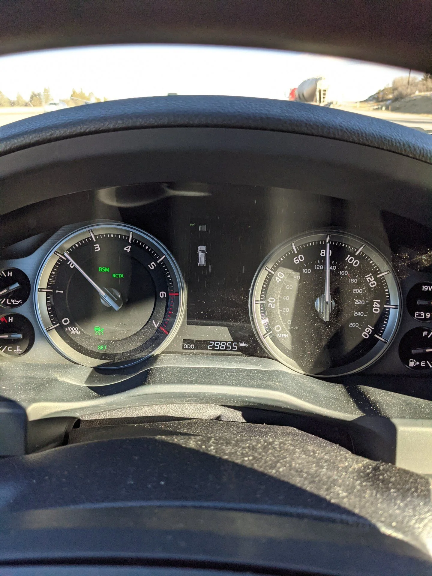

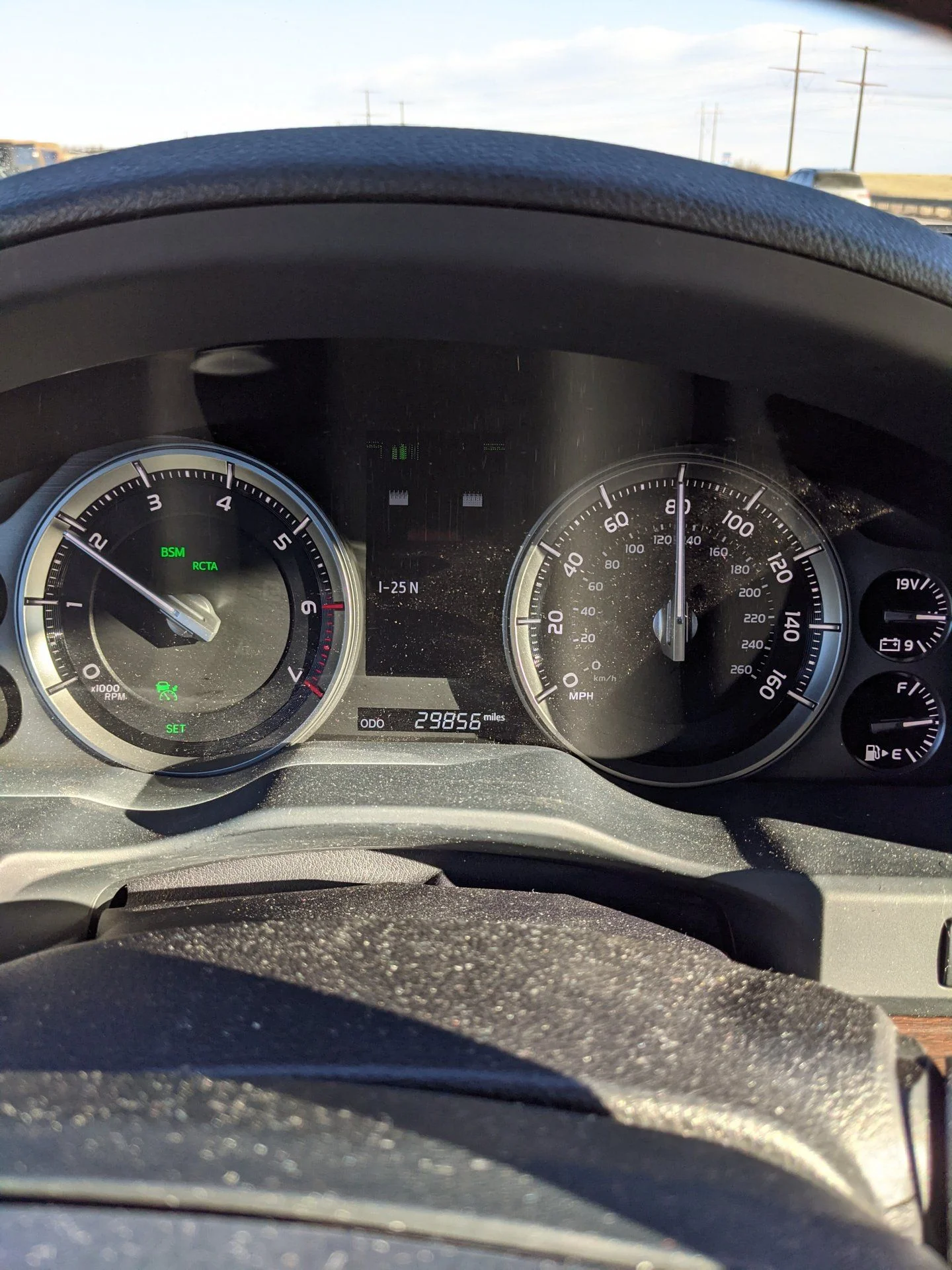

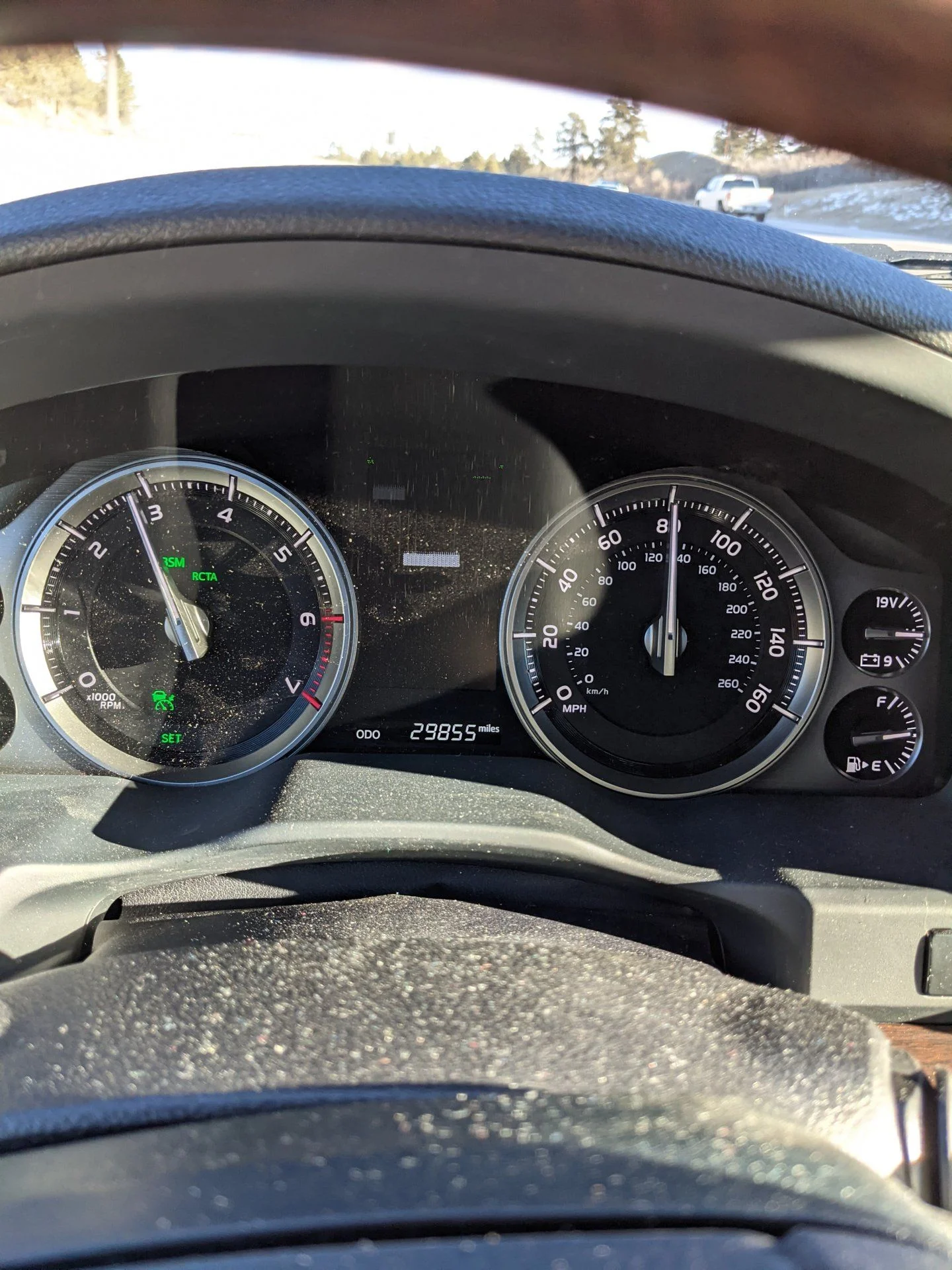

I was driving this morning and all of the sudden my driver's display went corrupted. When I reached my destination I turned the car off and on and it hasn't fixed the issue. Has anyone seen this before?? I do still have my manufacturers warranty so if I have to take it in I can.

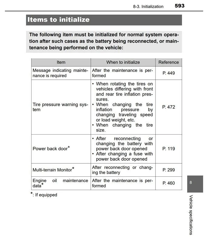

I thought about that but I thought I read there was a procedure you need to follow after reattaching the battery? Something with the back power door?
In the manual it says that's only if the battery was disconnected while the back hatch is open. The "procedure" is simply to close the hatch manually instead of with the power button.

You might want to check page 593 of your Owner's Manual, it looks like only the power back door and maybe the multi-terrain monitor, but any required initialization looks very easy:

It was just a frustrating thing to have happen after doing a years worth of research on the vehicle and never once have I heard about this particular issue. I'm in IT, and to me it looked like the screen disconnected or had a bad pin. It didn't look like memory corruption, but actual physical disconnect. It made me wonder if the HVAC recirc housing that was replaced somehow borked this up. I'm wondering if I should notify the dealership just so I can get it on record that something happened.
