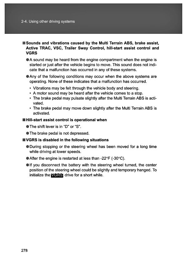

I know my 200 has VGRS with some electronic aspect, because the owners manual states:
"If you disconnect the battery with the steering wheel turned, the center position of the steering wheel could be slightly and temporarily off (hanged). To initialize the VGRS, drive for a short while.
I can't find that. Can you tell me what section it's in? There's no mention in the index or steering details.
It's on page 278 of my OM:
HTH
