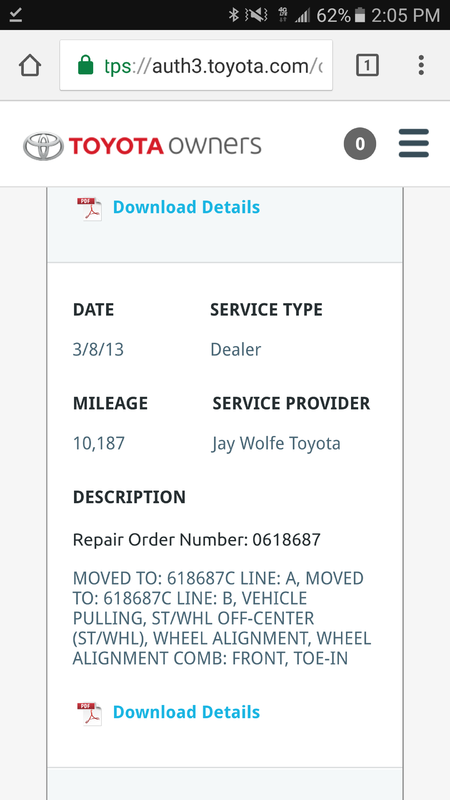

Looks like my 200 may have had this issue too according to the service records. Wild stuff.
