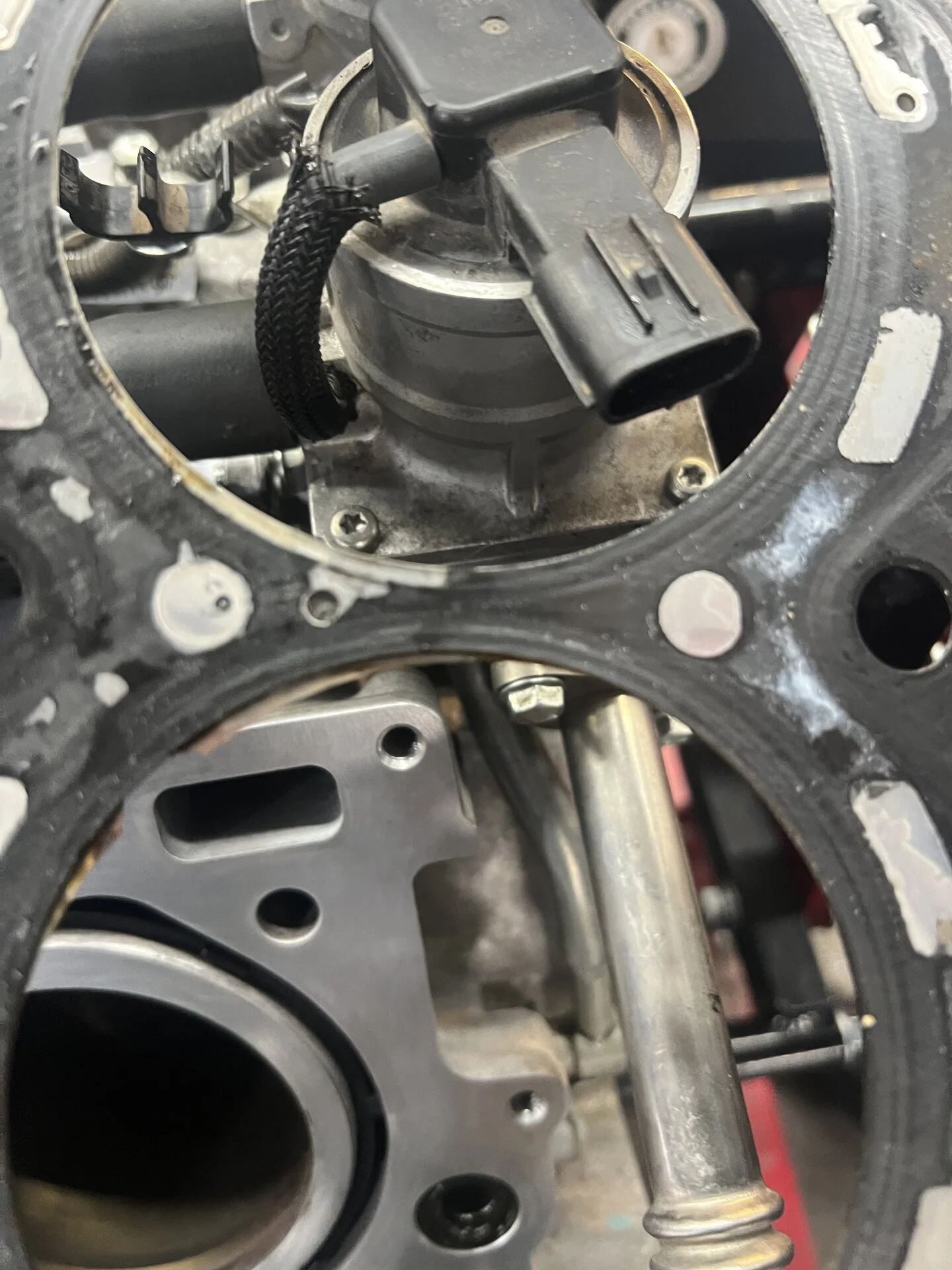

If you want to go down the rabbit hole, you can read in this forum about a YouTuber called the Car Care Nut who has some strong (and negative) opinions about the 3UR. His premise is that head gaskets are a huge risk due to gasket erosion. This is often attributed to acidic coolant resulting from poor maintenance. I just wonder how many of these failed head gaskets were accelerated by a high-heat event. Not anything I can proove, but for me it would be a concern. I do completely respect others who disagree.
Edit:
For the point of discussion, this is how small of an area we're talking about (small hole center left). You have an aluminum head on an aluminum block. Start starving that of even coolant flow and combine that with a gasket that is maybe already damaged from acidity and it just seems like a recipe for a bigger problem down the road.
