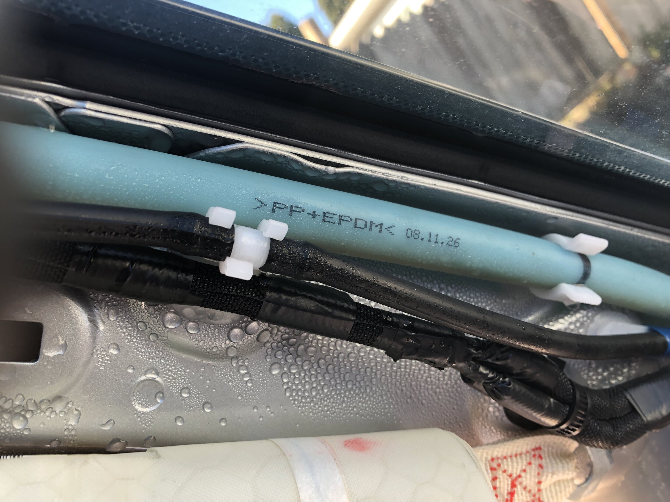

  • Had it towed to the mechanic, who identified a sunroof leak causing water intrusion on the passenger side and subsequent electrical issues.

I had the same problem as you back in 2018:( took it to local Toyota dealer, they replaced the smart key ECU and the fuse block under the dash. They said it was corroded from leaky windshield gasket.

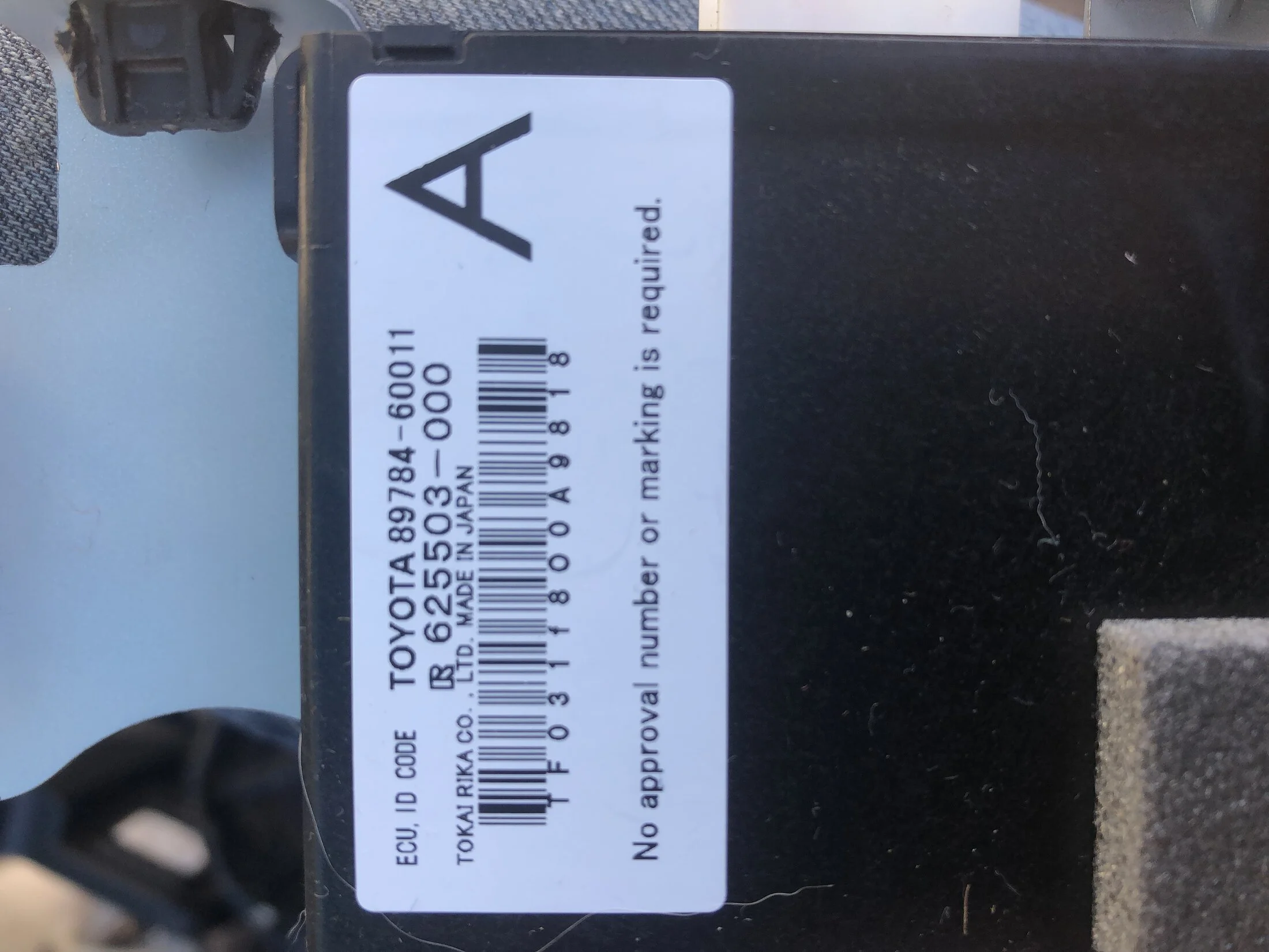

After $3500 spent for nothing at the dealer, I took the truck back home. Searched the web, found out that on 200series, Toyota put an independent Immobilizer behind the HVAC unit

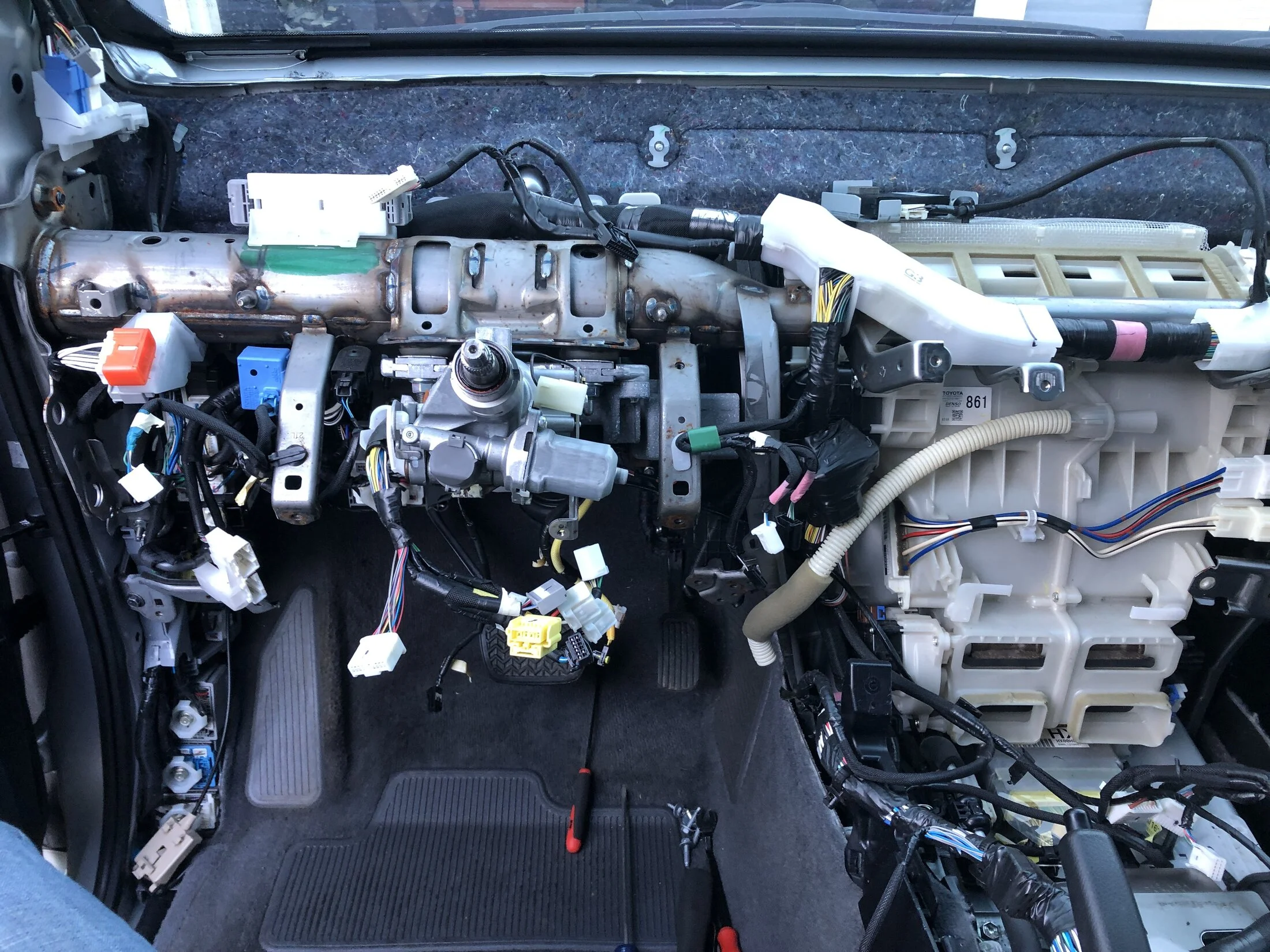

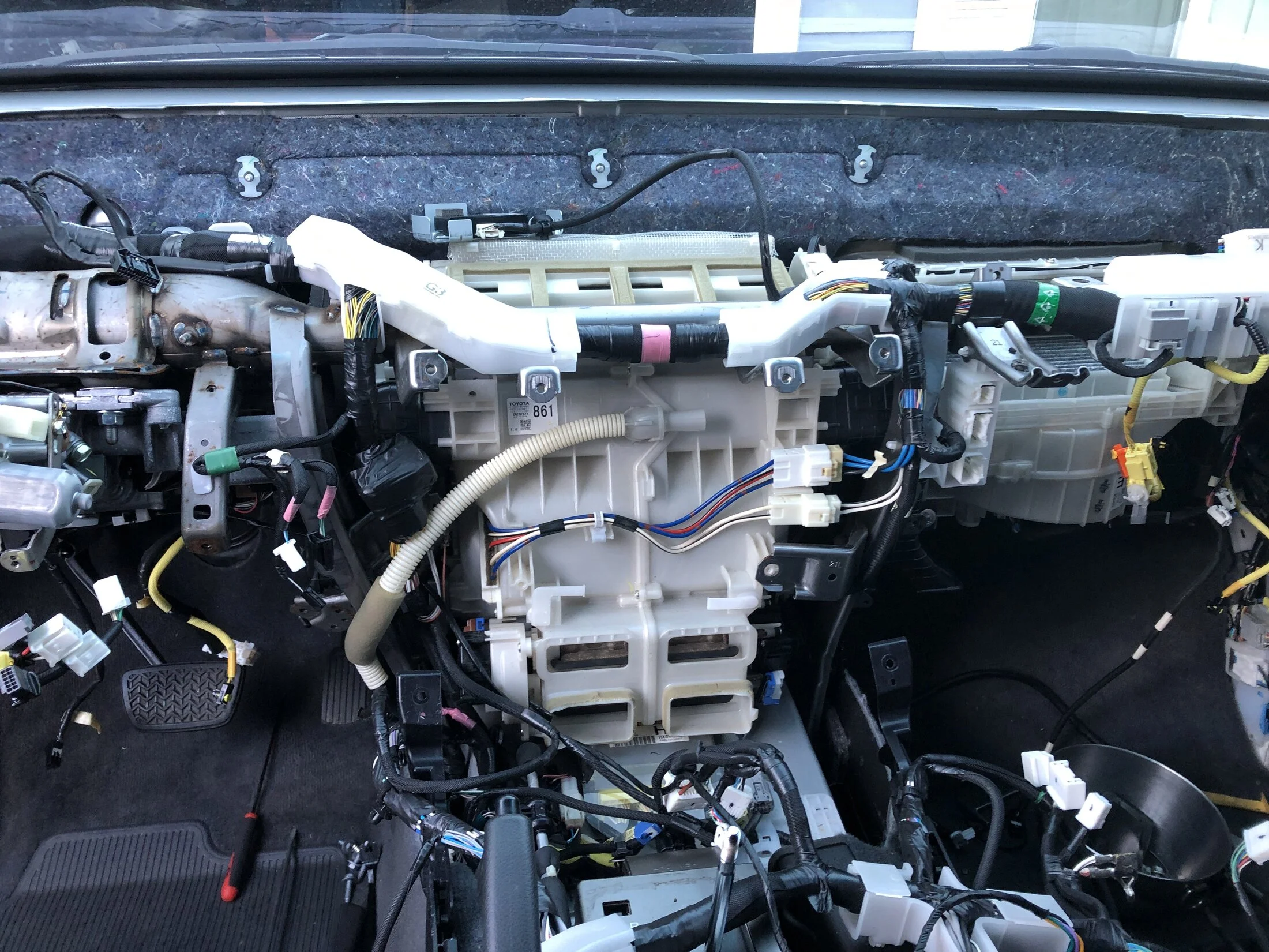

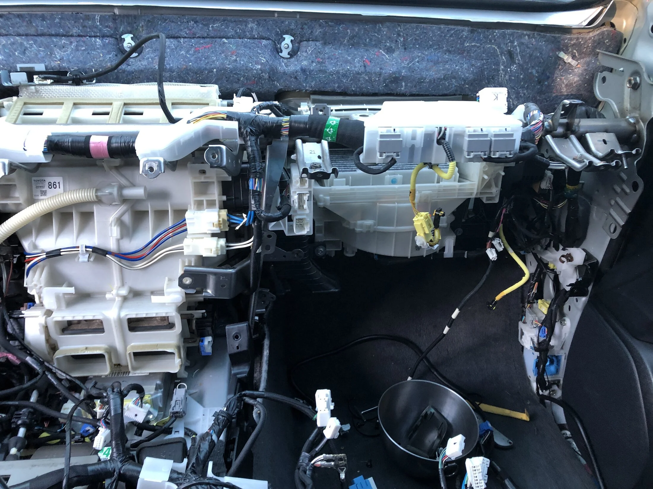

You need to remove the whole dashboard and the HVAC unit to get to it, it was f’ing PITA!!!
Install new Immobilizer ECU, this time I mounted under the glove box for easy access.

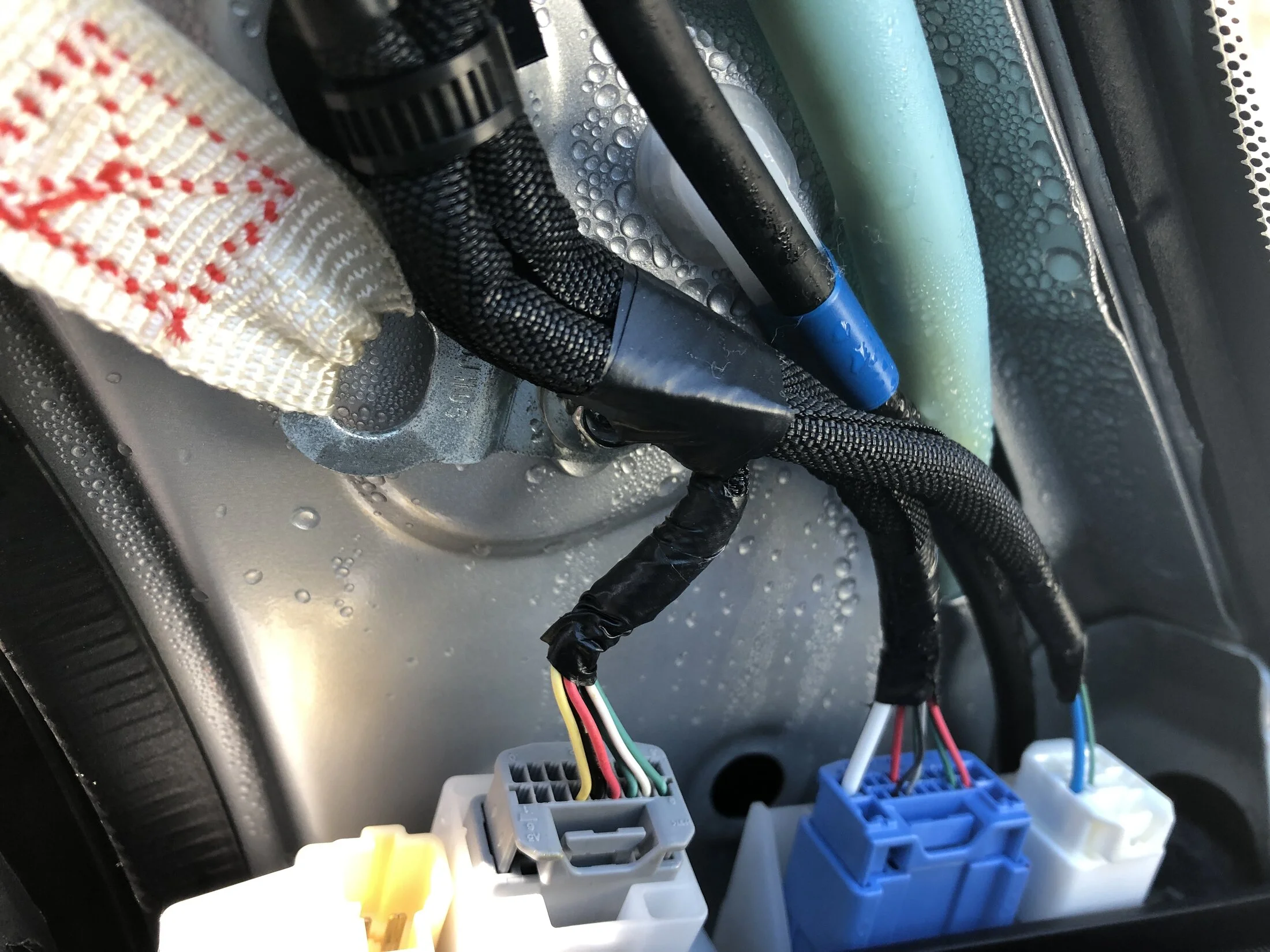

Put the new smart key ECU, immobilizer ECU , fuse block back together and cleaned all the wires connector on the driver and passenger foot well. Turn the key everything was on but no start, it still said key is not detected!!!!

They took the smart key ECU, the Immobilizer ECU and the Engine ECU out and reprogrammed it so they can talk to each other again. And it worked!!!
What the dealer missed was that if you replace one of the ECU you need to reprogram all three of them since each of them has Immobilizer in it!!!

Dash removal

It took me all day to remove the whole dashboard since I’ve never done it before.
The hard part is getting the Immobilizer ECU out. It is wedged behind the HVAC unit and firewall. I would suggest that you mounting it somewhere under the glove box, it has enough wire length to do so. Putting it back together only took me an hour. Tell your mechanic to clean every wire connector and ground wire under the dash and apply dielectric grease. Same goes with main wire connectors located on the driver and passenger side foot well.
