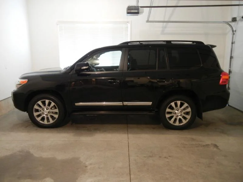

2013 Land Cruiser on 20" Platinum Wheels
I just put the 20" 'Sequoia wheels' on my new '13 LC and I believe it's a MUCH improved look for the LC. Mounted with 175/55/R20 Michelin LTX M/S2's which I've been told are rated for 70k miles. This is great setup IMHO.
20" LX570 wheels; 20" wheels should be an option when ordering/buying an LC like the ones sold in Europe LC 200's

Do you have any documentation, door jamb sticker pics, etc. to support the recommendation of the 111 V Dunlops?
Most of the tires available in 285/50R20 are rated at least 112 and up to 116.
It seems counterintuitive to me that Toyota would recommend a 111 rated tire for the LX570.
All I could glean from the Lexus site is that the LX570 has "285/50R20 M+S rated tires." Not very helpful.
:cheers:
I based the load index / speed rating on the OEM fitments for a 2013 LX 570 from Tire Rack. I looked at a few other sites and they list the same tires.
There is a pdf of specs available here but it does not provide detailed specs.
Edit: Found the spec in the owners manual available on the Lexus Owners site for a 2013 LX 570. The link to the section of the pdf is Here, scroll to page 10 or 28 (of the pdf ... or page 887 per the page numbers in the pdf) and the spec is "P285/50R20 111V".
For a 2013 LX 570, USA spec, that is an approved tire. I do not know if it is approved for any other spec of 200 series.
