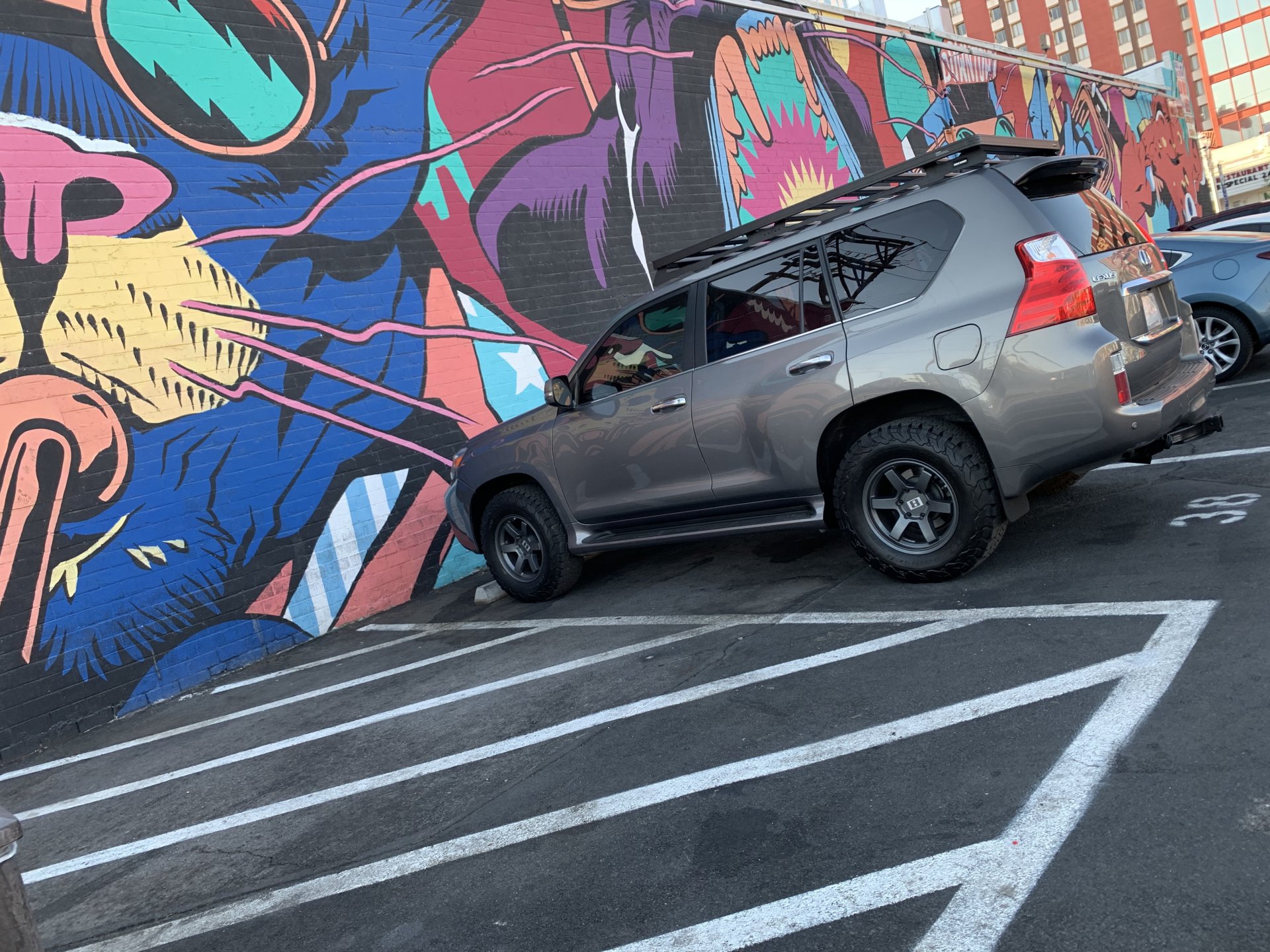

Finally getting around to a build post.
2010, bought with 135k and bone stock
so far suspension, roof rack, wheels and tires done, and winch and bumper (on the way.)
dobinsons MRA, 2.5ish inches @ 110-220 lbs in the front and 2.5 inches stock load variable rate rear coils. Definetly could’ve gone with softer coils all around, but I’m hoping the winch and bumper/skids will soften up the front enough and maybe a drawer or plate system will settle the rear. Ride is super rough right now because I had planned on my which bumper showing up a lot earlier, so I’ll give a better review of the MRA’s when I have the proper weight on the vehicle. Heard mixed reviews but mostly good ones, hoping she’s nice and buttery with weight.
Frontrunner slimline 2 roof rack is super solid, not too noisey with the stock wind deflector but I’ve heard better things if you cough up the 150 for the upgraded on front runner makes. But easy install, solid build.
running 17x8 level 8 mk6 wheels with 265/70r17 BFG ko2 ATs, they rubbed slight at stock height at full lock but with the lift installed no rubbing at all.
still waiting on a victory 4x4 winch bumper so I can throw on the LIGHTBAR and 10k winch, low profile blitz bumper.
couldn’t find a stock pic, but this is stock plus the wheels and tires I put on, and then current build before and after
