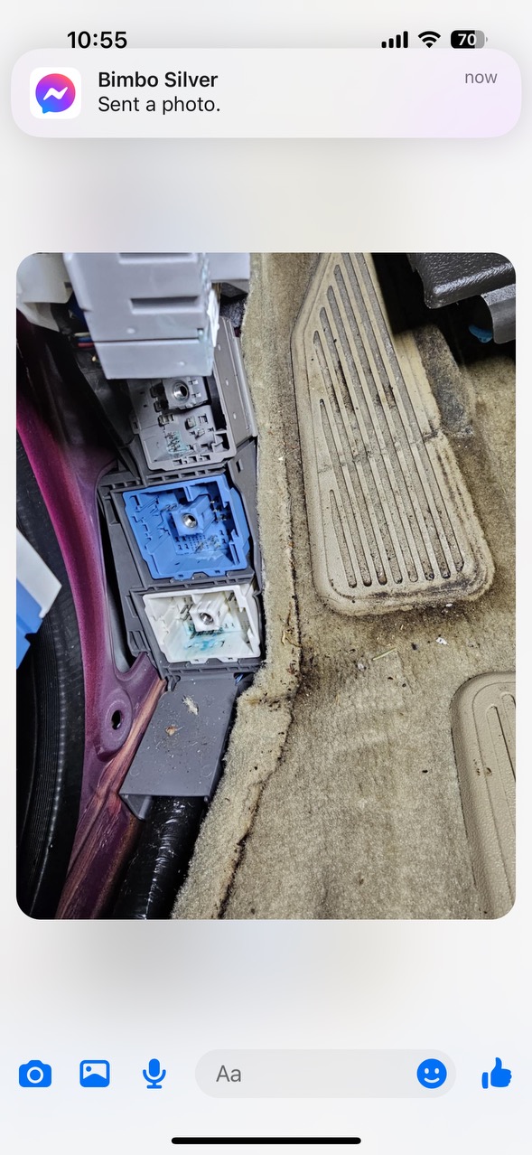

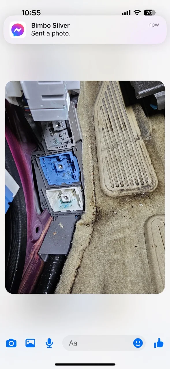

100%! My 2008 just had an mysterious issue with the fog lights coming on and draining the battery. The root cause was a clogged sunroof drain that diverted water down the driver's side A pillar into some of the electrical junction boxes. Note the blue corrosion in the pics below.

In some way or another most of the electrical functions of the vehicle run through those connectors. There are just too many wires to be able to say which one is impacted.
But yes even without dampness in the area it would be wise to open the connectors to verify condition. Might as well have some cleaning supplies on hand when you do that just in case.
