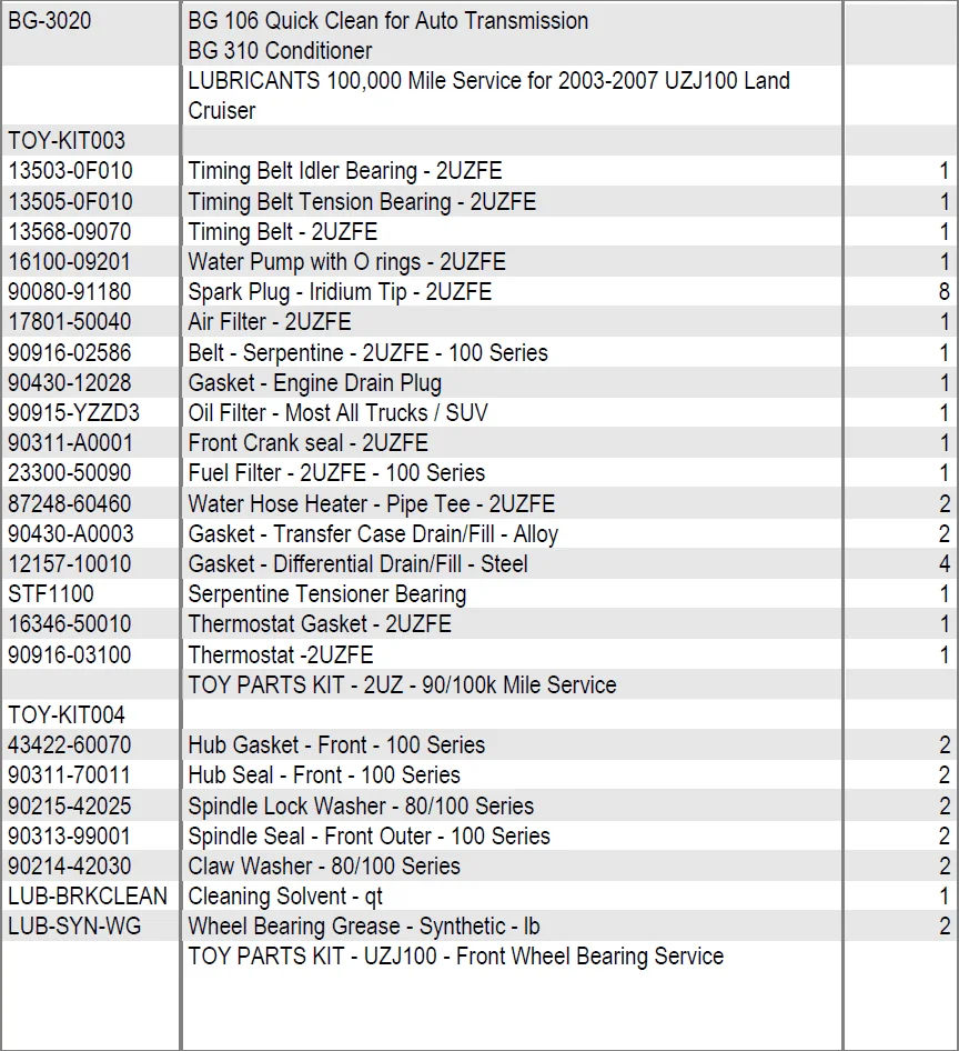

Here is everything Slee does in the 100 series 200k service, may be a good place to start, although it looks like you have most of it already covered.
Hey thanks a lot for this! Again, just thinking down the road and being able to drop my truck and walk 3 blocks to my office sure is nice.
