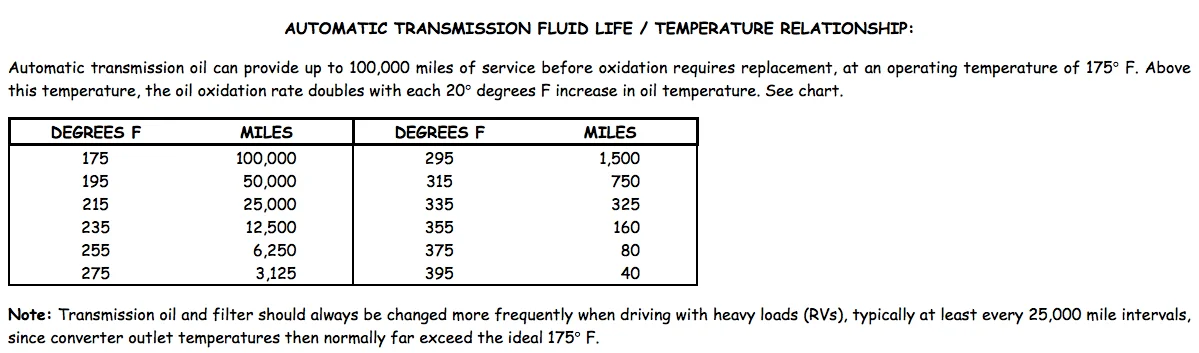

As Spike suggested HEAT is the key to short or long fluid life. The higher the sustained HEAT the faster the fluid breaks down and sooner it needs to be replaced. The other issue is cumulative heat cycles- with each high heat duty cycle the fluid life gets exponentially shorter. So where one truck could possibly go 100-150-200k+ miles on the same fluid under a light duty cycle (local/short trips, no towing, light loads that never gets the fluid above 150f), there are others that tow, or operate heavily loaded and in hot climates, mountain/dessert driving etc (severe duty cycle) where higher sustained temps are normal, they should change fluid sooner (like at 30k intervals).
This chart illustrates how fluid life diminishes with heat. Source: Transmission Oil
