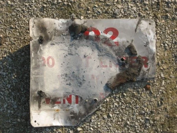

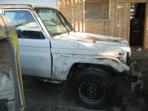

Friday - moving trucks about the yard, getting the crate off the bed of the 79, pulling misc parts from the cab, put new battery in, cut frozen parking brake line, and then test driving the truck
NIce pics mate
that sure has had a flogging
you will have to start a 5 stud rim collections now, top project
nice troopy your yard looks like a toyota car yard ,which is minting

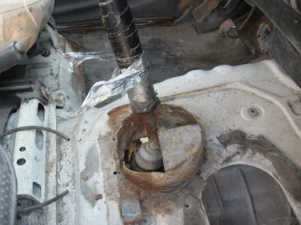

couple other things from day 1 that I thought were interesting
in addition to blocking 5th gear
they put the truck in 4 low and then disconnect / remove the transfer case shifter
you saw the closeup of the 5th gear block - this is what they covered the empty hole in the tunnel with
yep, the drivers did not show much consideration to the sheet metal.
2 rag top 70s
1 hard top 70 (bush pig heading to Kingston Ont)
one 75 series truck
1 75 series troopie (heading to a customer in Ft Mac Alberta)
1 79 series pickup (heading to Sanich BC)
i like my 70s.
and a bunch of other RHD vehicles...

Wow, what a hack job they did on that lockout - lol. I've seen some bad mine trucks - that one is up there. The lockout on mine was a small metal spacer that was placed in the transmission.
