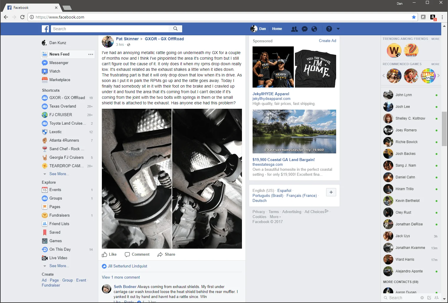

hmm, that is a new one. It seems to happen when the truck is disturbed (small bumps). Do you hear it on smooth roads? Almost sounds like the front drive shaft or a heat shield is tapping something.
Coming from almost the exact same spot....worth checking.
Yes, it can be heard on smooth roads. Doesn’t seem to be the result of any bumps and only happens once it gets to 30-55 mph. I’ll def check out the exhaust in the same location as the one you posted. Thanks again for taking the time to find it.
