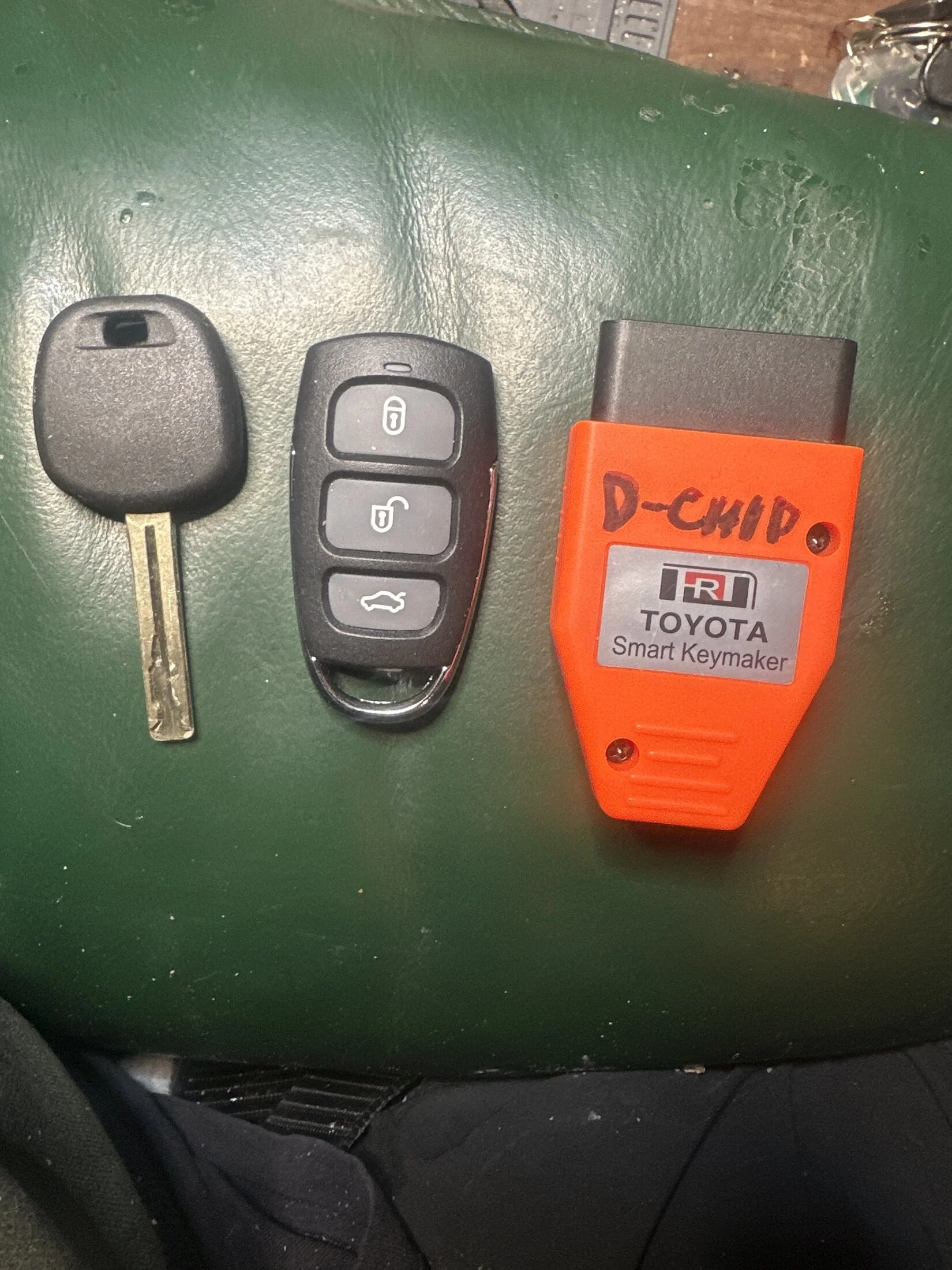

Hey Guys- Finally solved my VALET key only issue with my 2003 UZJ100 Landcruiser

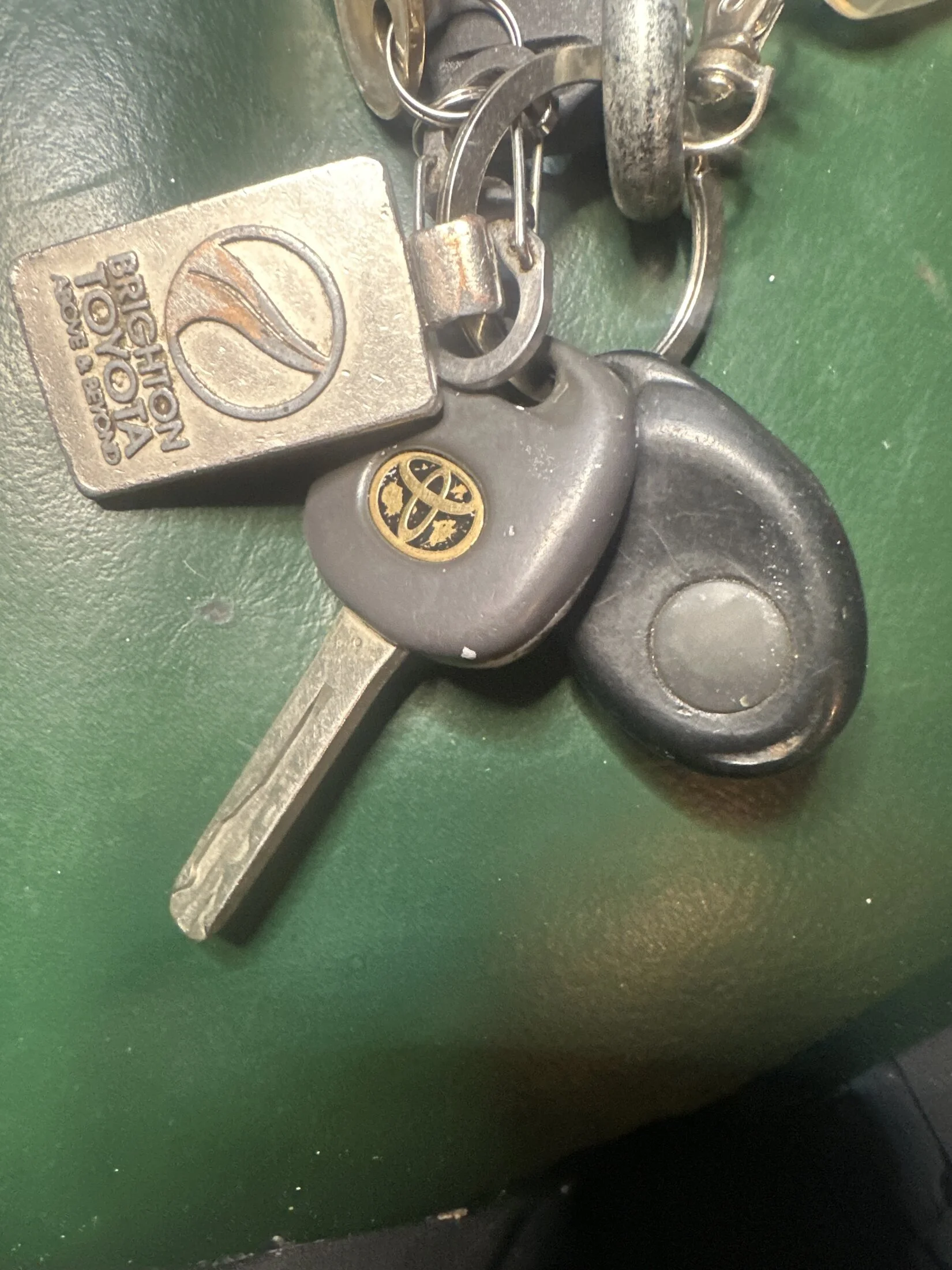

Had lost master keys and only had grey valet key . Which wouldn’t allow me to put car into programming mode for key or remote
NB This applies to 2003 onward with the 4D68 transponder chip
Spoke w locksmiths who quoted $500 to $1000 and was told they may only be able to duplicate another valet ( really wanted master so I could do programming myself )
Considered removing and virginising IC900 immobiliser chip but wasn’t confident

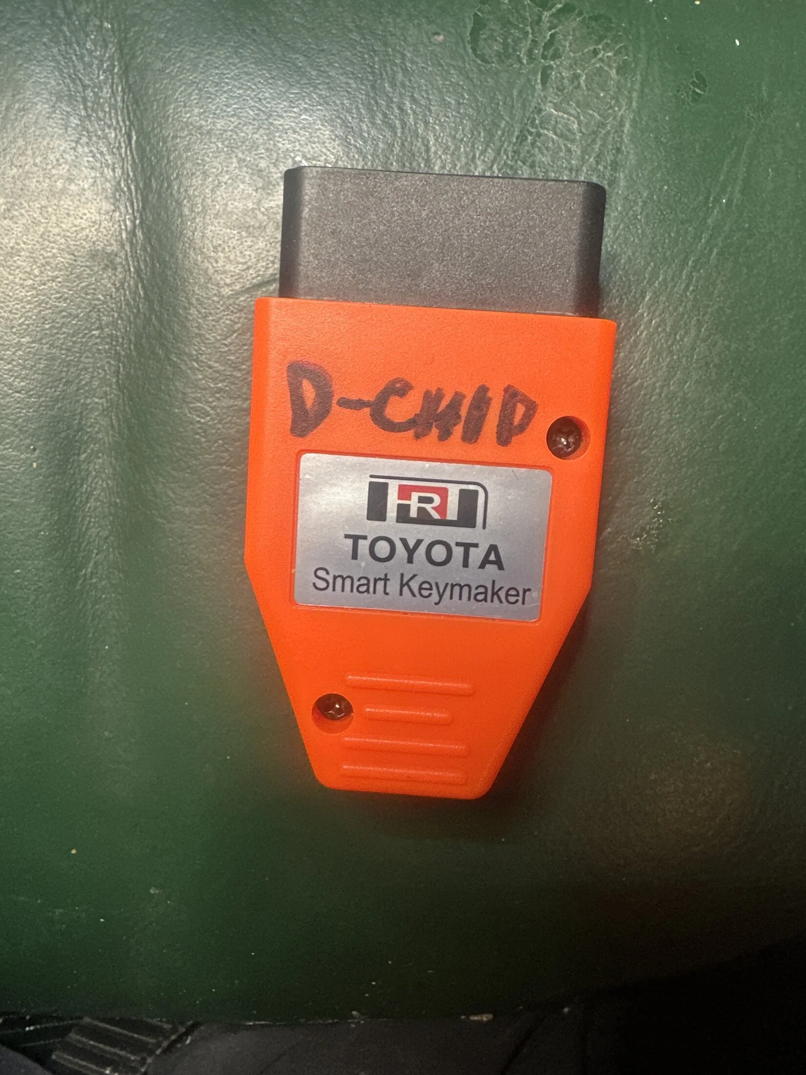

Decided to give this $28 OBD key programmer off ebay a try
Got two TOY48 keys cut w blank 4D68 chips from my valet key
Followed instructions and 5 minutes later successfully had two brand new fully functional master keys
NB - If all keys lost , keys can be cut from key code on side of passenger door lock cylinder
Posting just in case anyone else faces same issue
Cheers
