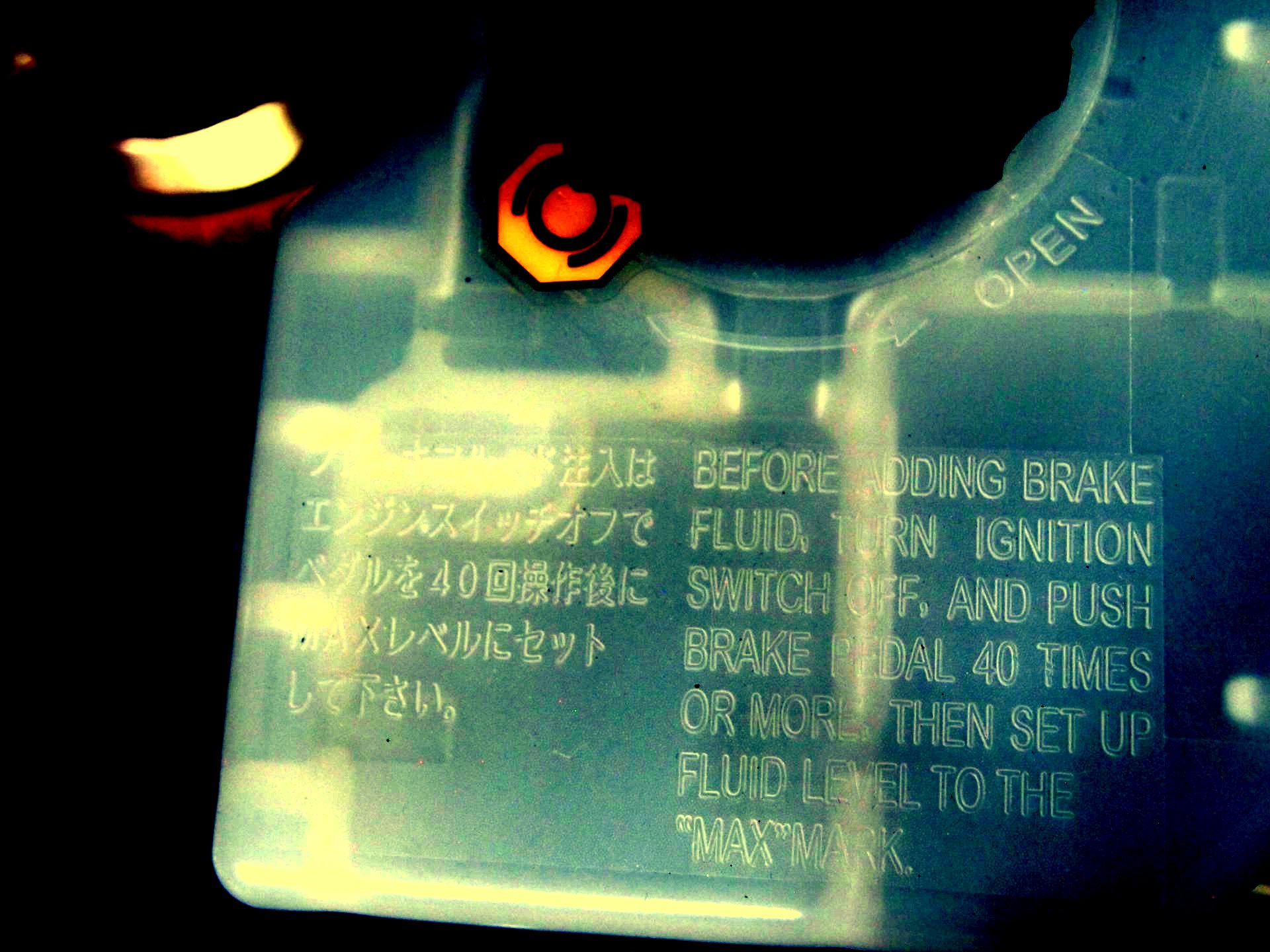

Ok note that the brake fluid level should be set properly to max line AFTER pumping brake pedal 40 times with engine off as stated on reservoir cap. Pumping the pedal with vehicle OFF actually raises the fluid level in reservoir.

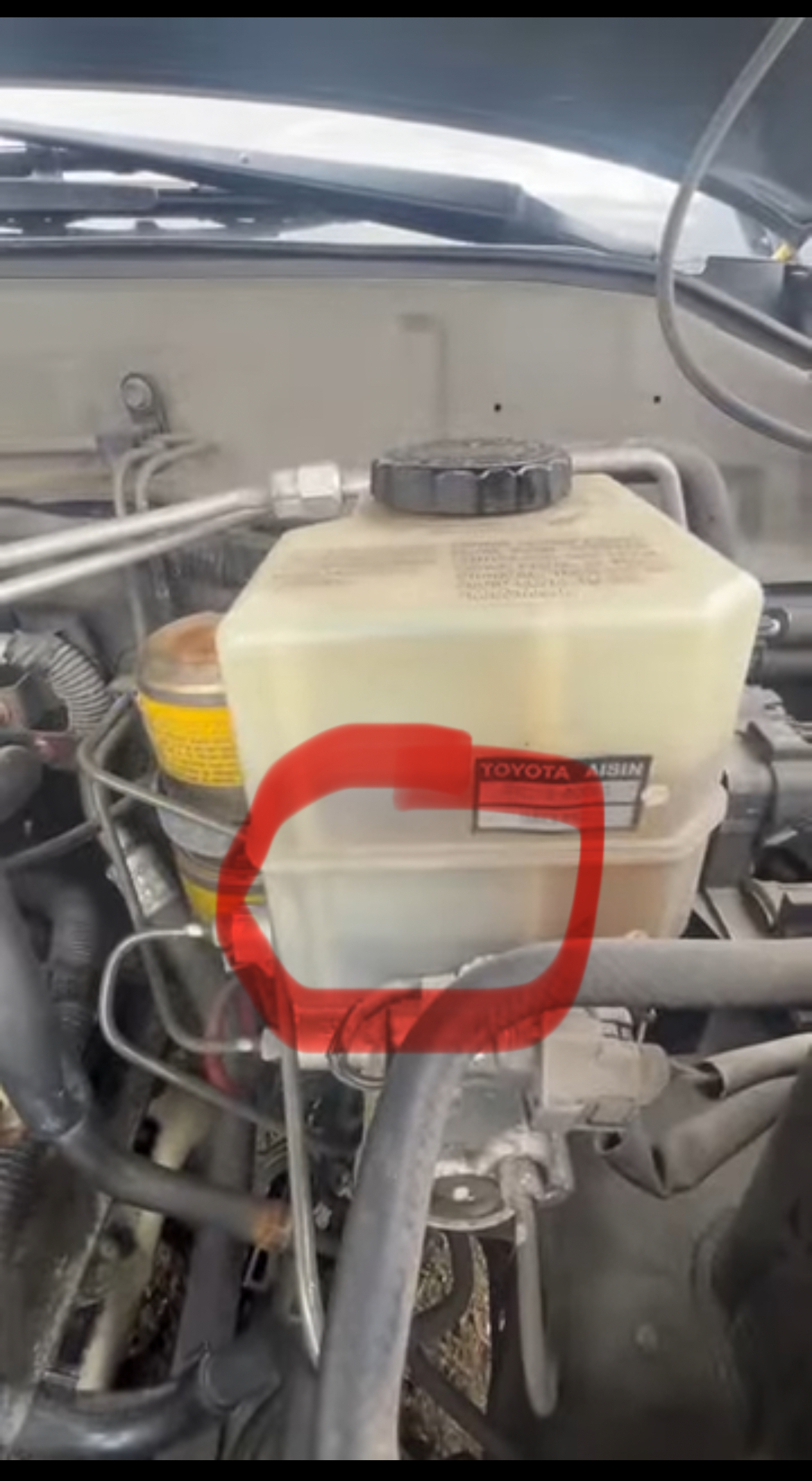

The area in pic I’ve circled looks like brake fluid is missing and this area should be full of fluid in the video. If that is correct may be indication of what the issue is.

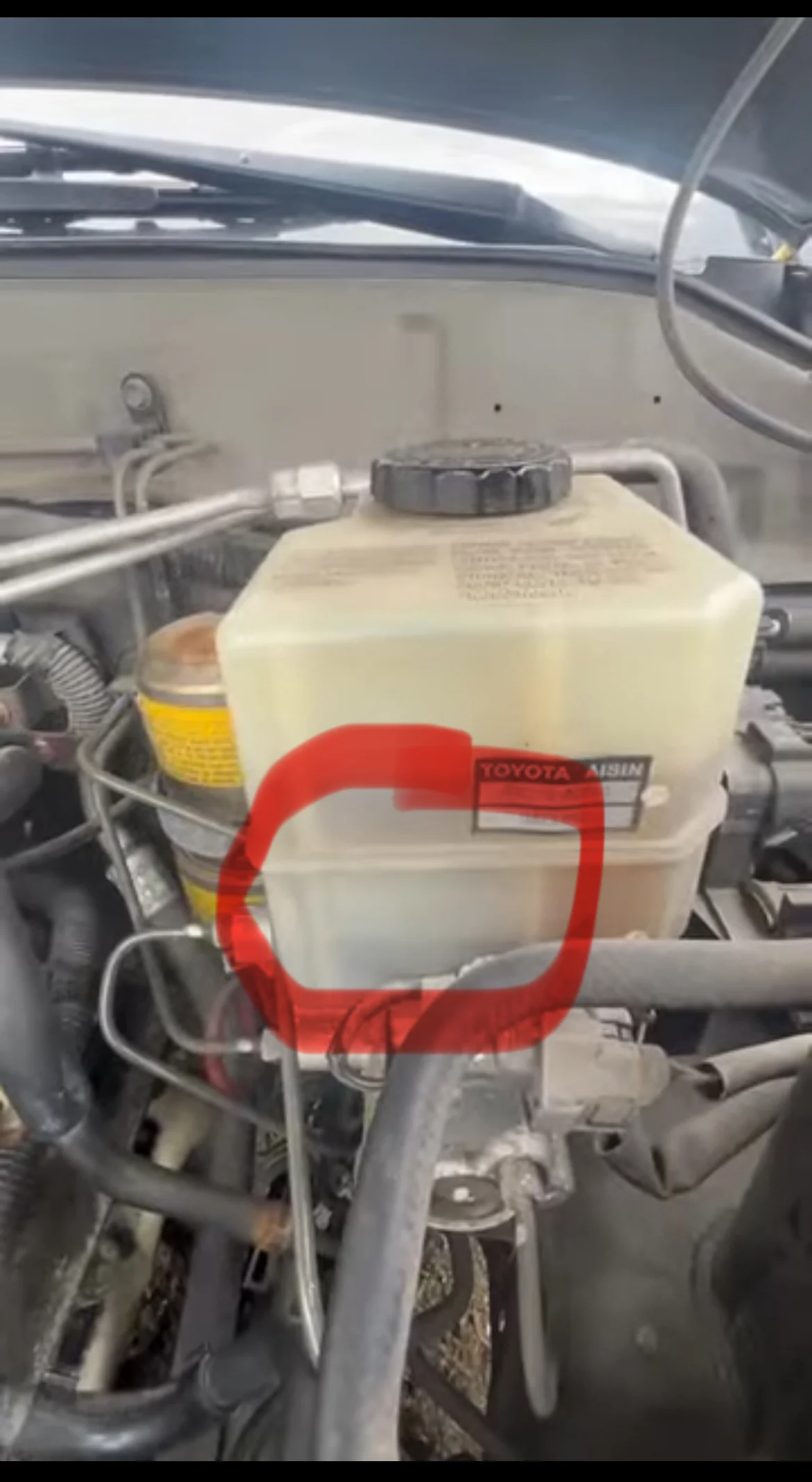

The area in pic I’ve circled looks like brake fluid is missing and this area should be full of fluid in the video. If that is correct may be indication of what the issue is. View attachment 3884195
During filming the video, the fluid is right at the level of the toyota/aisen label. Additionally, the fluid was literally to the top when I had previously pumped and then let the system prime (still with indefinite pump running). I actually thought the level being too high was the issue.

You could then try, flushing and bleeding system "properly". This includes setting level properly in reservoir in the manor embossed on it.

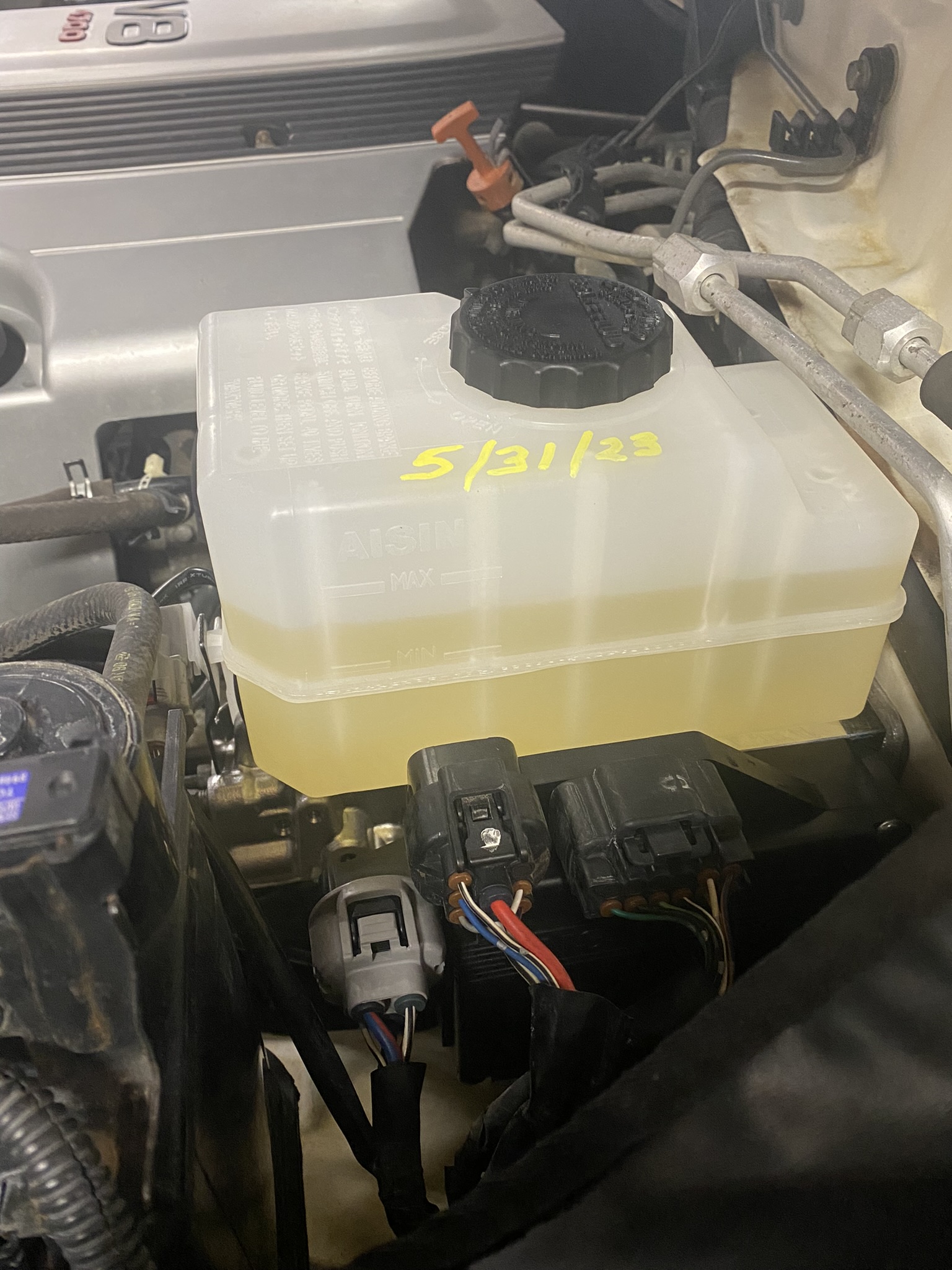

Accumulator. Empties, as we pump pedal 40 times, IG key OFF. Then fills (pressurize) once IG key ON and booster motor runs pumping fluid into it. The fluid level in reservoir, changes by about half the distance between min. & max. lines. Much more, could mean a failed accumulator.
