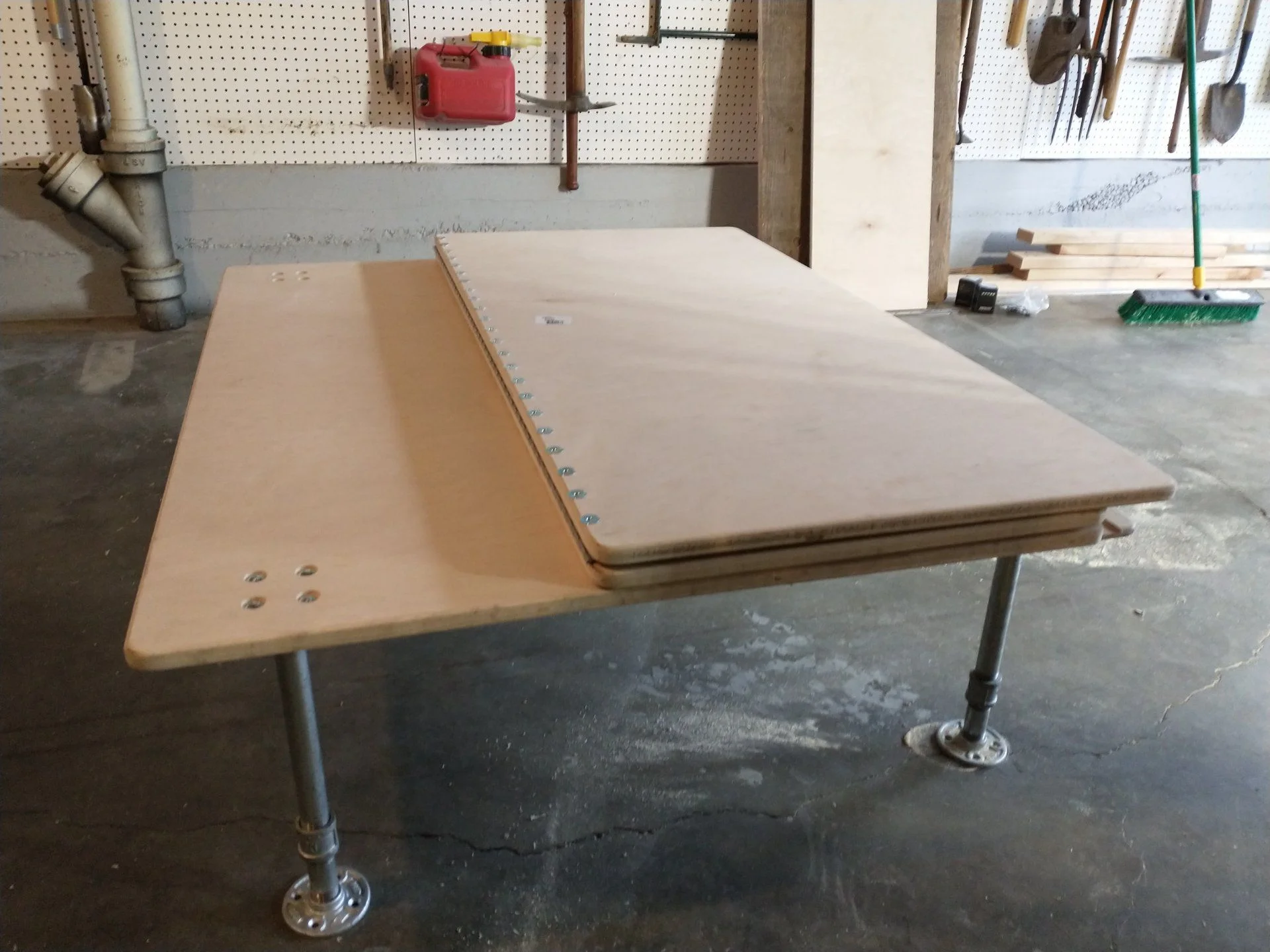

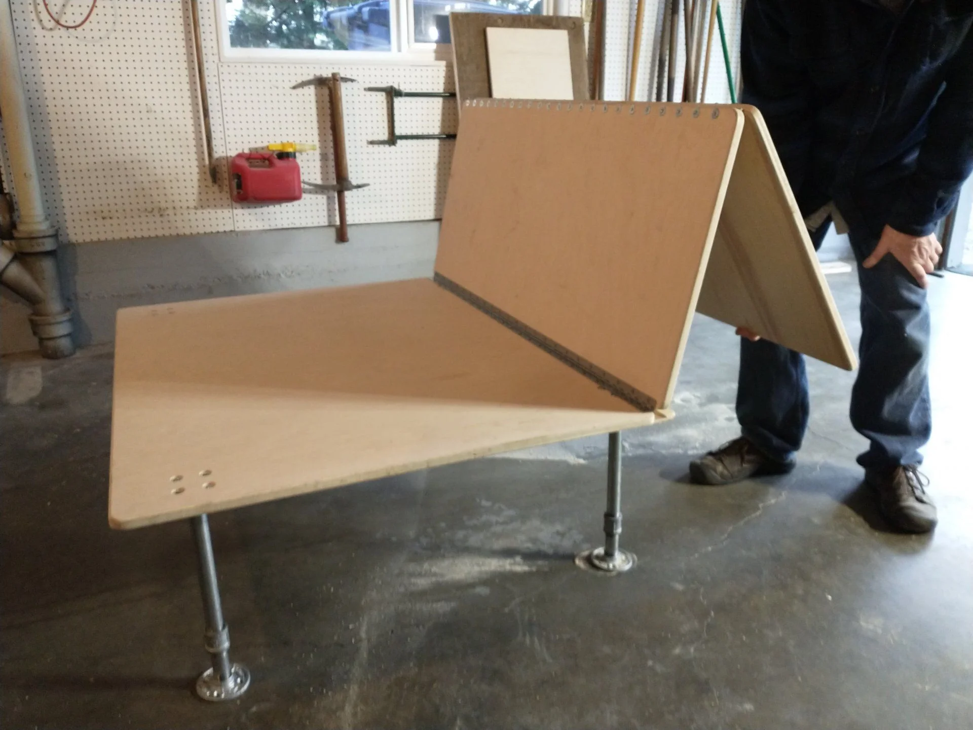

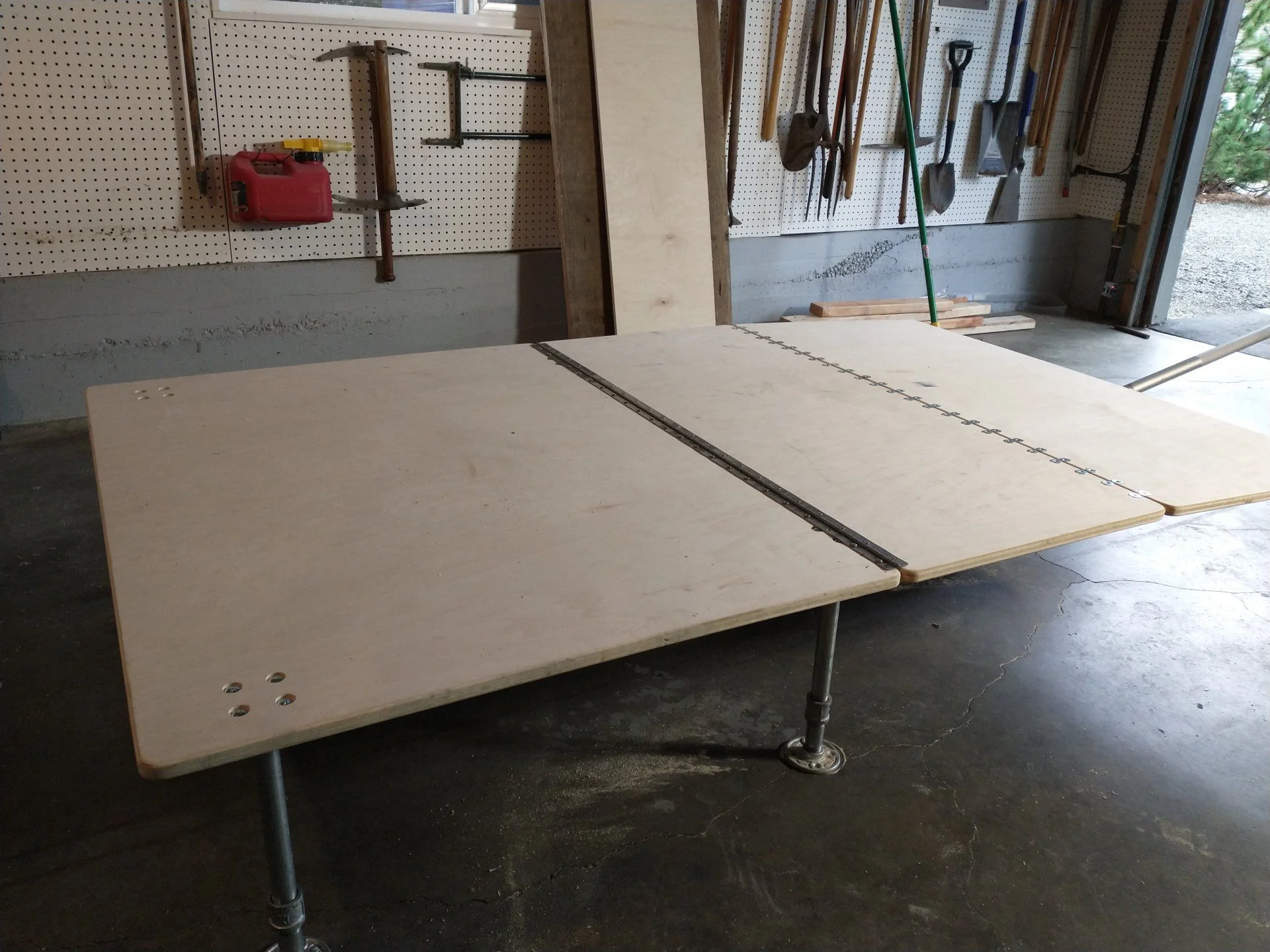

This is 100% a work in progress, but I spent a few hours over the weekend knocking together a sleeping platform that fits in the back of my 2013 LC. I'm sure that many/most things about it will be changed/revised over the coming months as I start using it, but it seems like a decent starting point.
Purpose - Create an inexpensive folding sleeping platform that is easy to modify in the future, that allows for use of the middle row seats, while being easily removable.
Planned improvements include covering the exposed hardware when unfolded to prevent damage to mattress, black paint/carpet to blend into the interior and reduce rattling noise, integrated tie-down points for either turnbuckles or cargo straps (currently have ratchet straps looped around and over it), attach a bottle opener (most important), and additional pieces to cover the sides in the cargo area.
I'd love feedback, especially constructive criticism, if you've built/used something similar.

Do when mean when not being slept on? The first picture shows it folded up, and the middle row seats just flip back up and are usable as normal. When not in "use" it just acts as a shelf in the back cargo area, and once painted/carpeted it will also conveniently act as a discrete cover for anything left inside the car.

This initial version was built from a 4'x8' sheet of 3/4" plywood, you can get it from any big box hardware store. I haven't weighed it, but I used the majority of the sheet. The full 4' width fits through the tailgate opening, so I just left the width as is. Used a handheld router to clean up the edges.
The three sections are roughly 38", 21" and 24", in order, back to front, when unfolded. The outside edges of the headliner would only clear 22", so I suppose that would be the height? Several inches more in the center. This measurement is essentially dictated by the height of the legs, as shorter legs would allow greater clearance above, but less storage space below.
Height is currently variable, and I'll dial it in over time with use. Pre-threaded steel pipe sections that can be found in the plumbing section. I think it's currently 13" of vertical space under the platform.
Hardware was pretty much just what I had laying around, with the exception of the stainless steel piano hinges, and a box of t-slot nuts and bolts.
This wasn't a particularly scientific endeavor, and these are just the measurements I recall, take them with a grain of salt.
Let me know if any other questions.

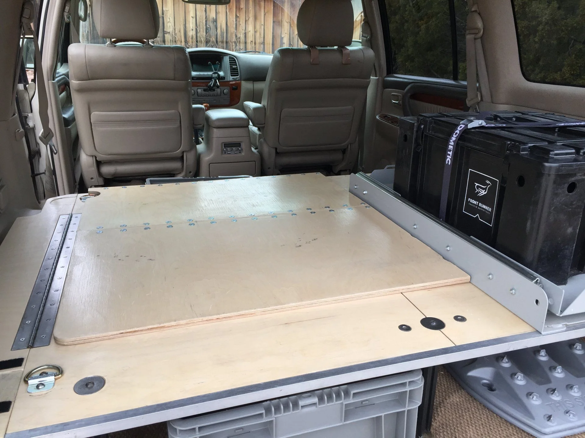

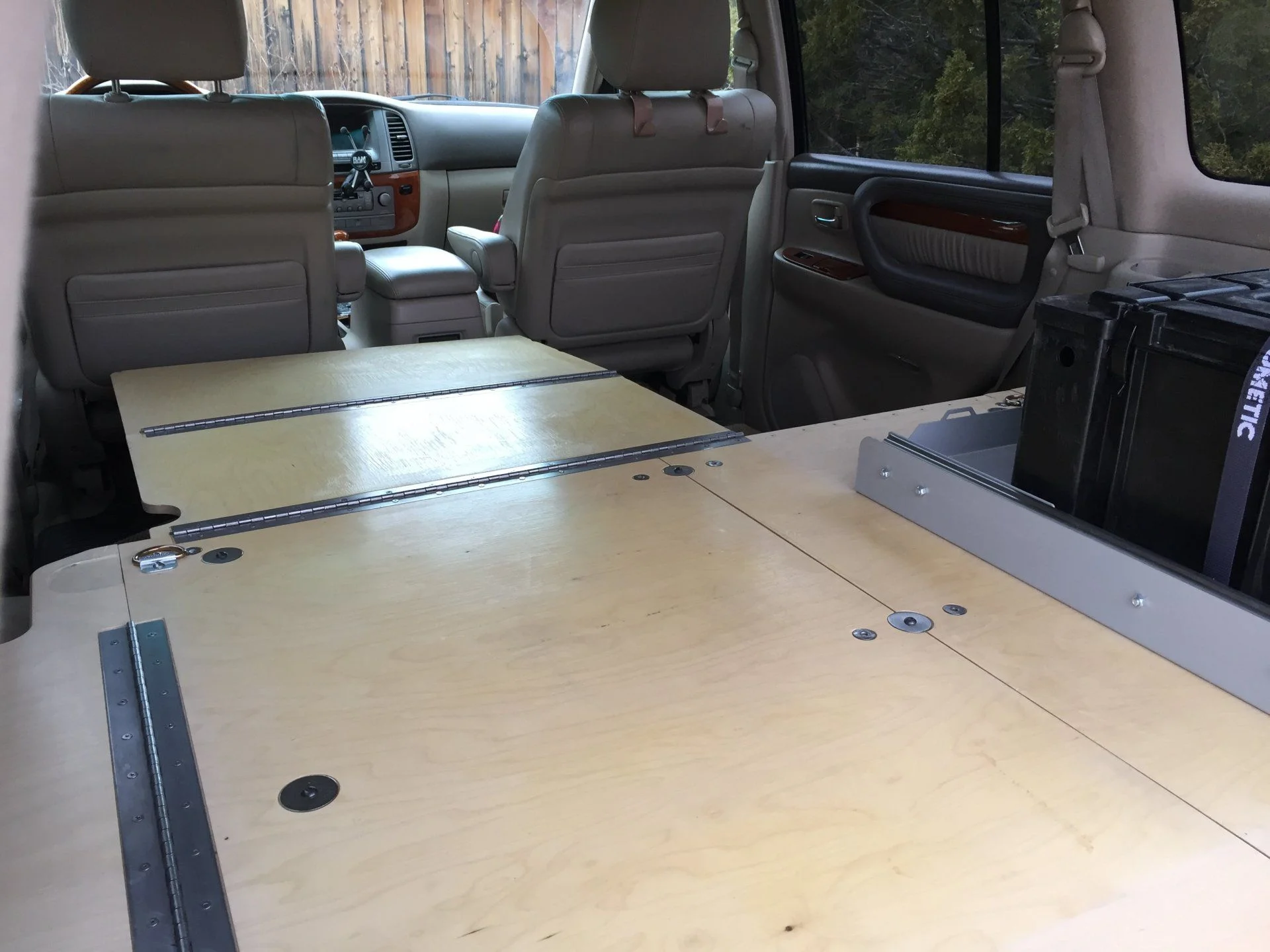

Here is the modification I made to my platform so I could use one of the rear seats (removed in this photo) or have more storage room. It is sized just right to fit around my cooler slide. This happens to be in my 100, but the idea is the same. The piano hinges were easy to cut with a hacksaw.
The platform is from Air Down Gear Up and I am very happy with it. I shortened the legs to give me more headroom. The Front Runner box currently in the slide fits perfectly under the extension to support it.
