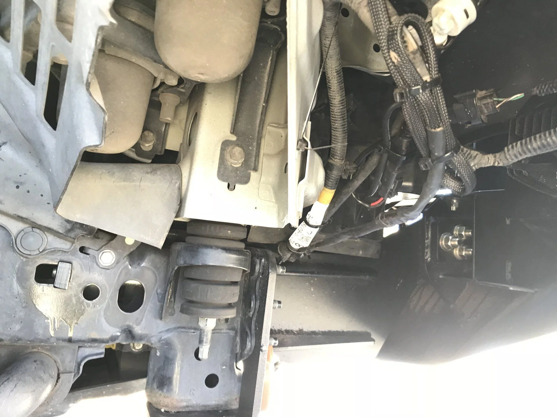

When cutting the bumper, had a few learnings. Please remember this applies mainly to 08-11 cruisers.
1) Flip the stock bumper over and remove all parts minus the headlight washers. Youll want to keep those attached, else there will be two gaping holes.
2) Although there are cutouts in the new bumper for the two round parking sensors, the parking sensor housing breaks easily trying to remove and are body colored. Will probably try to see if Toyota parts dept sells black ones.
3) I had to pull quite a bit of the wiring off the old bumper and will need to figure out how to mount it all with the new bumper to run the fog lights and the parking sensors again. That’s for another day, so zip tied up the wires that came with the new lights and set aside all the old fog light and sensor wiring for later.
4) The new fog lights were easy to install / intuitive. The bar light required a little more brain power and contortionist hands to tighten properly.
5) When cutting the bumper, I measured 7” down from the two corners and tried to make it as straight as possible using painters tape, a ruler and a sharpie.
6) It was still too big, so measured 3.5 inches down from corner and realized that would fit. There’s a natural crease in the top part of the front bumper. I put some painters tape down and measured 2.5 inches down from the crease, marked w a dot, then shifted right, measured 2.5 inches down from the crease, marked, repeat until the other side. Other side 3.5 inches down from the corner. Then, connected all the dots with the ruler and cut.
I was concerned since the bumper was made for 2013-2015 front bumpers, there’d be a fit issue. However, that wasn’t an issue after all. Looking up from below helps illustrate this.
Overall, am pleasantly surprised at how well the cut turned out. I did mean to do a test fit and then remove it to add the weather stripping before final install, but the cut is so recessed into the bumper that it is resting on the inside metal of the bumper and I fear the additional height of that weather stripping will push the bumper up too high. So, decided against the weather stripping.

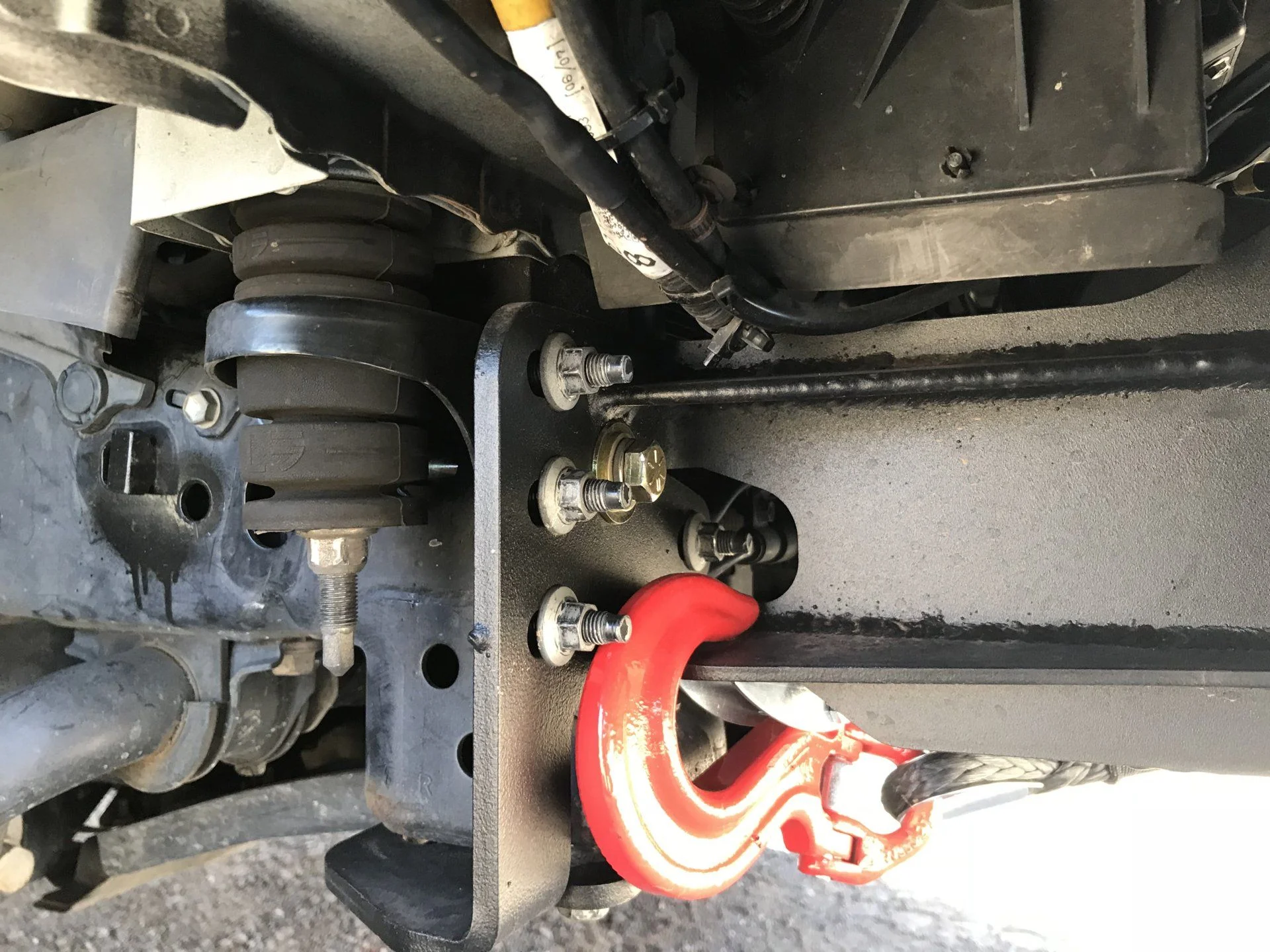

Also worth mentioning is the grill slides into the bumper easily and the back of the bumper is screwed into the inside fender wall, so be sure you have retained those screws.

Heard from the production lead at MT4x4. Turns out I got a prototype bolt bag. Their more current bolt bag has bigger washers for the long bolt. And, given the write-up, they’ll now include the larger washers also for the tow hook bolts. Super nice guys at MT4x4, btw.
