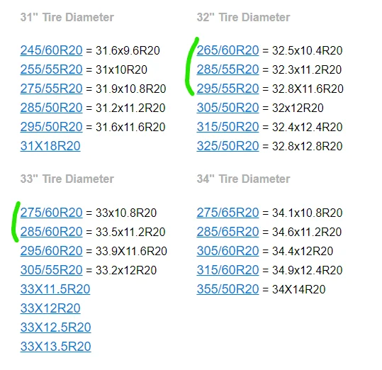

20 inch wheels
I'd aim for one of the green marked sizes:
