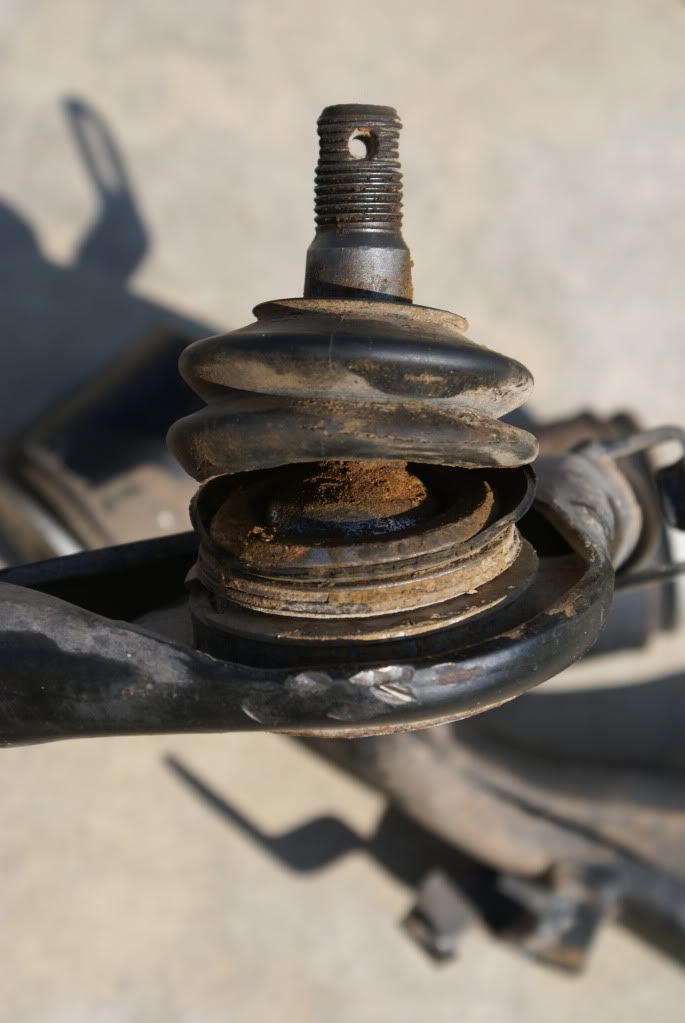

I'm running TC UCAs which utilize poly bushings and a uniball. Poly bushings are certainly harder than OEM but still deflect at bind, and are used to stiffen and improve handling (random deflection from rubber bushings may provide a more comfortable ride, but no deflection in that sense is good for handling). Uniball does allow for more angle/articulation (no clue if meaningful), but also requires replacement at 2x cost of ball joint (if the ball joint is even replaceable). Also have to replace the poly bushings but not sure how often, and grease them via zerk fittings from time to time. Other option are heim joints which also still deflect, but from what I understand take even more maintenance than the polys. What components would take more abuse from having firmer bushings? And how much more abuse are we talking?
I know when I'm at speed in the desert or on forest roads I'm thankful knowing the UCAs are strong, not like these OEMs... Which... You cant repair and have to replace when they get like the pic below anyway. Plenty of reports of shredded bushings and broken UCAs on the trail, just depends on how you use the truck I guess (though I've seen these same reports with the SPC UCAs that use OEM style bushings and ball joints).
