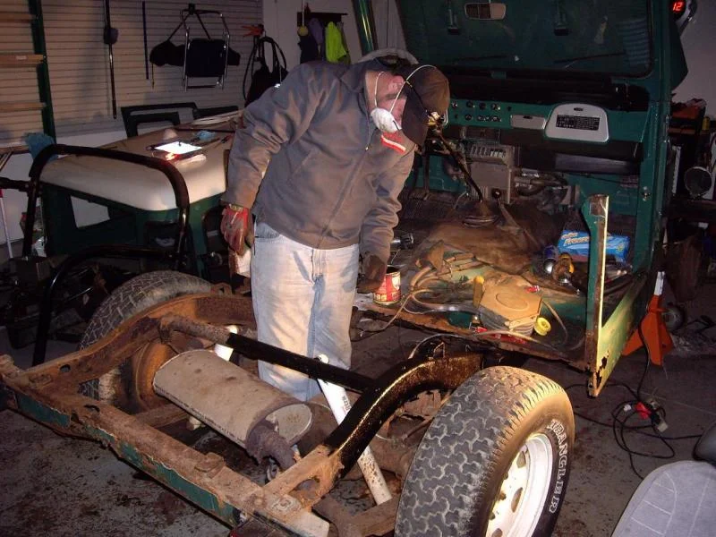

Ok, got fenders and fender skirts off to expose the frame so we can wheel it and POR-15 it easier. I only really broke 2 bolts on the fenders, the passenger side top ones, I guess a tap and die set will be in my future after all. I did happen to screw one thing up during all this, I was taking the bib off and my knuckle slipped and hit the radiator resulting in a hole and subsequent leak of the radiator, so a new one is in my future I guess. Other than that it was pretty straightforward and I am looking forward to doing the rest. Does anyone happen to know what people are using to fill in on the body between the spot welds? I am guessing just body filler, but I may be wrong. Fill me in if ya have a clue, or what you have done.....
I had better success with a flap wheel on the frame to get a nice clean surface to paint. If you are POR15'ing it though a wire wheel can leave a bit of rust which POR15 will like more than a perfectly flat, rust free surface.

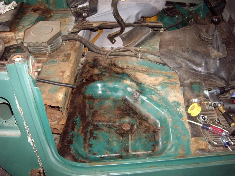

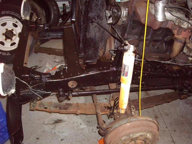

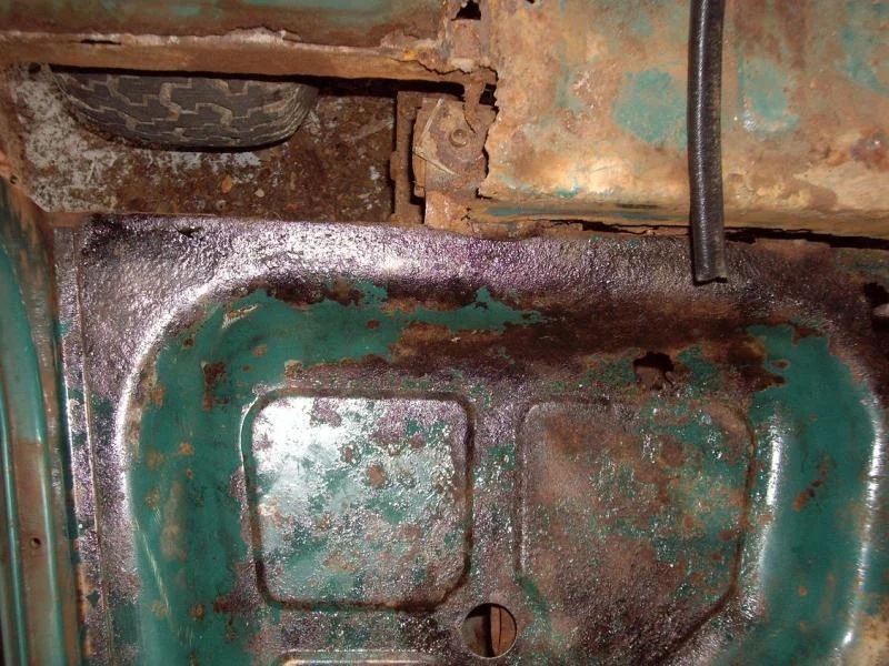

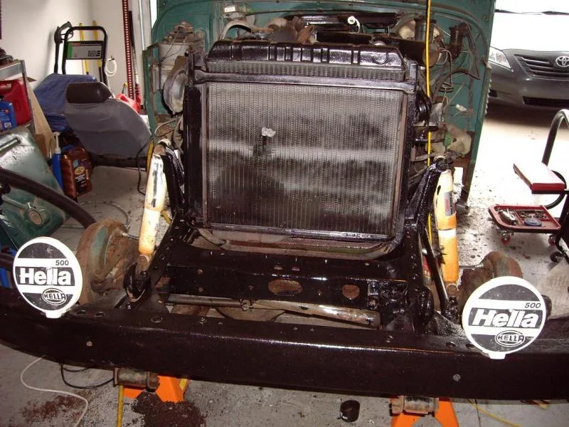

So turkeypen came over last night and we had some fun rust wheeling the front of the 40 and applying POR-15. We got quite a bit acomplished, and it motivated me a bit, so I went on and applied some more today to the DS frame portion until my foam brushes were junked. I also removed the PS seat and fuel tank cause I am itching to remove this tub and get the new one on. When I got into the PS floorpan there was some surface rust that I hit with a wire wheel and some permatex rust encapsulator. It was not attached to the tub anymore, and there are some areas that are pretty eaten up. My question is, if I cut about 2" off of the floorpan and weld in some 16g steel ya think it'd be ok? what we welded in on the DS side is still holding, and actually besides the spot weld on the tub is the only thing holding the tub together. Anyone else have any other ideas other than buying new floor pans?

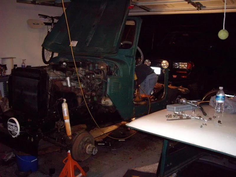

More pics.... i'll be taking more as we are removing the tub tonight!!!! PROGRESS!!!!
Ok, so various sanding and priming of things, figuring out how to fix pin holes left by the sand blasting etc... I did cut the DS rocker panel off up to the floor pan today, I will probbably get some 14g angle steel to brace the back side of the new rocker panel skins, also I will probbably use the same 90 on the floor pan angled down to tack the new tub on to the floor pan. If anyone has any other ideas I would be more than open to them..... Hopefully I can get the fenders smoothed over this week, frame welded into place and be rolling w/o worrying about the spring hangar breaking up thru the frame!!! It is coming along....Pics to come soon....
