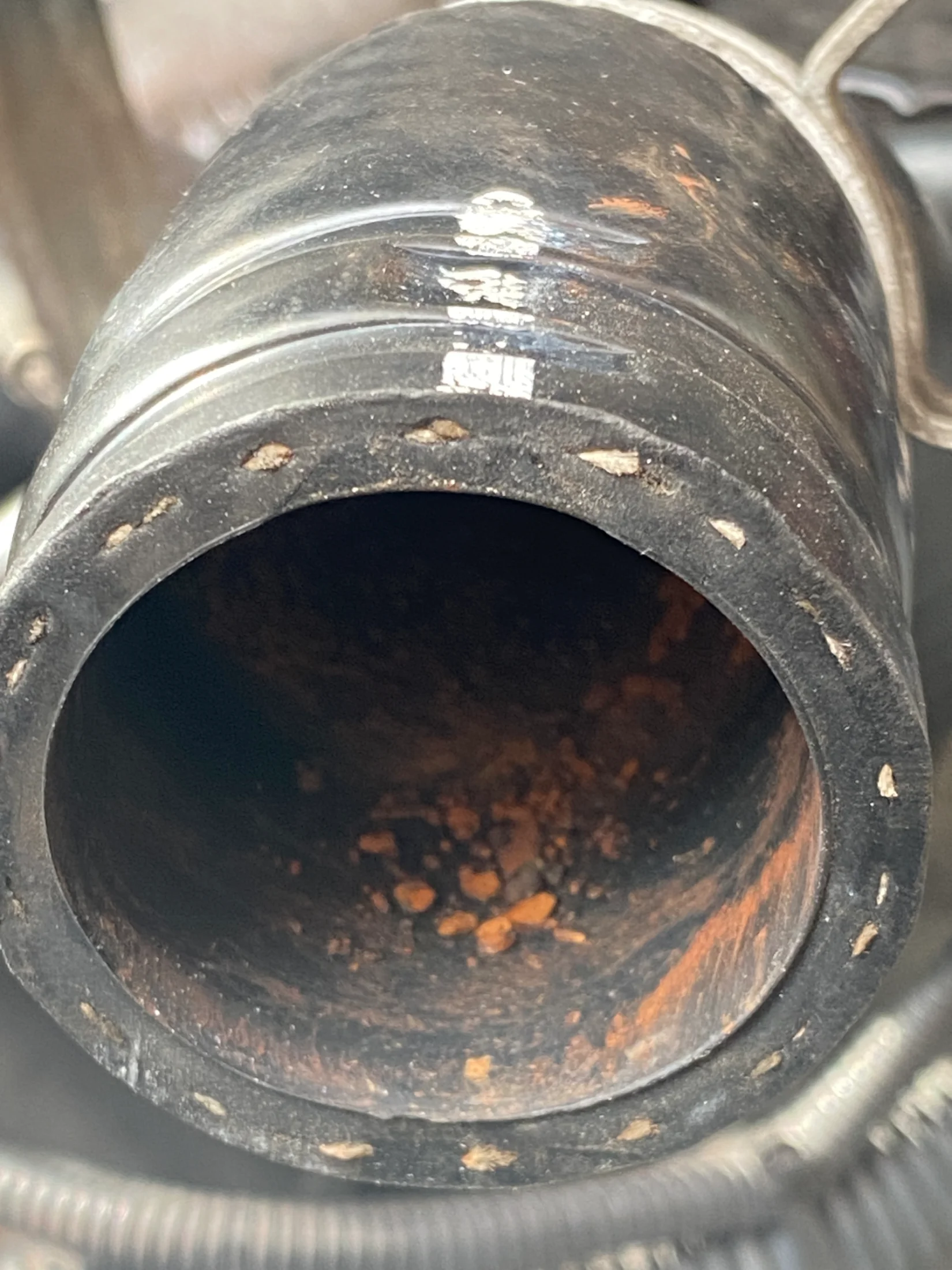

Lot of crusty/rusty debris in the top radiator hose.
Got my rad off. Having it flow tested next week. Probably gonna order a water pump cuz I’m betting the pump is bad. If not I’m gonna replace it when I do the head gasket.
