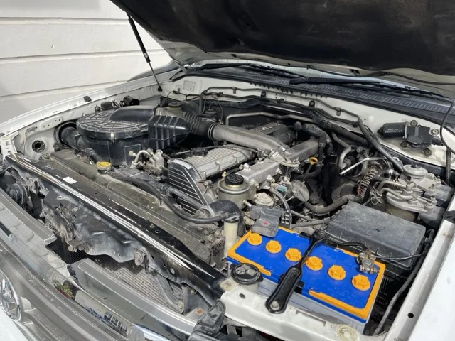

No coolant isn't burning, glow plugs are brand new and genuine Denso, but I don't know the age of injectors and have no knowledge when those were replaced or serviced ever since I bought the car. The engine is in tip-top shape. I don't think it has ACSD. Here is the picture of injection pump. One thing I noticed is that the injection pump makes a ticking sound between 70 kph and 80 kph, but once I go above 80 kph the sound disappears. I am not sure if that is the sound from injection pump or injectors.

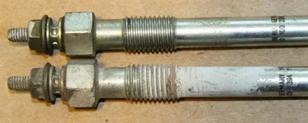

Speaking of bus bar, I will check if the glow plugs are getting electricity. Older glow plugs had a little bit of white oxidation type particles built up on it. Not sure, it was due to water intrusion or something else. Because I do wash the engine whenever I wash the car.
This type of white residue on glow plug. Picture is for reference and not my own. I read on the other forum and someone wrote that this is oxidation, which is normal.

Normal if the engine is cold.

old injectors can sometimes make funny sounds at certain speeds, I doubt its the pump. too much of a closeup to see if it has ASCD. check if your getting power to the bus bar.

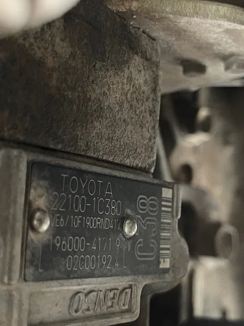

This is the part number for the injection pump that is installed in my car. 221001C380

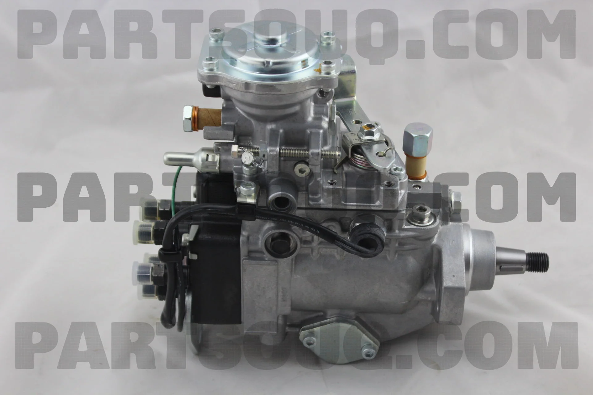

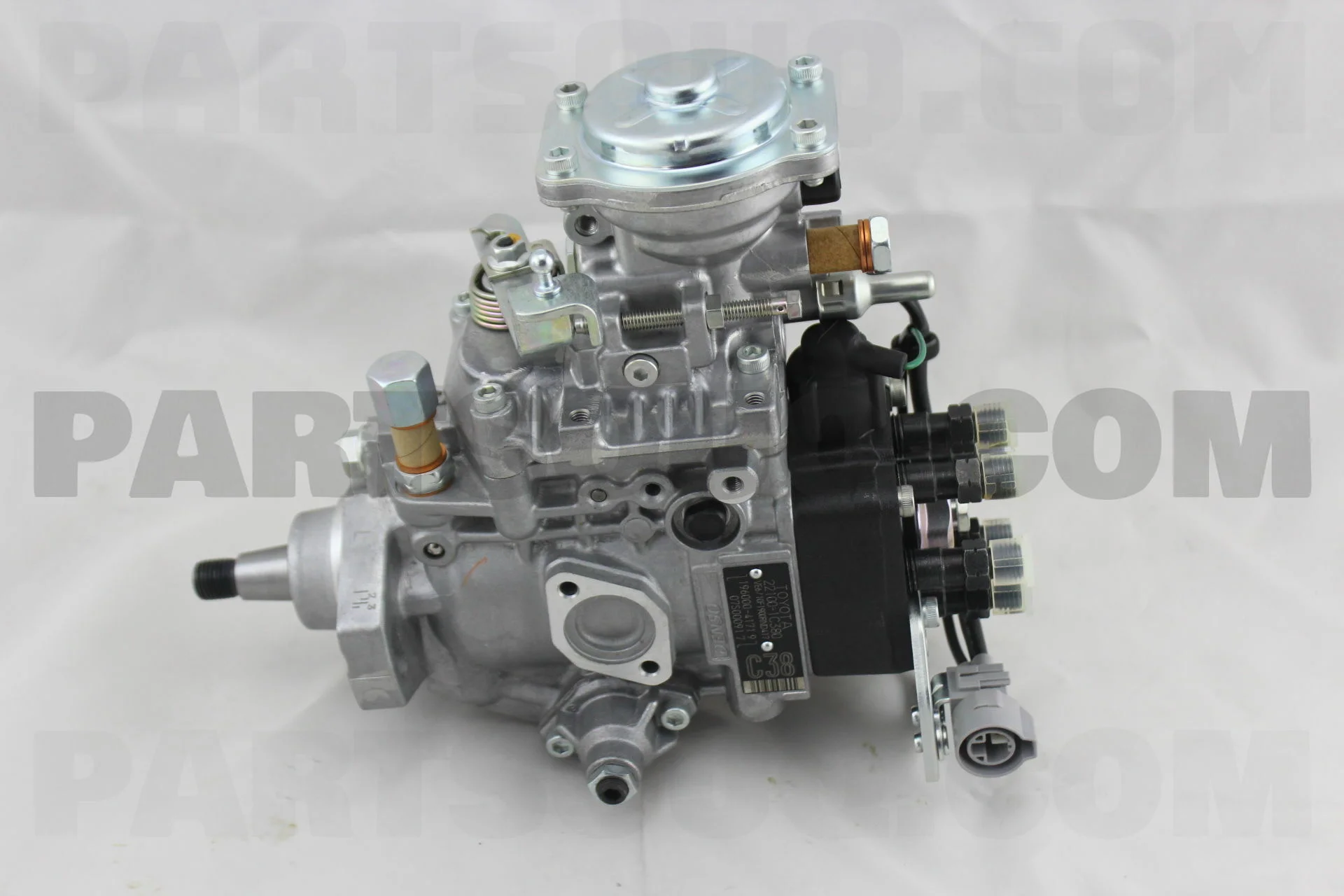

Looking at the picture, from the top round thing that is called high altitude compensator below that assembly is called ASCD? These are the exact pictures of 221001C380 downloaded from partsouq. The 1HZ in my car is the second gen 1HZ, not the one that came in 80 series.
