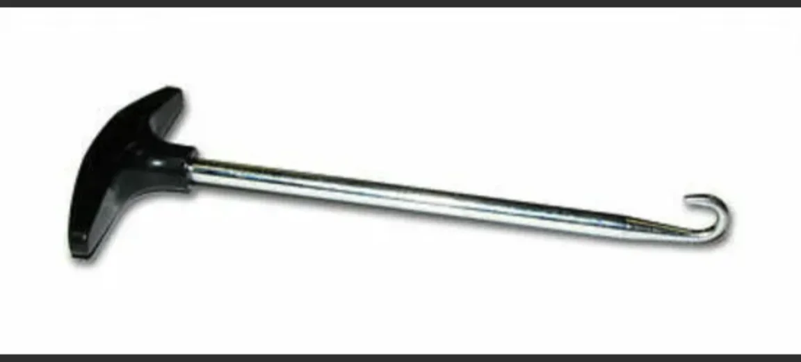

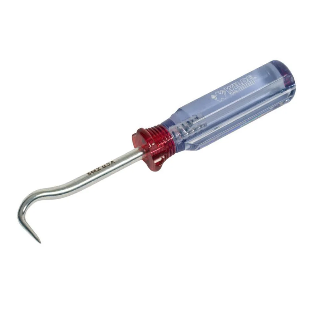

in terms of getting the spring on/off, the right tool, and the right approach makes it simple enough. It's an awkward spot no doubt
A hook pick, or a tee handled tool can help
