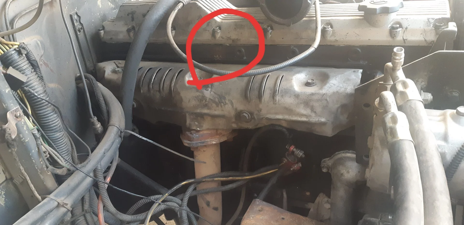

Maybe test for cracked head
There was a creck there and I covered it by cylinder glue. Small amount of oil used to coming out of there.
But what is the relation?
The cracks would be between combustion chamber and coolant passages. Cylinder head needs removal to see.
