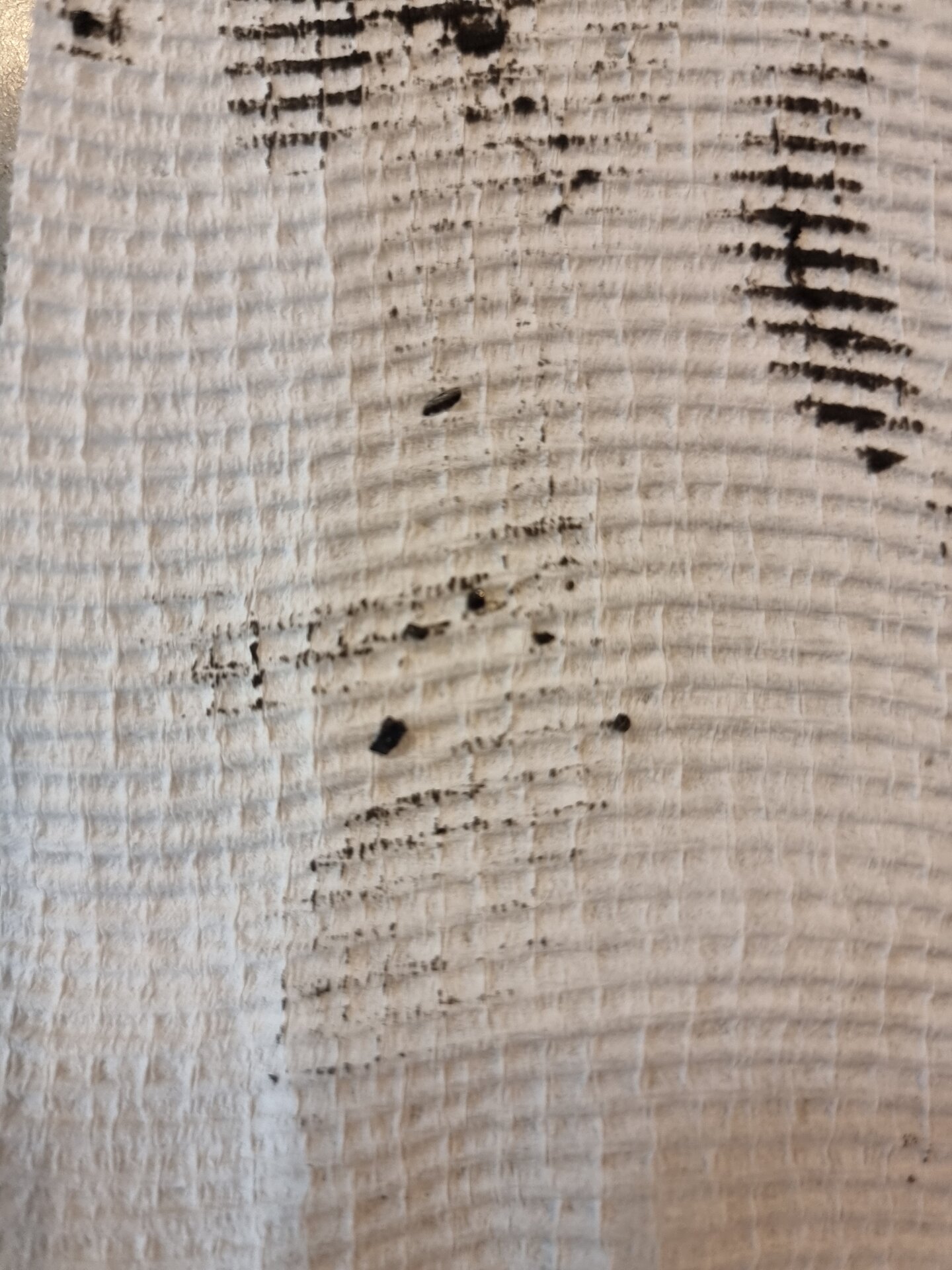

Here are some pictures of what I found. Oil filter completely clear, nothing on it at all.
What are your thoughts? I cant really jistify a $22,000 rebuild.

OP, just looking at your oil, that is absolutely filthy for a 1VD. You need to do a proper oil flush on that engine and get rid of that carbon build up. Look up Cost Effective Maintenance, their suff is the only snake oil that is any good. Grab yourself some of this gear and go to town with it. Their decarboniser is worth it as well.

Regarding the metal, what did the sump plug look like? Are those chunks magnetic? Because if they are, they're massive. Your oil filter should give you a better indication, any sparkles in it? From here I must say those look more like chunks of carbon than metal.
As far as swapping a 1VD for a 1HZ goes, it can't be done here in Australia for said reasons above, regarding compliance, your only option is to sell the VDJ76 and go buy a HZJ78 (Troopy). The 76 platform never came with anything other than the 1VD-FTV here in Australia.

OP, just looking at your oil, that is absolutely filthy for a 1VD. You need to do a proper oil flush on that engine and get rid of that carbon build up. Look up Cost Effective Maintenance, their suff is the only snake oil that is any good. Grab yourself some of this gear and go to town with it. Their decarboniser is worth it as well.View attachment 3531801 I've gotta service mine next week, I'll take you a photo of how my oil looks.

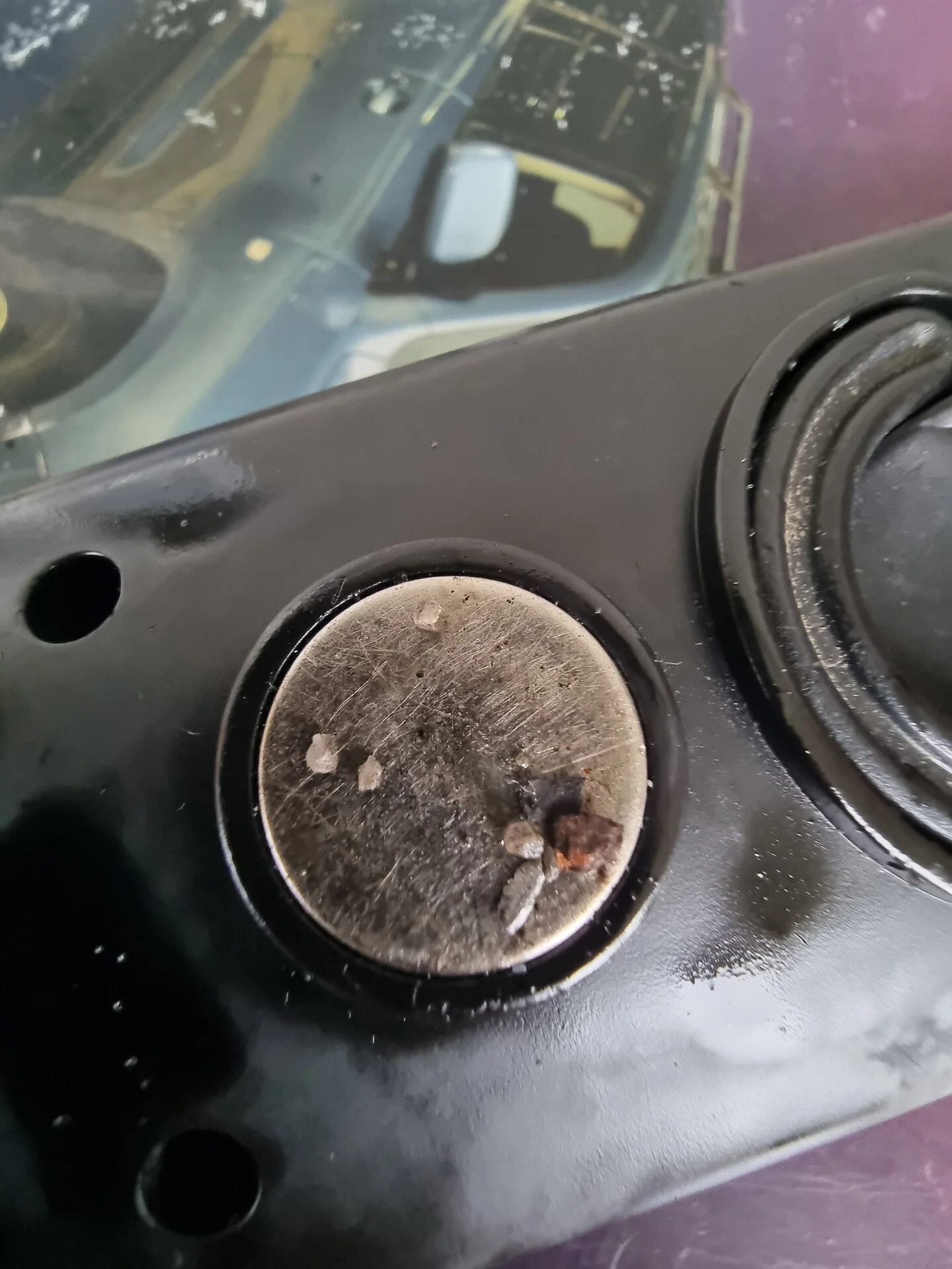

The particles are indeed magnetic, lucky I saved them (picture attached).

The sump plug was clean when I took it out. I had a look at it and was happy with it being clear.

Also, every now and again on the oil filter there is a little bit of sparkle. They are only on one side of it though?

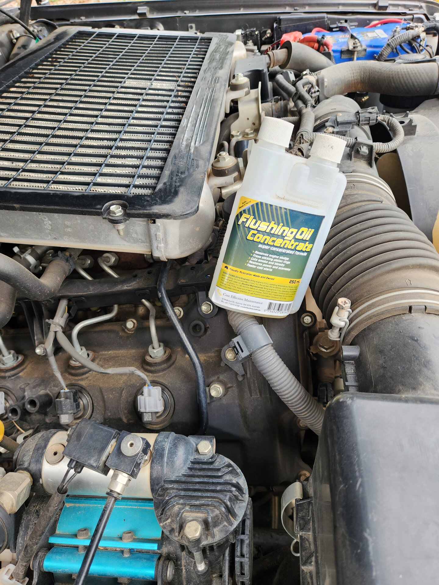

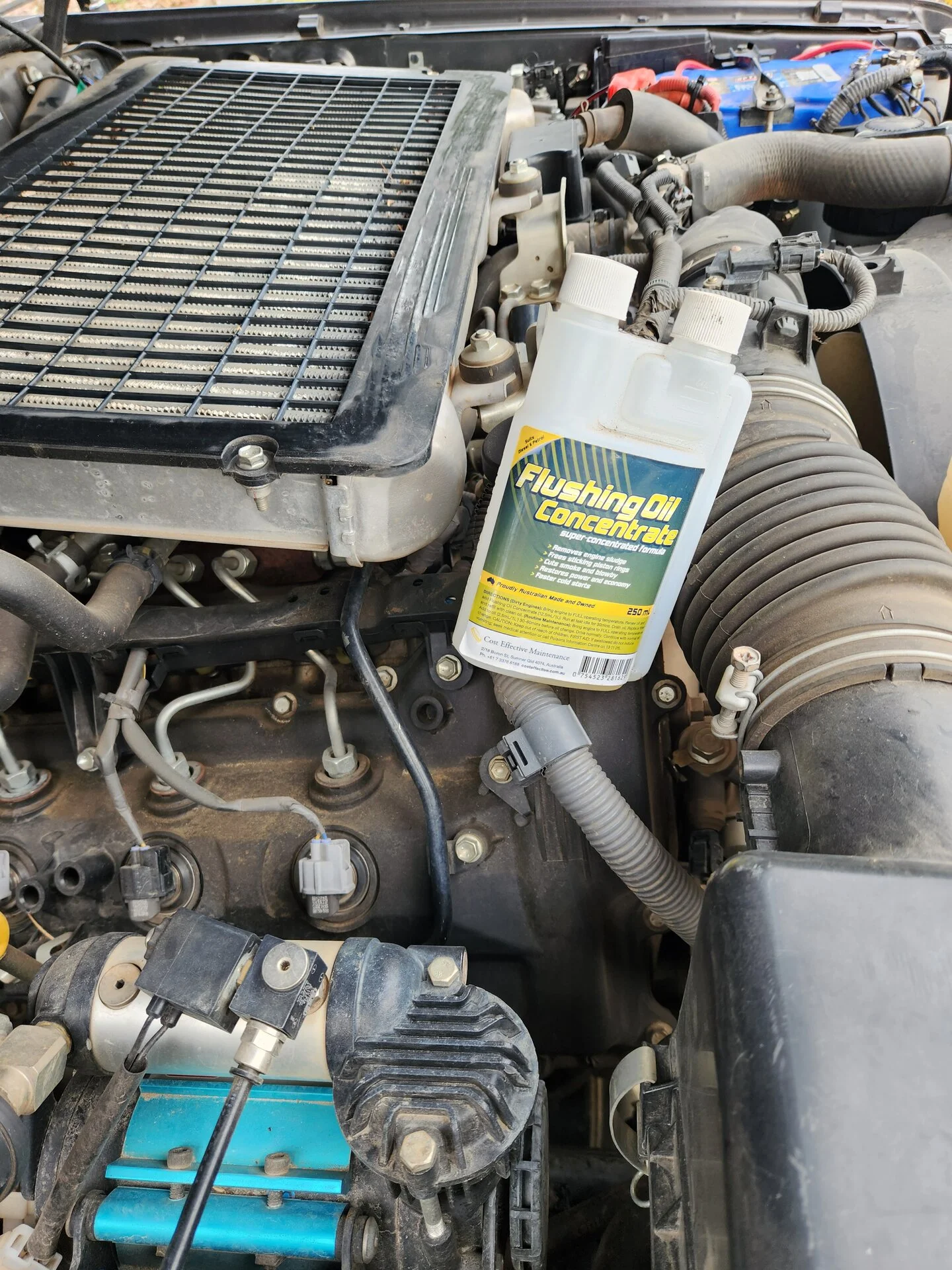

Also, can I use the Nulon engine flush or the luquimolly one? Is it even advisable to do an engine flush if there was metal in the oil? There wasn't much metal at all, even the filter I could have counted on 2 hands the amount of sparkles from almost invisible pieces of metal.

Those bit of metal don’t look right. One of them looks like a chunk of rust. They do not look like shavings from a wear surface.
Do you have a magnetic sump plug. If not then I would recommend one. That will collect all the free metal pieces in the same place and make getting them out easier.

The newer Toyota engines quite commonly shed chunks of casting from within the engine. The 1VD has been known to do this, so has the 1hz, 1hdfte and so on. It could be the case here. Not saying that it is, but you might not have any serious internal issues. If the 76 is new to you, i would do the following:
Order from toyota:
New filter housing (over time the sleeve can get loose and if it falls out the filter crushes under suction from the oil pump essentially starving the bottom end of oil flow)
New pickup. They are plastic and are a serviceable item. That's why the small black pan is on the sump so that you can get to it. They have a mesh filter in them that can sometimes get loose and fall out (rare but it's a cheap part)
Flush the engine oil with any engine oil flush, grab 20L of the cheapest 15w-40 that you can find and do it twice. Pull the filter both times because that will allow another 2-3 liters of oil to flow out. Afterwards replace the oil and filter with high quality gear and check again in 5000kms.
