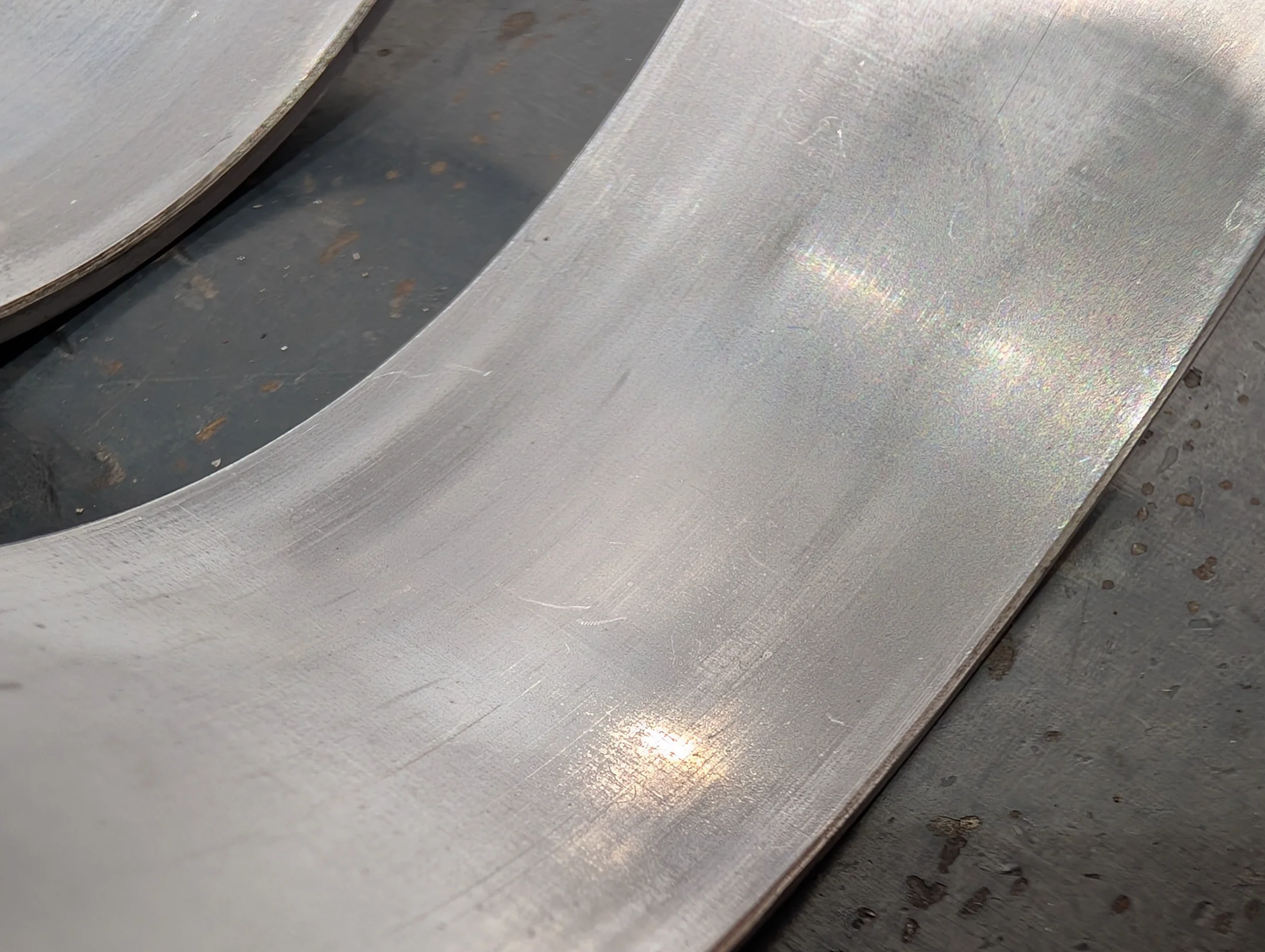

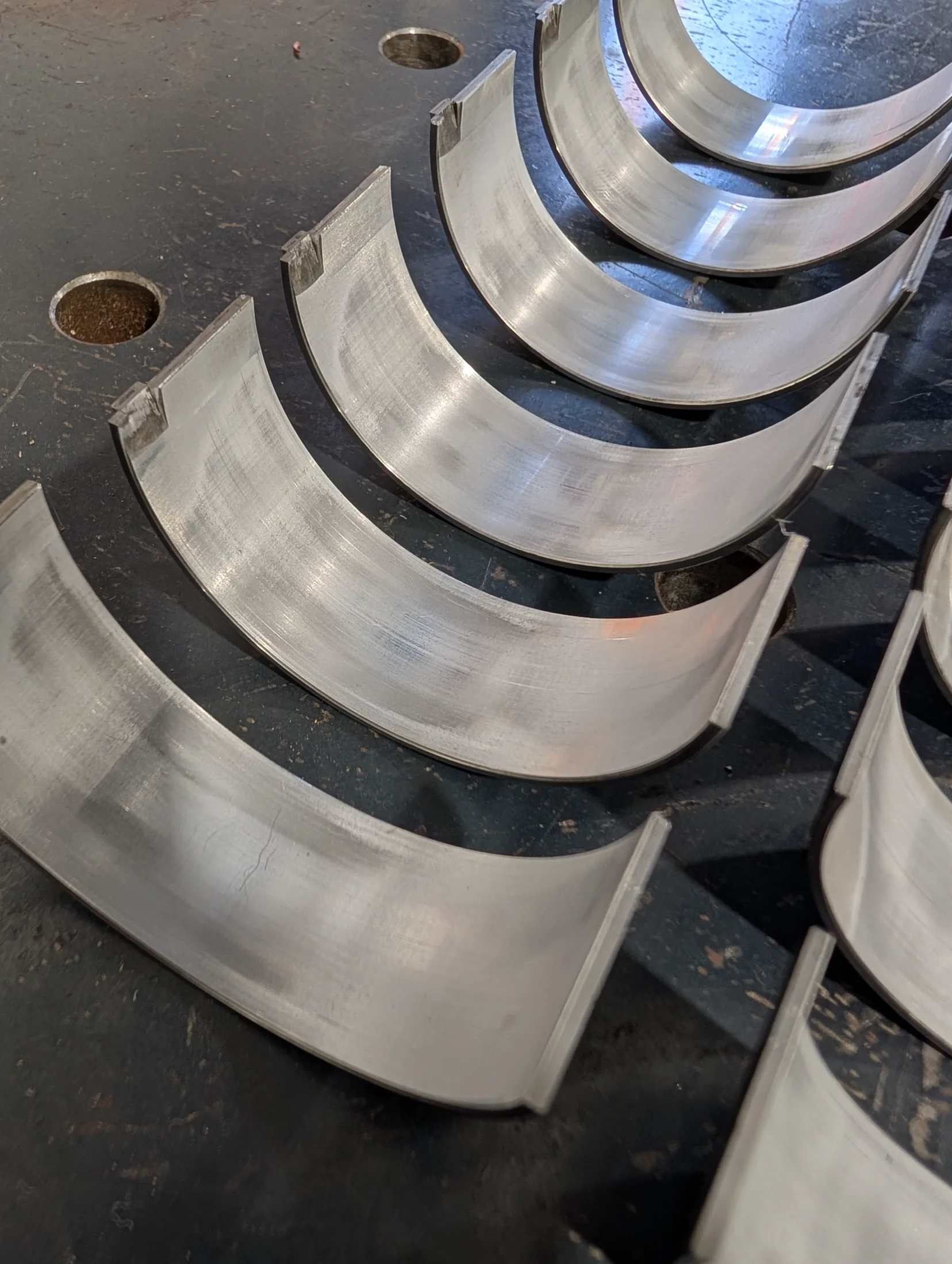

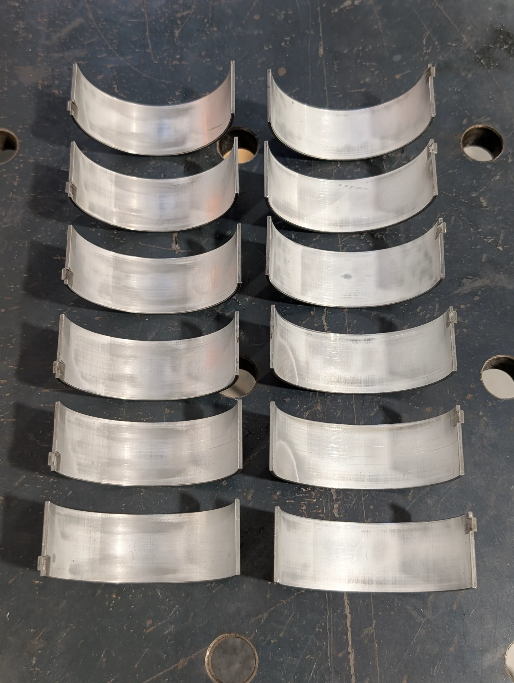

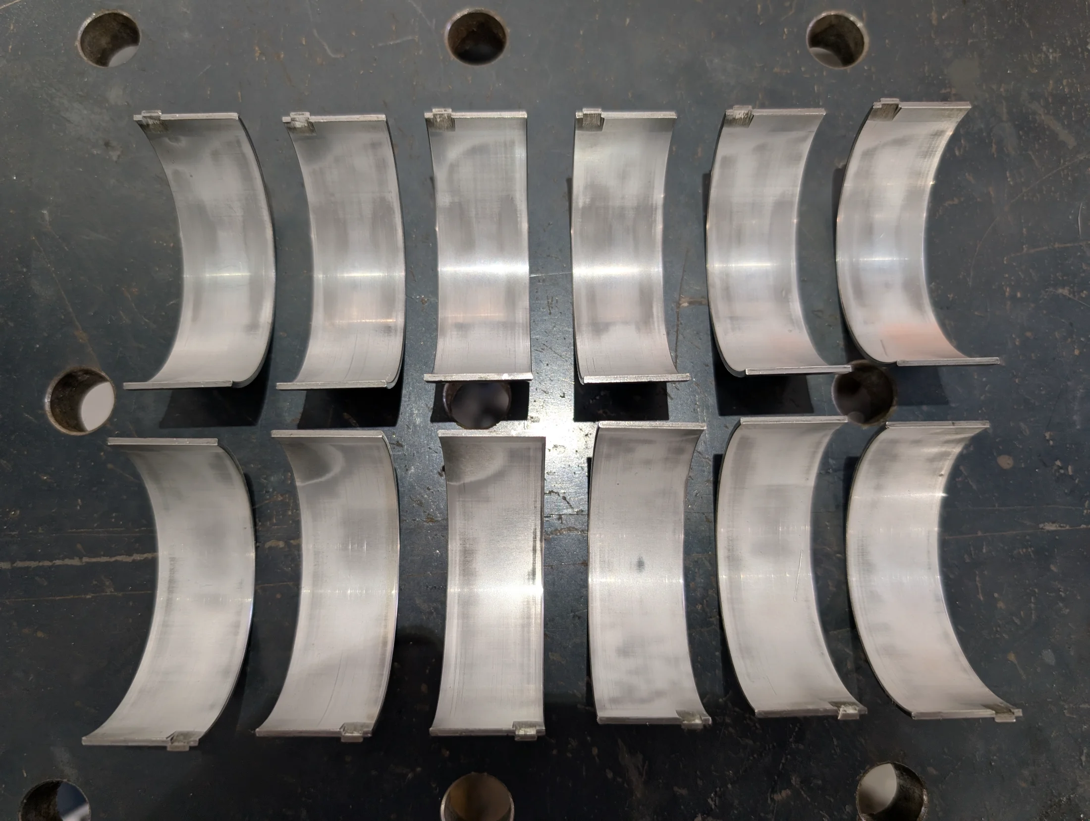

When I pulled mine apart, the bearings looked almost new. There was a bit of visual wear on the top cap, but honestly, it looked more like what you’d expect after break-in — probably within the first 10,000km of the engine’s life. There was no copper showing, no scoring on the crank journals, and no signs of impending failure.
I plastigauged a few of the journals and found the OEM bearings to be sitting at 0.050mm of clearance, which is in spec.
I also plastigauged some of the new ACL bearings (Duraglide 780), and also came up with 0.050mm of clearance - which is in spec according to Toyota but not according to ACL (see data at end of post).
I ended up throwing in the ACL bearings because I had them, and I like the idea of "new". Part of me wishes I'd put the OEM Toyota bearings back in. I dunno.
