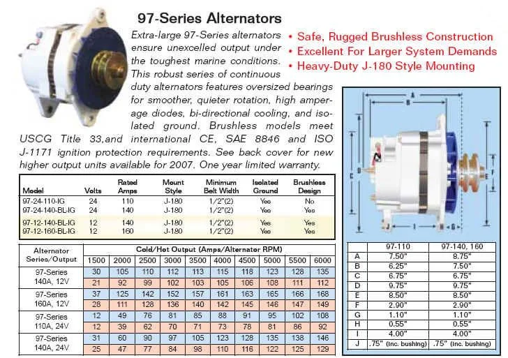

Im looking into buying a higher output alternator for my HZJ60. Does anyone here know the specs of the stock Hzed alternator? AND, does anyone know whether I can use a large case alternator in place of the stock unit? I dont have my truck in my posession so I cant go out and measure it....
Thanks.
Im looking at a Balmar large case 140 amp 24V alternator.

Yes my alternator is 24V.
The system is 24V. Id like to run a large case 24V alternator from Balmar.

Balmar 97 series. 24V 140 amps.... 77 amps at 2500 RPM. AHHHHHH!
