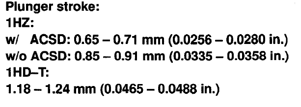

Thanks for the reply, yes I always install these pumps with plunger stroke, but due to modifications on pump and engine wanted to compare with a timing light. You say 8 degree max?
It is only the initial response I am looking at improving a little and I think a bit more advance and a little more fuel before boost and we should be good. But before I adjust the fuel anymore wanted to double check my timing to start. Interesting your spec is 1.58mm on the high side? all my spec books are 1.35mm
Sorry bud. I was looking at the 1hd-ft manual.
In Europe it says 1.43mm. Rest of the world it says 1.58mm
But you are correct on 1.35mm for the 1hdt. I wonder why the FT has it .08-.23mm higher spec. You could always give those values a go and see how it runs. At least you have some min and max values to go off.

When I look up the injection pump timing specification there are two different values for earlier and later year motors. However, I think the earlier specification only applies to 1990-1993. 1994 to 1997 1HD-T in the 80 series would follow the later specification.
The RM617E FSM was written specifically for the 100/105 series. I spot checked a number of parts between a 1997 80 series and a 1998 100/105 series and they are all the same for the 1HD-T. Not the case when I spot check the 1990-1993 models.
This leads me to believe that the 1HD-T plunger specification for 1994-1997 is 1.18mm - 1.24mm
Earlier - FSM RM172E (Feb 1990)
Later - FSM RM617E (Jan 1998)
