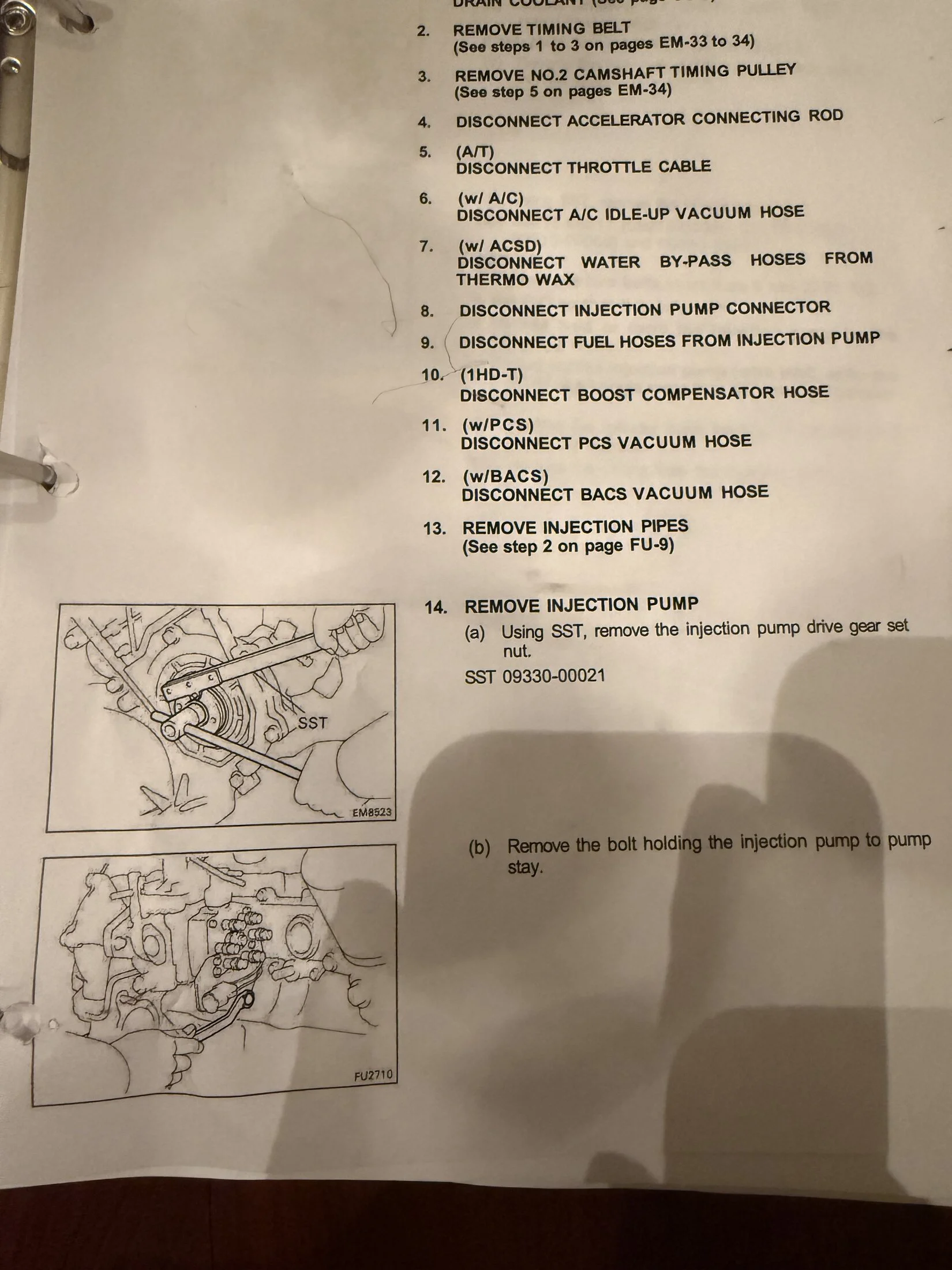

I’m in the process of removing my pump for reconditioning. The injectors are already out, and the hard fuel lines are off. I’m essentially following the FSM protocol (FU-28) but I’m stuck at step 14a - removal of the injection pump drive set nut. I have the special service tool. I’ve tried attaching it with the included pin as well as securing it with one of the timing pulley bolts, but it doesn’t hold it still. When I tries to loosen the nut, the pump rotates.
How am I supposed to secure this thing so that it doesn’t move? It seems that with only one attachment point to the tool, it will just pivot.
Fig 1-
Injection pump with No2 camshaft timing pulley removed
Fig 2 - SST in front of pump
Fig 3 - FSM
Any tips?

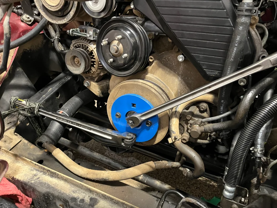

Do you have a crank shaft pulley holding tool? I use it to hold the crank and then remove the nut. The crank and pump are all connected via gears behind the cover.
Crank holding tool (blue)
Gears behind cover.
