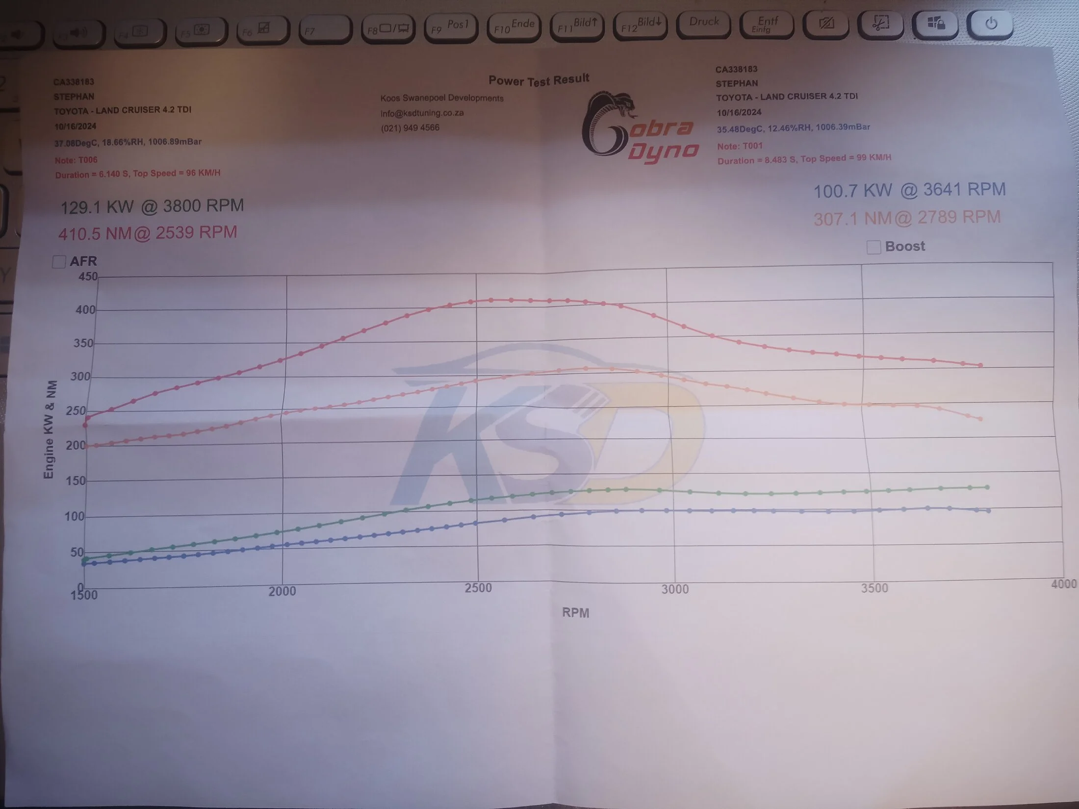

Performance update with good results!
I would recommend to use the strongest of the supplied actuator springs
The guys on the dyno have their boost sensor calibrated once a week.
My EMS shows peak 0.9bar, in real it is 0,7peak!
This is with the medium spring supplied by Mamba, which suppose to be a 1.2bar spring.
(so much for the parts acuracy from Mamba)
I will try the 1.8bar spring soon, that should bring me at least the original 0.8bar or a bit more.
And yes, I set the pre tension correctly.
Its probably because those Mamba parts are not tested at all after production.
If one goes for the turbo, it might be wise to purchase a quality actuator and throw that junk directly into the recycling bin.
Its literally a pain to get the actuator out (there is not much space)
When I go on dusty roads I use a foam sock for the snorkel , see results from the dyno and fuel pump adjustment.
