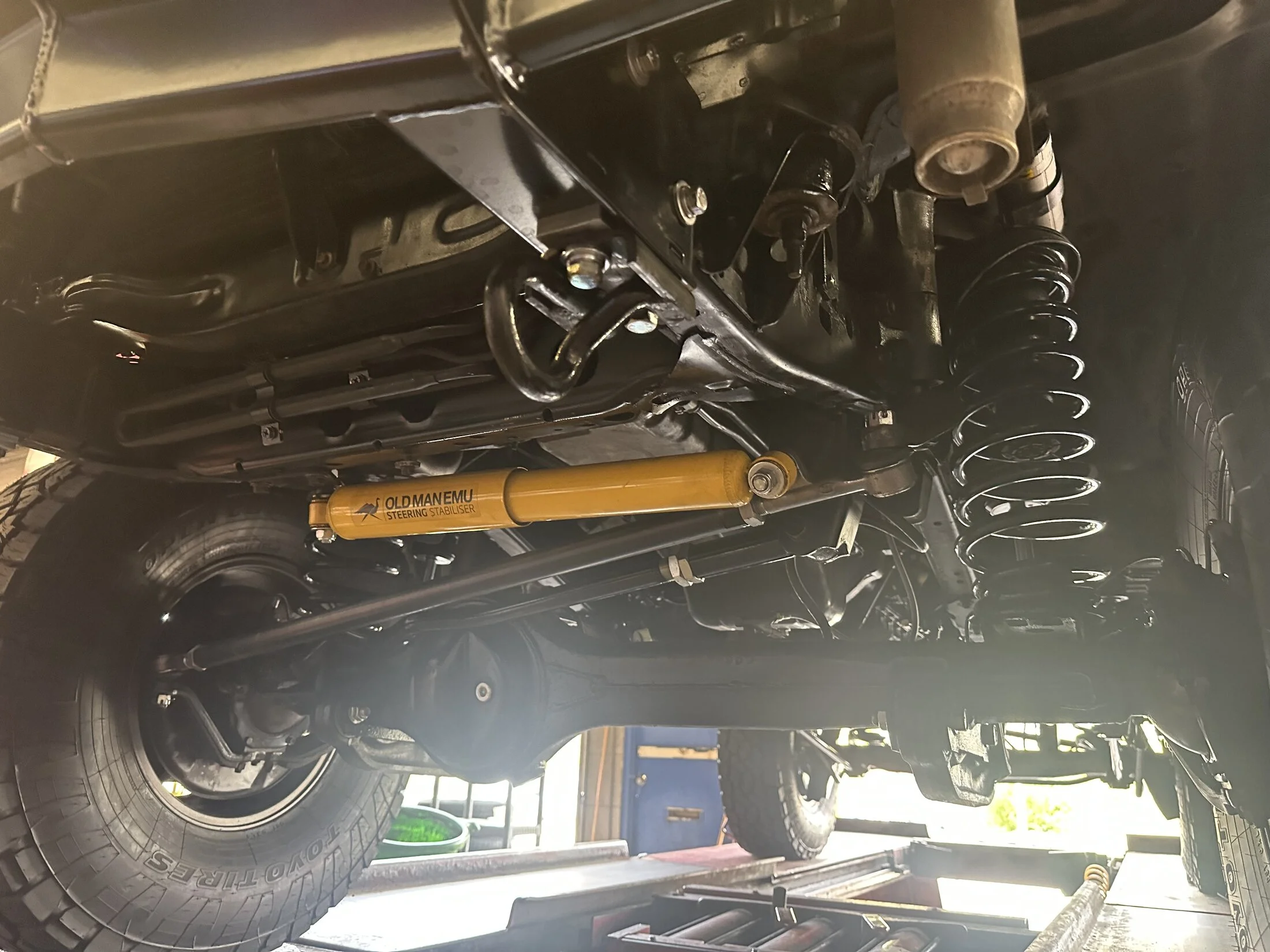

There's Yota Masters in Corona, it looks like they do mechanical work as well:

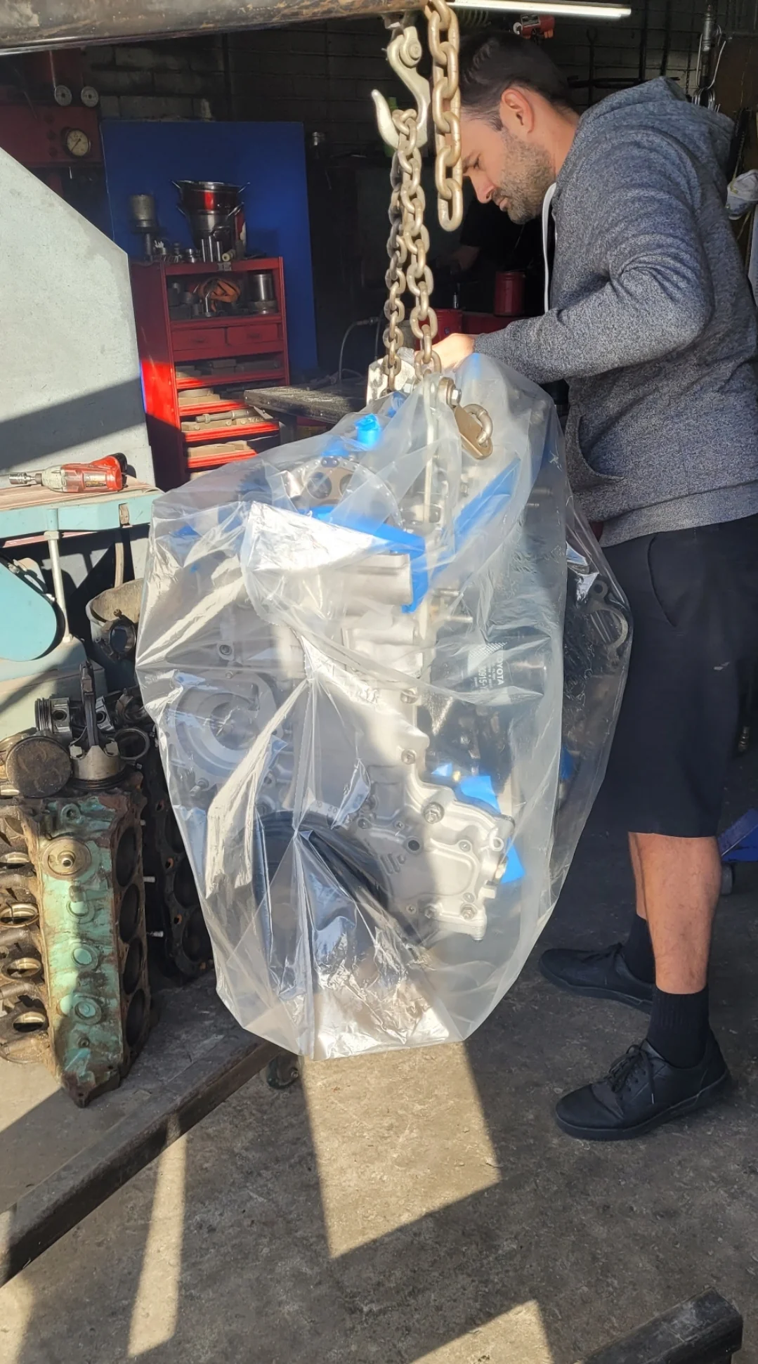

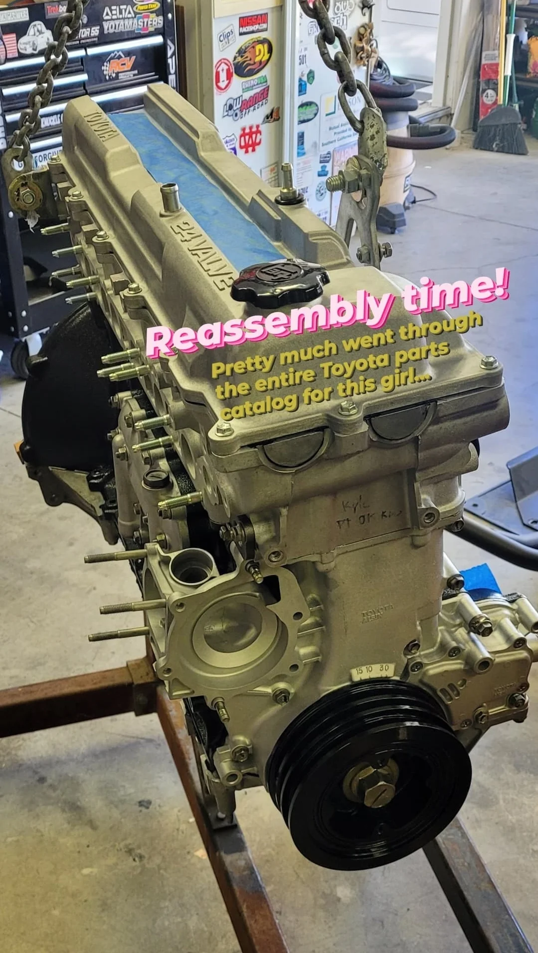

I went with Martin Davidson Machine shop in Reseda.
Martin Davidson's Automotive
(818) 705-2441
Google Search - https://g.co/kgs/7D9vH67
I asked a few local shops in Orange County and LA, all of which were extremely expensive and couldn't give me a definitive answer if the parts being used in the rebuilt would be OEM Toyota.
Rant: I'm talking specifically about CruiserTech over in Laguna Beach. The owner literally sent me a blurry 4 line excel spreadsheet and quoted me $8000 lol
Kyle has a lot of experience rebuilding Inline 6s and did a fantastic job on my 1FZ. The invoice was detailed and he was great to deal with through the whole process. I would 10/10 recommend him again. He did a beautiful job on my engine. Although I probably should've just opted for a V8 once my tally of OE parts was done... Shoot me a PM if you want anymore info. I'd be happy to send you over his invoice and info he gave me!
