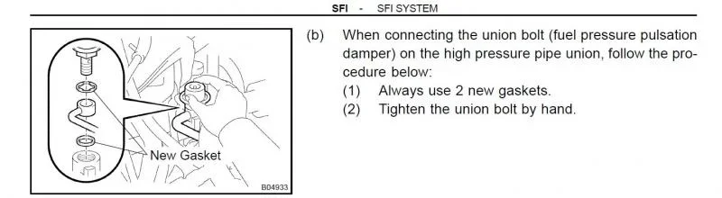

maybe the correct term is gasket instead of o-ring. see if this pic helps

It looks like the fuel pressure regulator.
My fuel filter did come with two copper rings. I would imagine they go somewhere... Do they act as a "gasket" of sorts? I am not sure how they would seat themselves in the flanged set up...
The copper 'rings' are crush washers. They provide the sealing. If they are not installed its sure to leak.

Just so I do this right and not srew up the flange. I put both of the copper rings in the fuel in side of the filter then insert the flanged tube and just tighten down the bolt?
