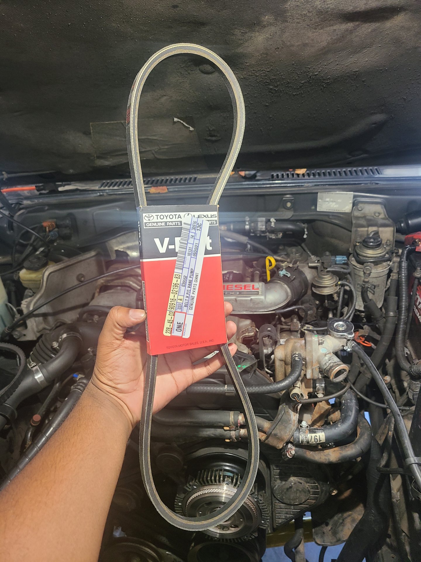

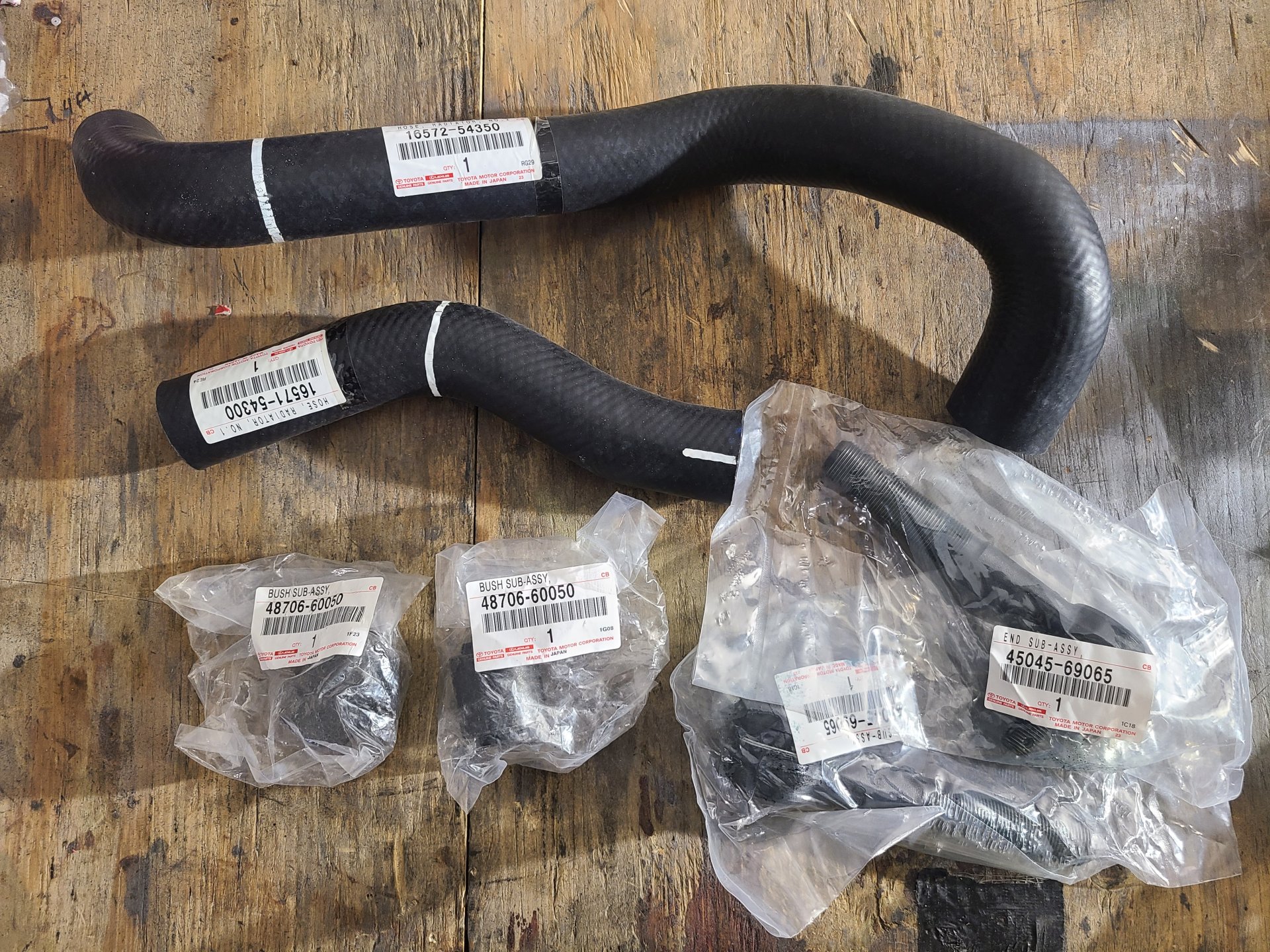

Went ahead and replaced the old rusty hoses, front panhard bushings, V belt, and front tie rod relay ends. I have a couple of other things I want to replace as well but in time.
now I had to order some of the parts from overseas through PartSouq.com simply because I couldn't find them locally

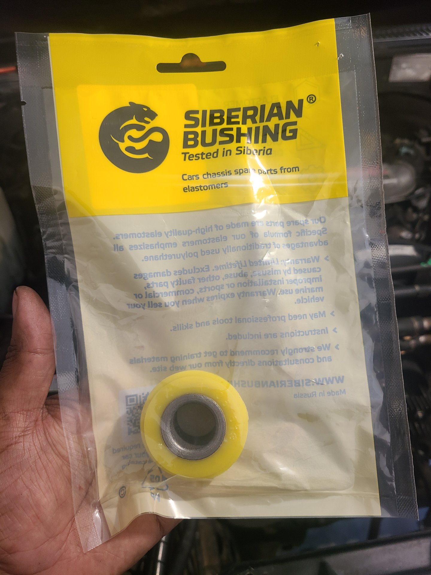

Came across Siberian Bushing on eBay and ill be buying more from them! they have tons of bushings for the LJ and pricing isn't bad at all. just make sure you message them and let them know you're buying more than one bushing to get some savings on shipping shipped from Russia to USA in 3 days

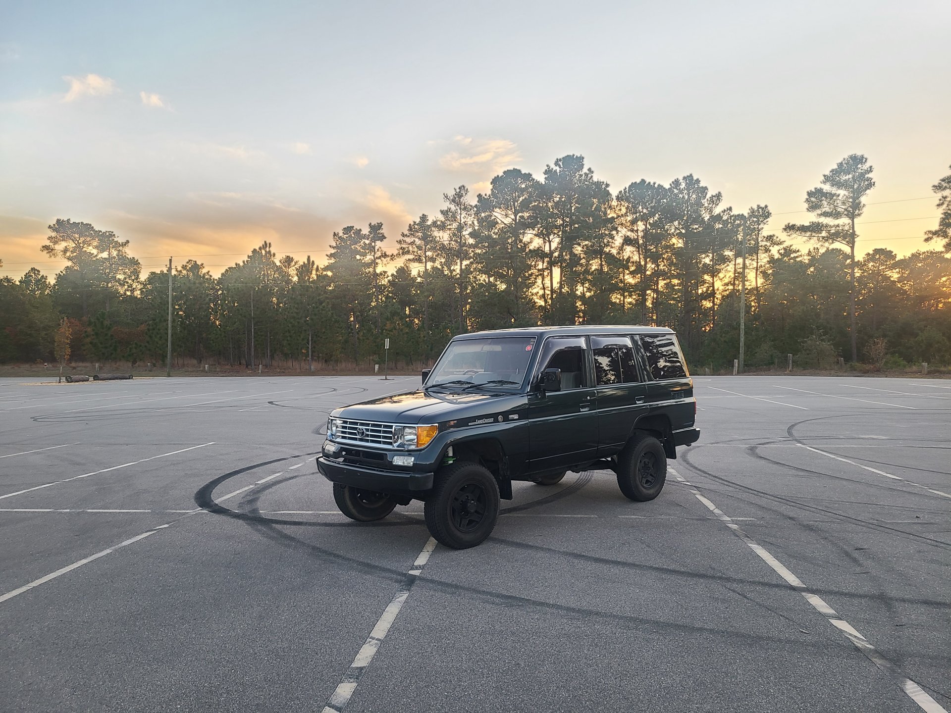

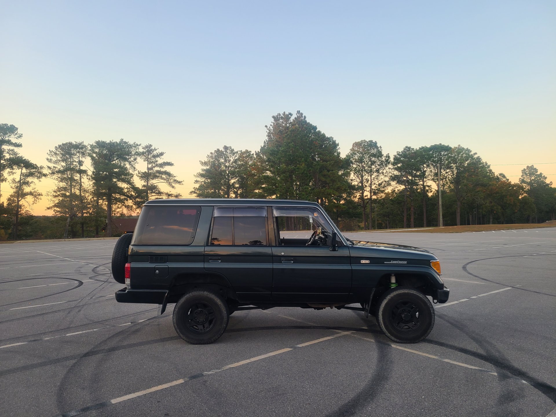

Current photo of the truck with the 2in lift from Ironman4x4

Just be aware that those poly bushings make for a harsher ride and less flexibility in the suspension. That said, they are tough and will last longer than softer rubber ones. If you intend to keep your vehicle as basically an on road vehicle, then the poly ones are fine. If you go off road, you'll find the lack of articulation quite limiting. (in particular, it's the radius arm bushings that you'd want to be on the more flexible/soft side for off road).
