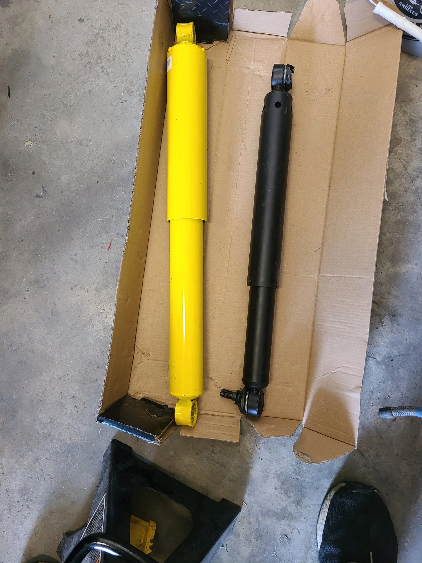

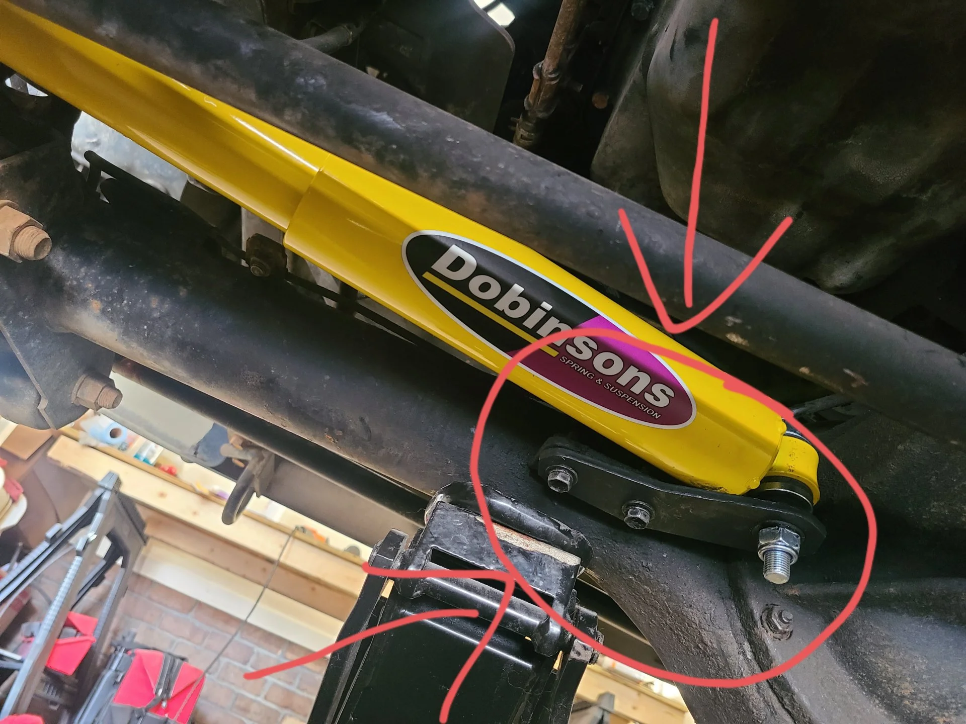

New steering damper from Dobinson's installed but ill have to order a new mount for it... I got wild with a grinder and took a tad bit too much off. it'll hold for now. LC80 mounts look almost the same so I might order one and see how that goes. If anyone knows the exact answer let me know. thanks in advance

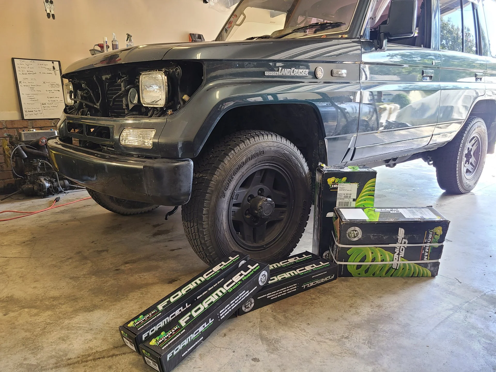

Finally got my ironman 4x4 2in lift! Wasn't able to install the front but that's for another weekend haha. In order for me to install my lift in the rear I had to dislocate the rear Panhard rod to only find out the OEM one doesn't fit anymore due to lift. So another part to order but that's life. Also if anyone cares rear springs are rated from 0-330lbs and fronts are 110-220lbs
