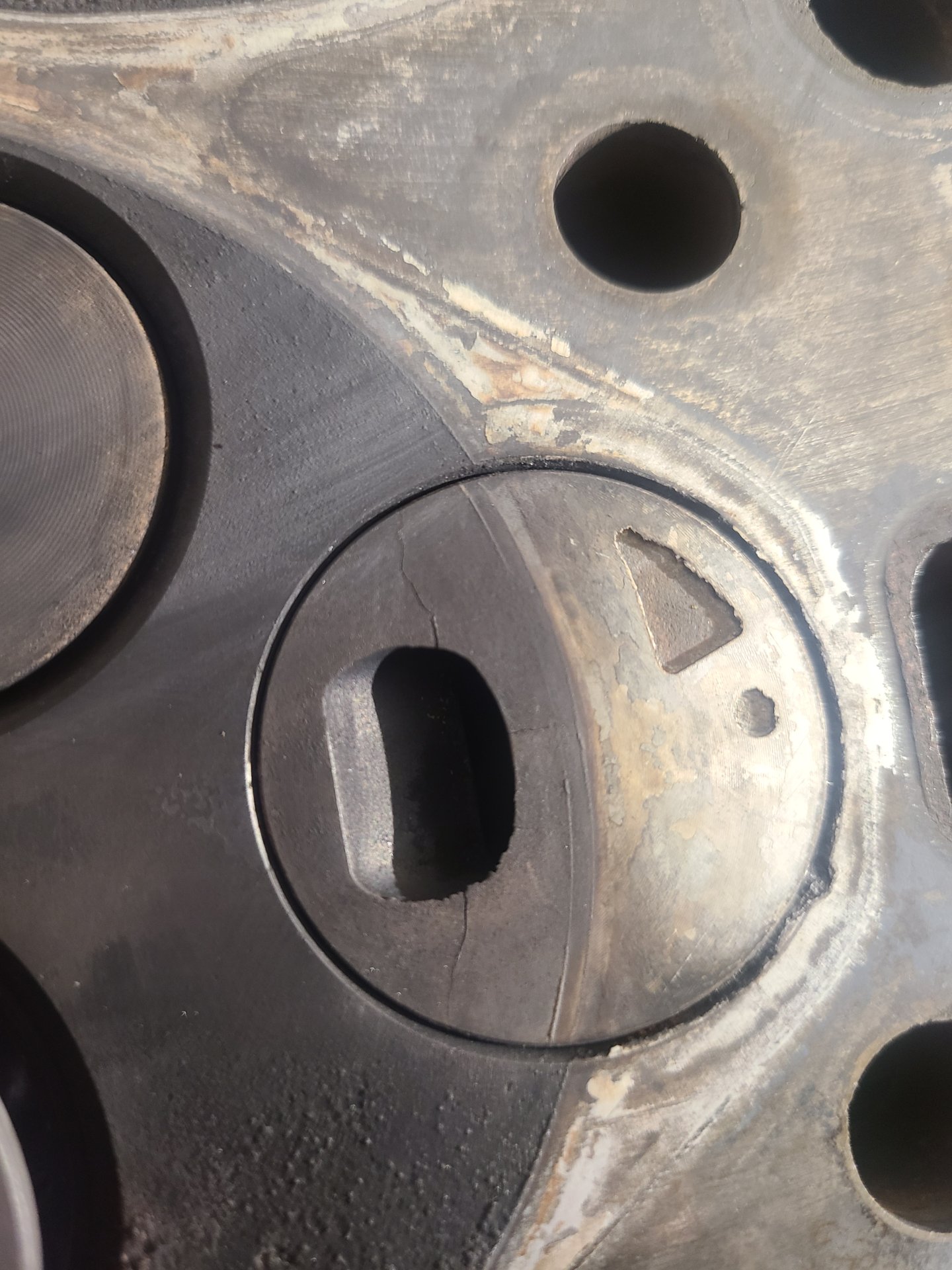

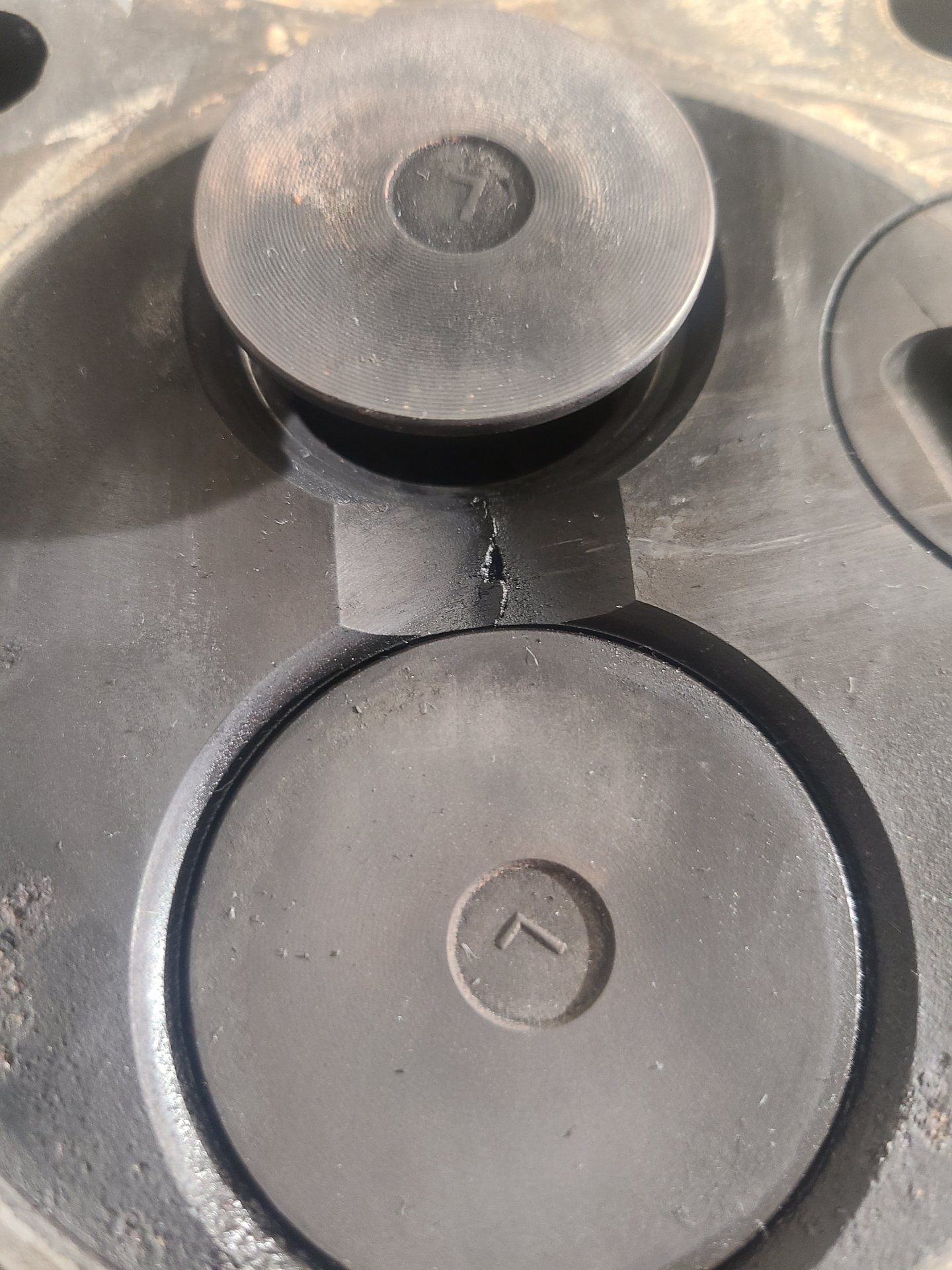

Now ive been cleaning and inspecting and looked at the under side of the cylinder head bock and noticed tiny cracks.... thoughts on it?
View attachment 2916529View attachment 2916530
You'll have to replace your cylinder head with the newer improved version. The cracks between the valves are not repairable. That must be the original version on there still. The cracks in the pre-cups are common though and not end of the world. As much expense and work as it is, at least you can rest easier with a new head.

Haha one of my biggest nightmares came true when I flipped it over and started cleaning/inspecting.
had to really sit down the last couple days and decide what to do.... Im really leaning towards going ahead and swapping a 1KZ into the truck. yes its gonna cost more than 2L-TE head but more power and more reliability sounds worth it. if I were to go that route what do I need? other than 1kz engine, trans and ECU... does it mount the same exact place could I even use my existing 2l auto trans?

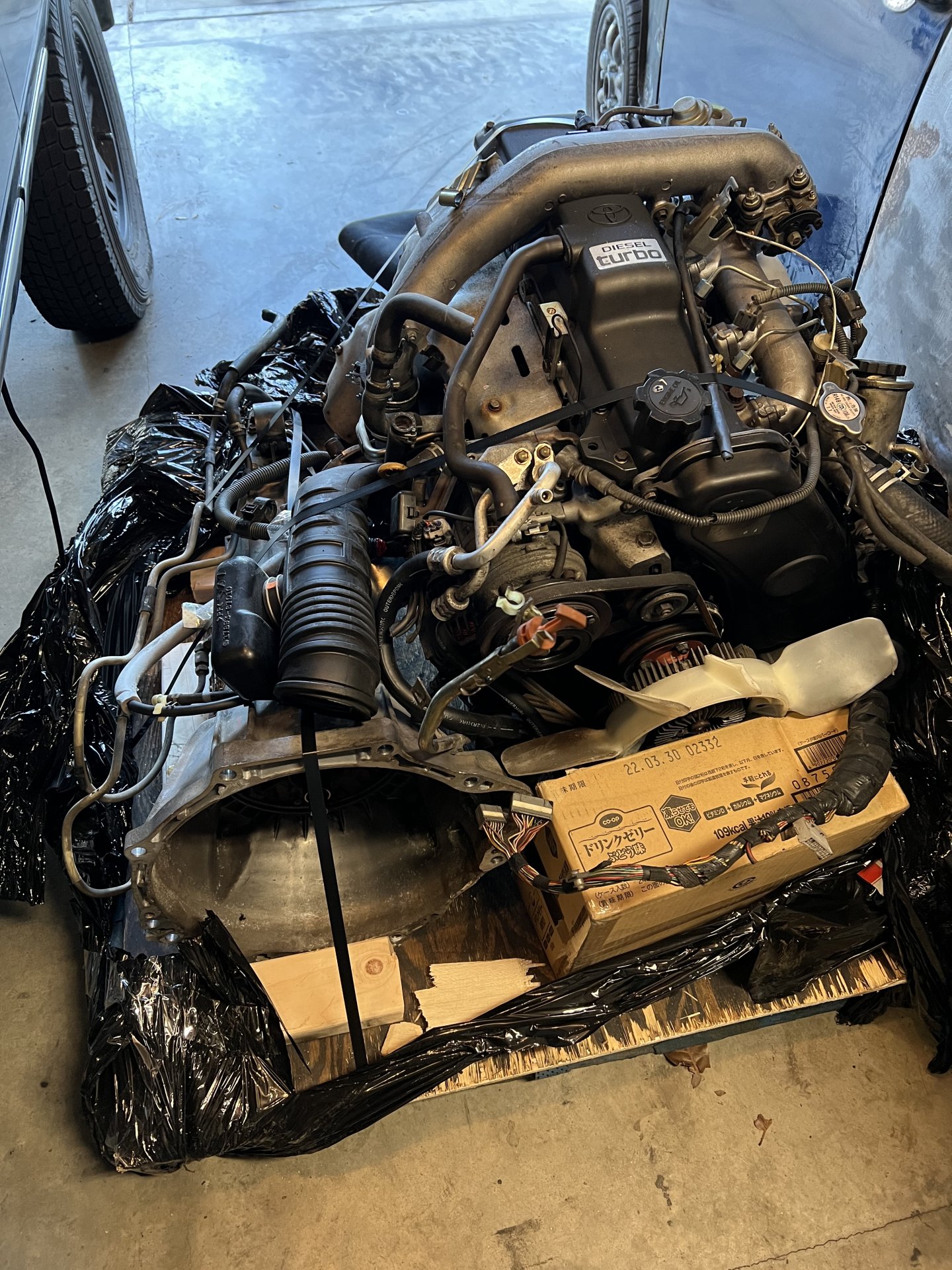

tons of sleepless nights trying to figure out what to do. Luckily I found a 1kzte out of a surf stateside with tranny, ECU, and loom.
The goal is to swap everything in and go from there. Now someone on my 1KZ post noted that someone makes the 45mm plate to mount the engine in but waiting to hear back who I need to message.

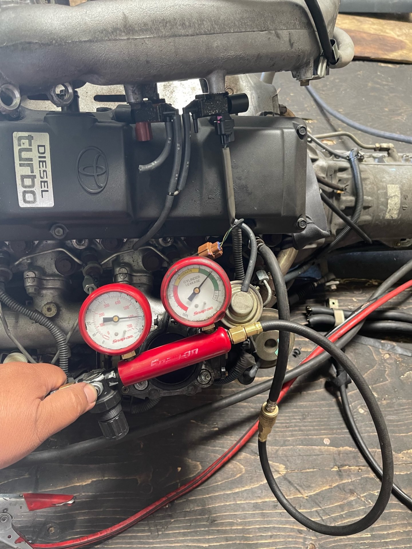

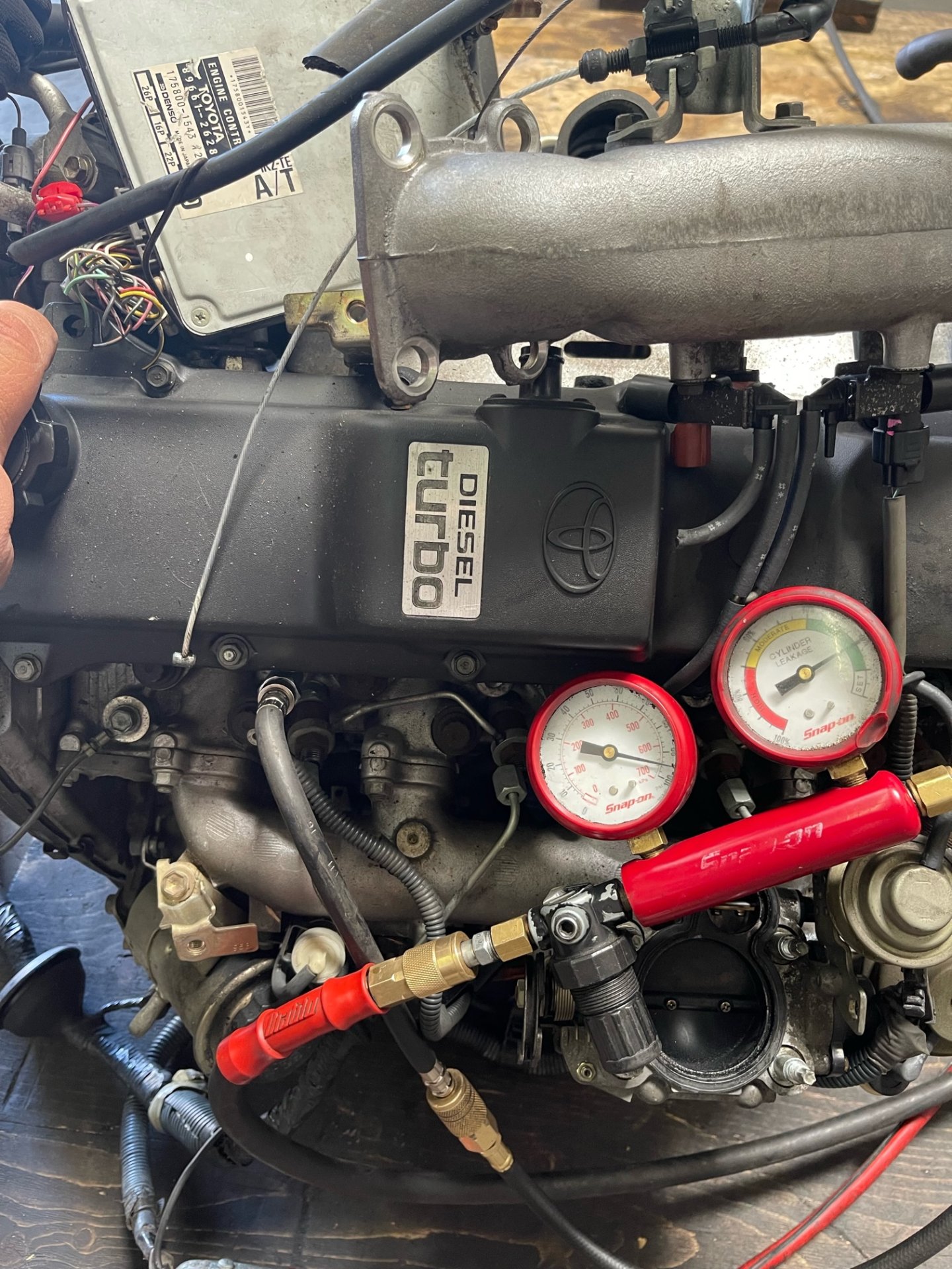

here's some photos from the leak down test. they all seem to be around 650ish and 1 looks to be maybe 610 or so. I doubt that'll be a problem seeing as everything else is green. Anyone see anything wrong with that 50 or so difference?

One thing to note about the Surf transmission, the transfer case is different and won't work in a Prado setup. You'll need to either use the Prado trans or see if you can swap the rear portion of the transmission to run the Prado transfer case.

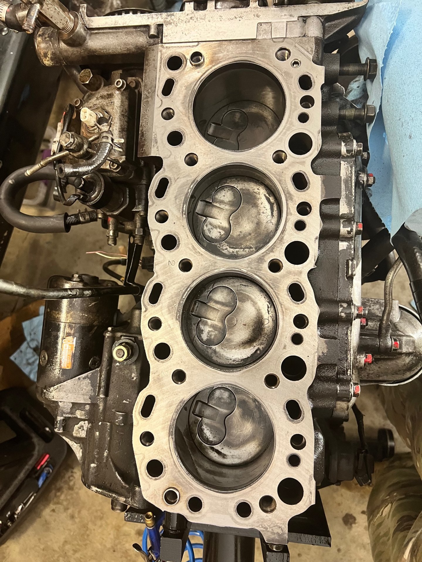

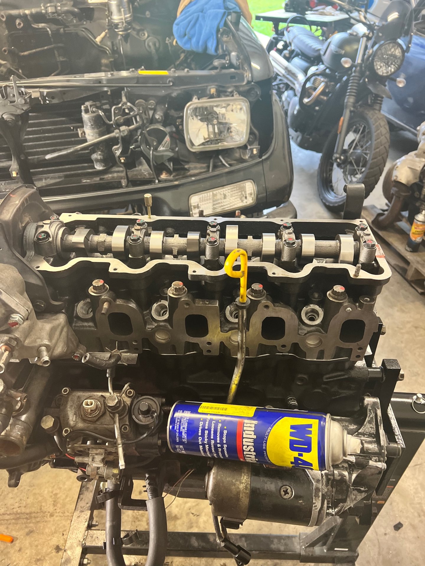

Been some time but I'm finally making moves on the LJ. Learned how to ride a motorcycle and got hooked lol. But anyways! New head installed on the LJ plus other bits and bobs.
While the engine is pulled I've ordered some new belts and bolts which I'm waiting to come in the mail from PARTSOUQ (love them).

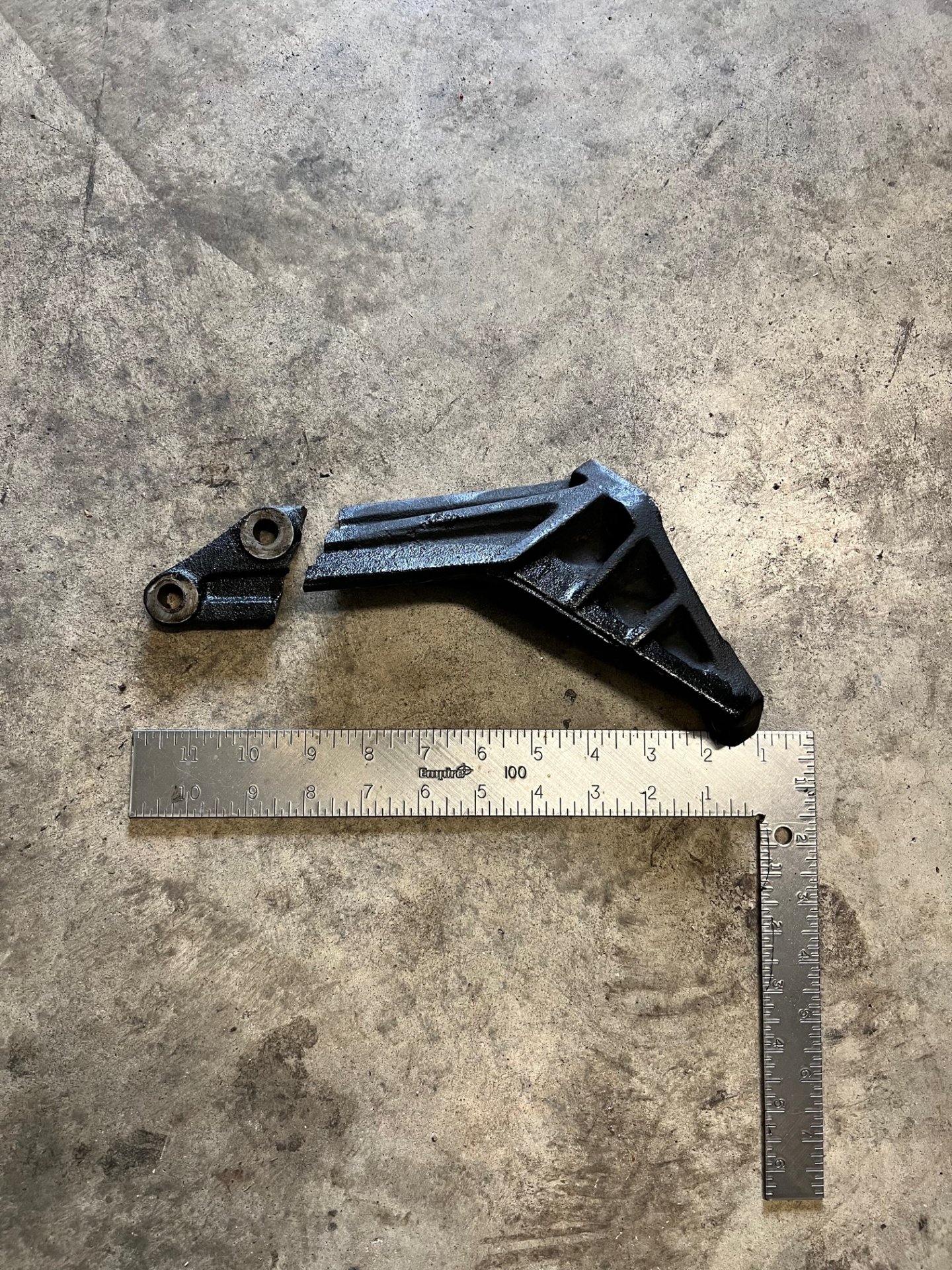

So what about the bad news? While the engine was on the stand of the brackets cracked clean in half... so currently looking for someone local to fab up the part. I looked high and low for a replacement but unfortunately nothing came up.

Nice work! Any more pictures of that cylinder head before you put it on? Where did you get it again? Looks interesting.
I'll keep my eyes out for the part you broke to see if I can locate one locally. I could ship it to you.
