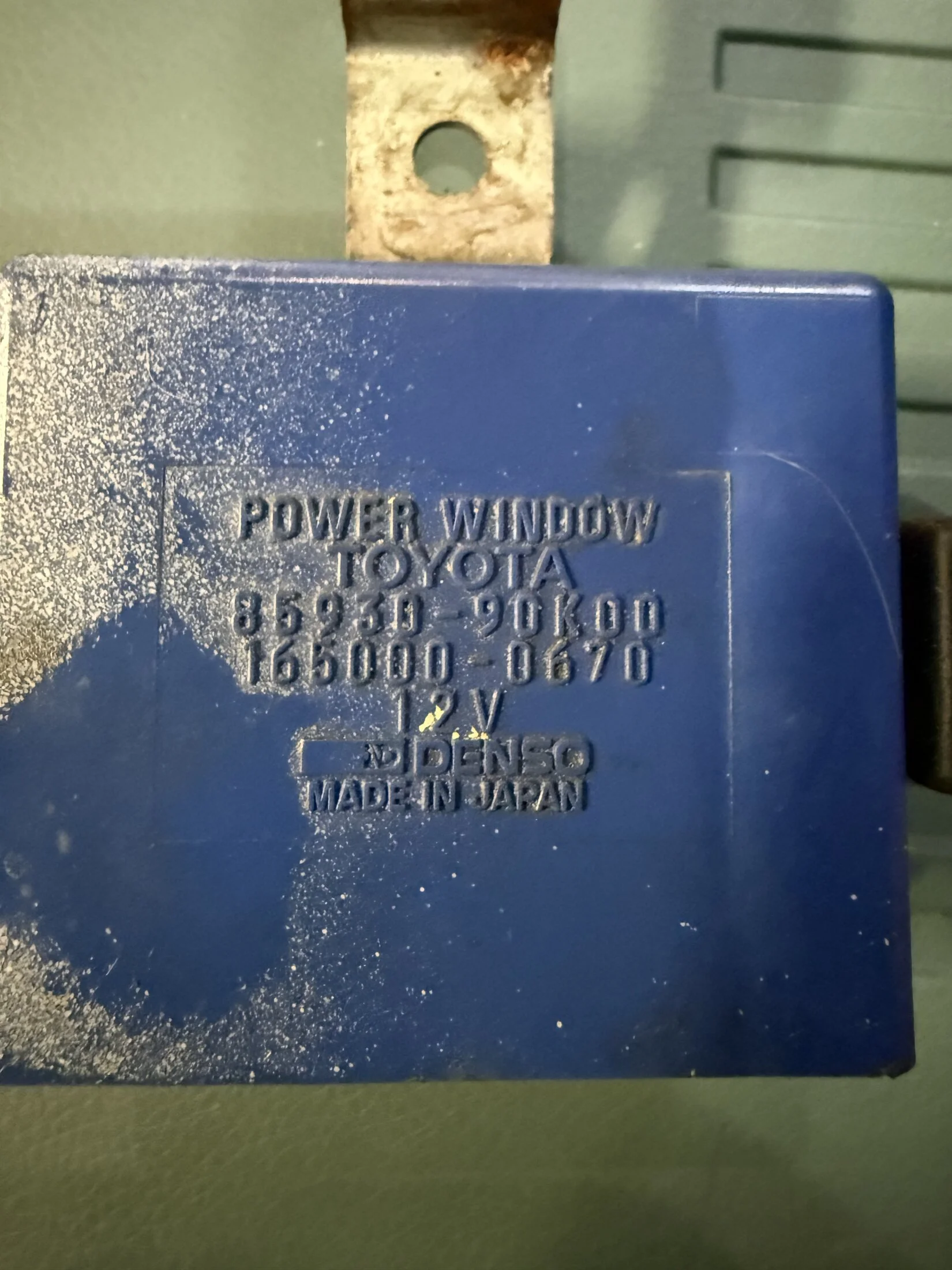

The box in the diver side door has “ power window Toyota - 85930 - 90K00 / 165000 - 0670 12V Denso “ written on it
Can I fix this myself or has anyone got an idea of how to track down a replacement?

Hello,
That is the power window relay. It is possible that it is long discontinued.
You can use the relay from a newer model 70 Series. By newer model, I mean up to 2014. From that model year on, the power window system changed and ditched the relay.

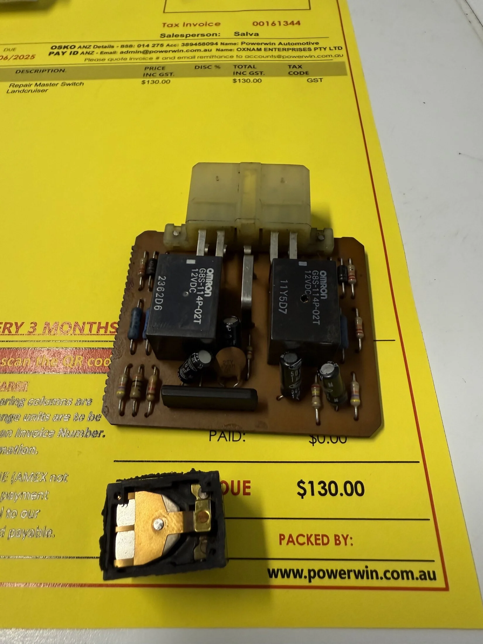

Update : FIXED!
After a long search I found a power window repair shop in Brisbane.
I handed over the circuit board of the (almost 40 year old) power window and within 48 hrs they had replaced the blown relay with an identical relay and diode on the board.
All for $130 AUD.
Popped it back in and works 100%
I reckon that you could post your circuit to them and they would repair it and send it back :)
