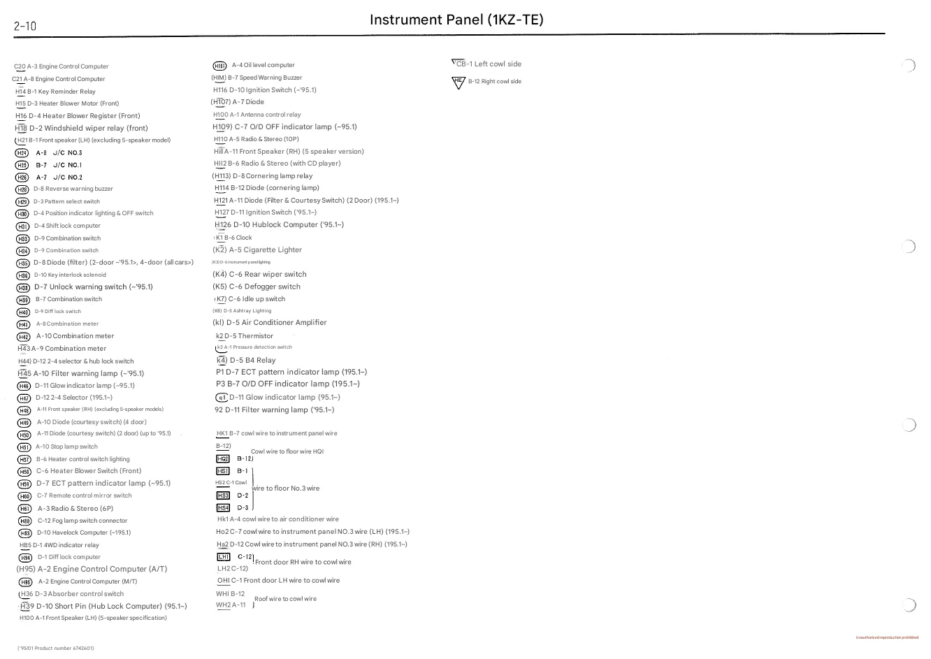

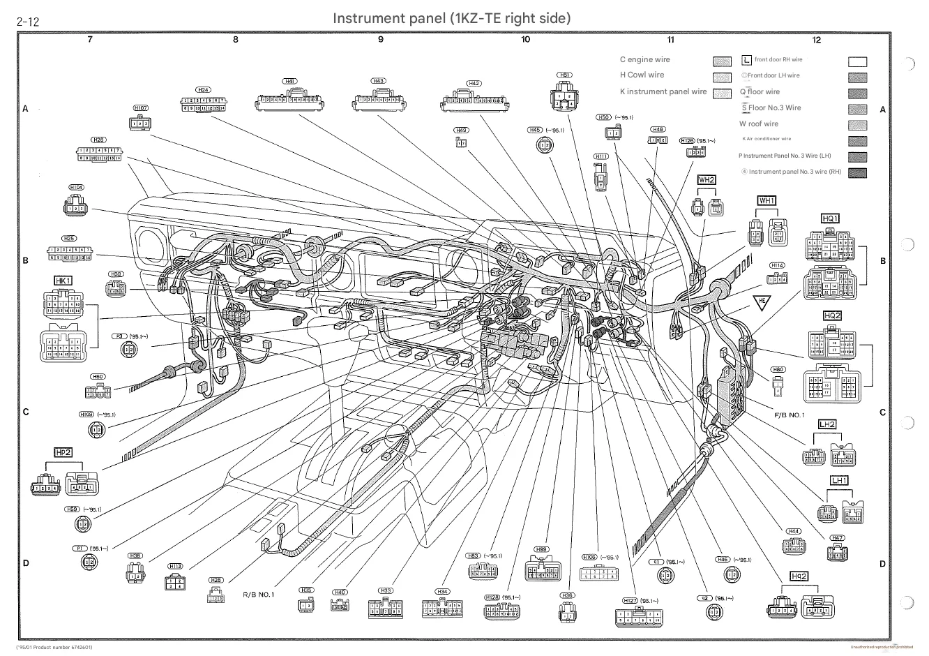

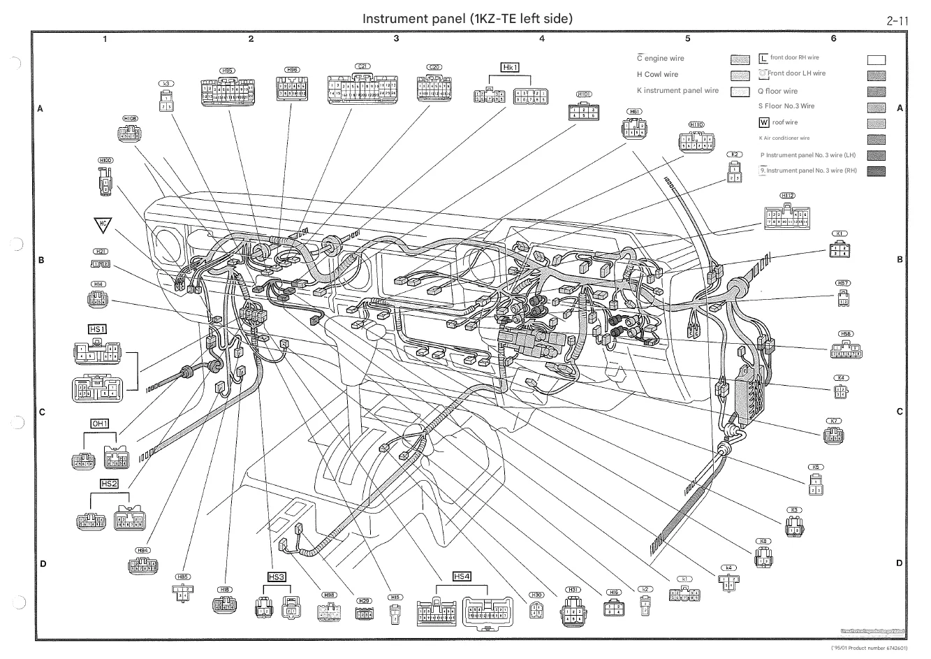

Looking for help on locating the power windows relay location. After the car sat threw winter, I had to replace the batteries and ever since then the power windows (all four) had stopped working. I tried a new master switch in the driver's door but still no luck. The power locks button works fine on both the old and new unit. I dropped the truck off at the shop and we're currently trying to find this relay or any diagrams that may be helpful. I'll share the documents I found on here but so far no luck. Thank you!
