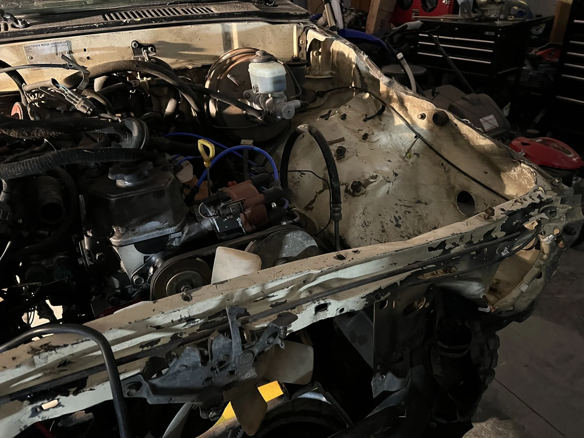

Current progress is just washing it with the fender and hood off and truly figuring out the damage to the front frame cross member. I figure if I document this I won’t let this project go to the wayside.

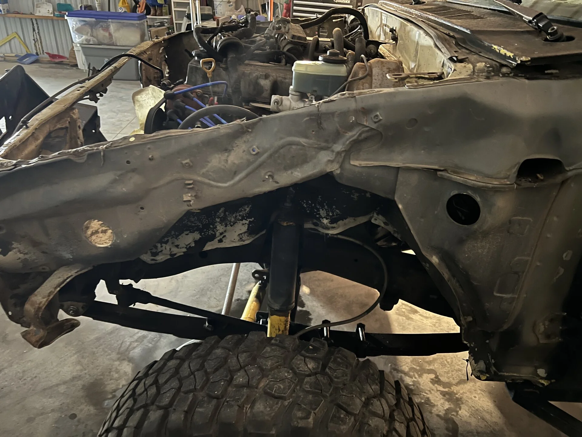

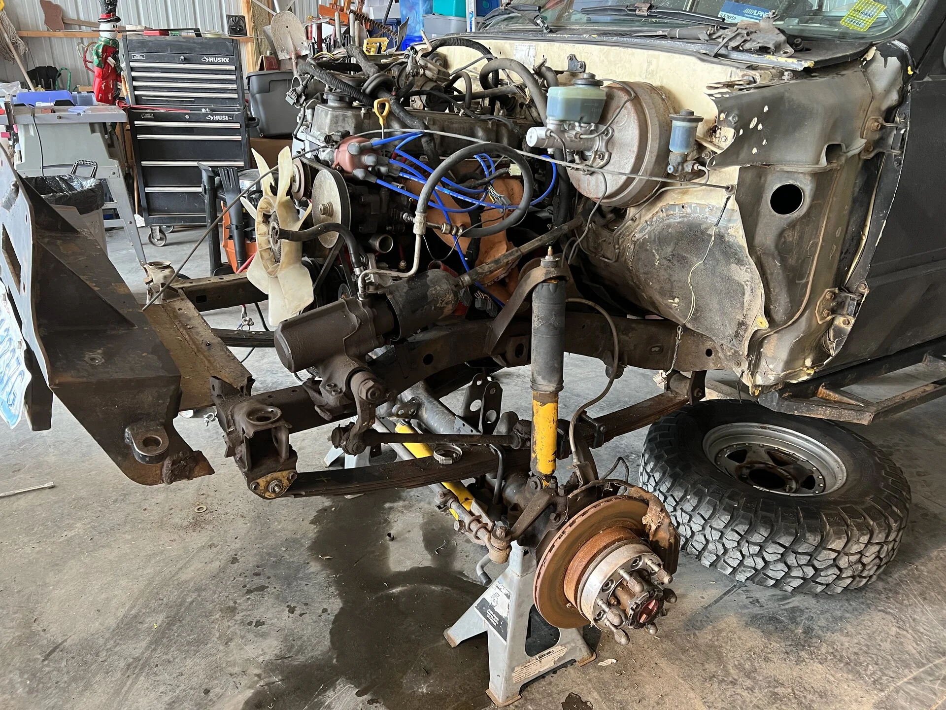

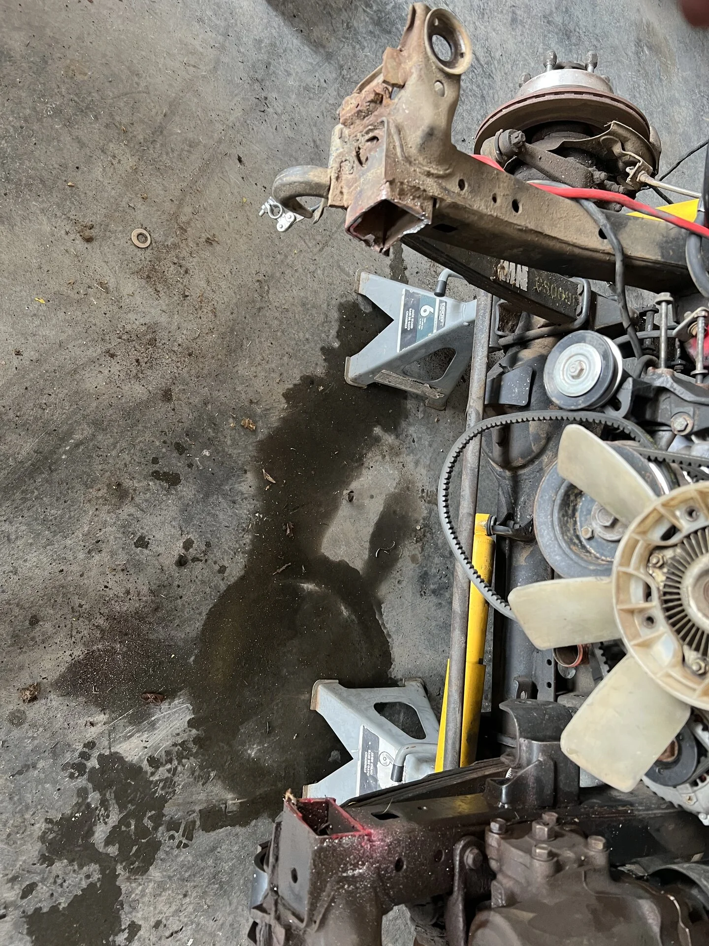

Here’s the drivers side front clip, too much damage for me to bother trying to fix it when I have a front clip with way less damage I can put on. Once the spot weld drill bit gets here I’ll get it cut out then pull the engine, trans, and transfer case. I need to reseal the transfer case as it’s leaking oil and has some blue sealant poking out of it.

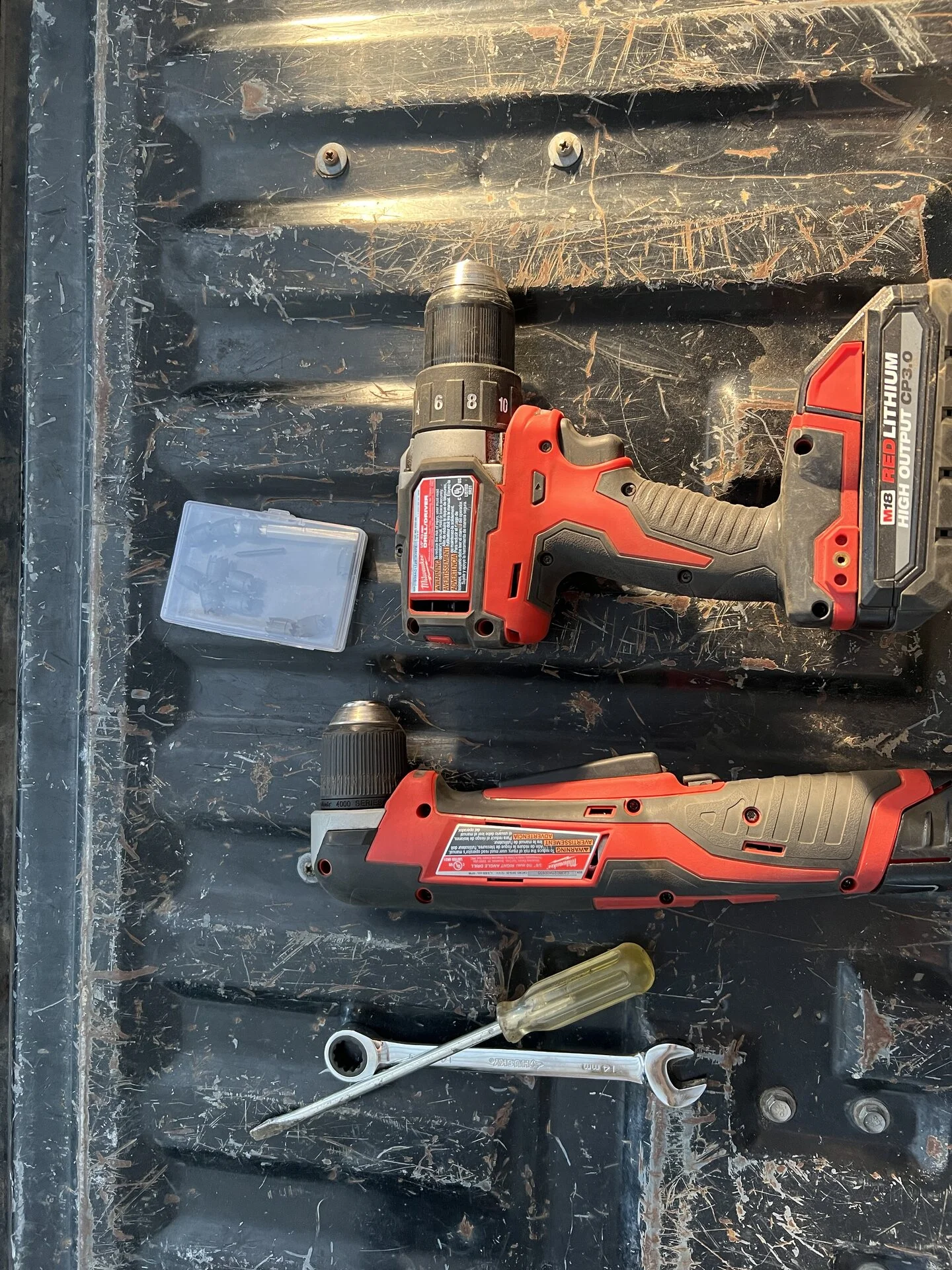

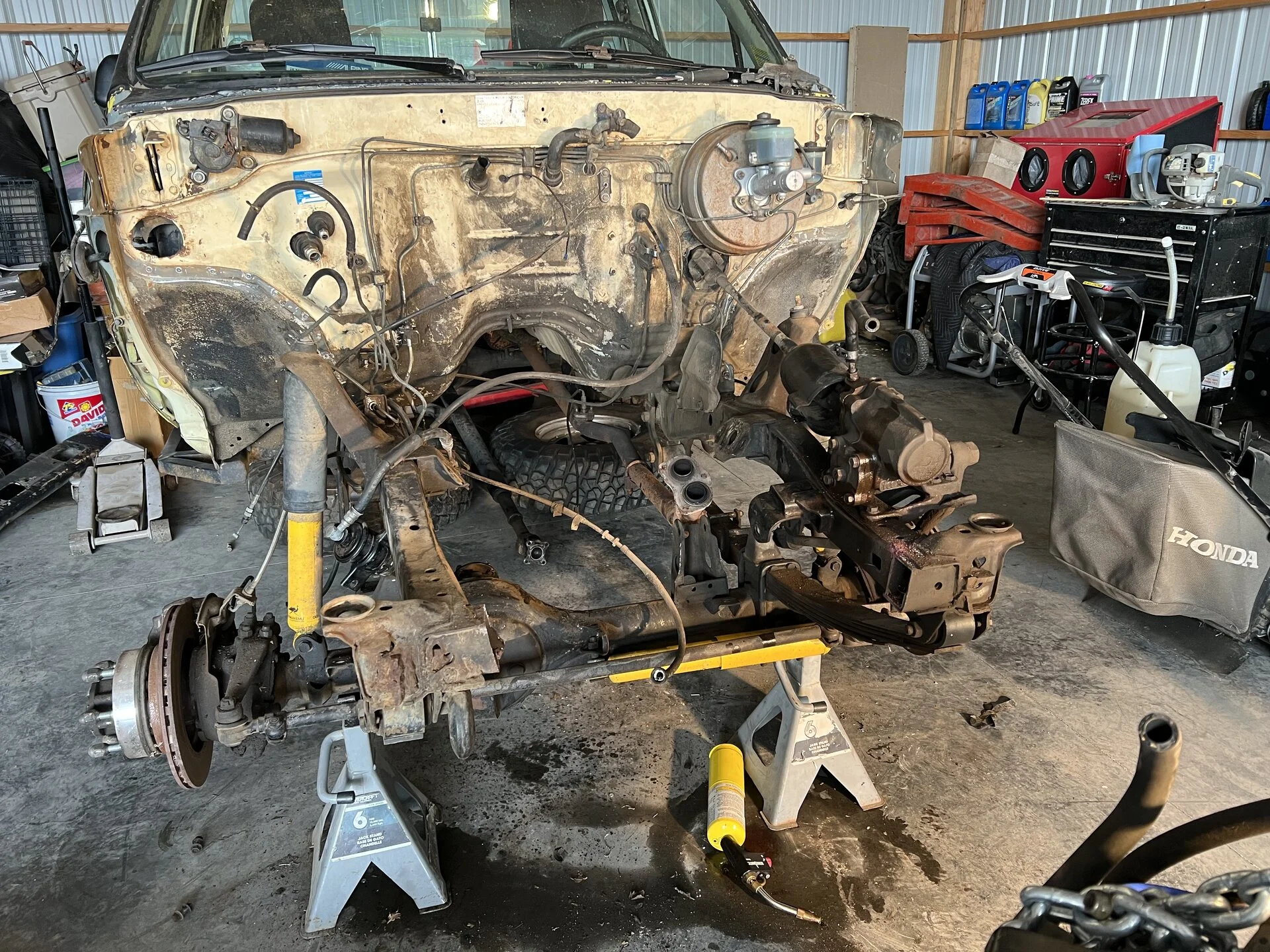

Got the front clip removed today, it works so much better with a spot weld cutter than a drill bit. I used WD-40 for the cutting oil. A 90 degree drill also made the wheel wheels very easy to deal with.
I got the pack of spot weld cutters from Amazon got $20 shipped and I was worried about the quality, I only used one side for all of them and accidentally poked through into the cab on a couple due to their angle.

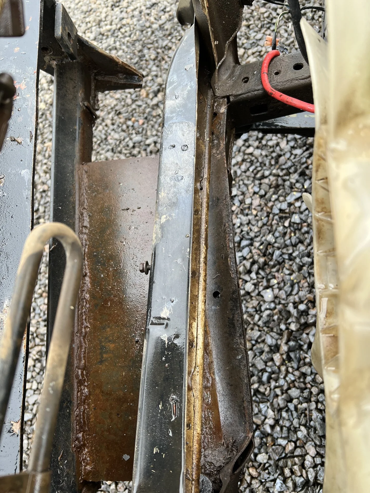

Front cross member is off, engine out and separated from the transmission. I’ll do final clean up on the cross member once I have the 2x2 tubing. For now all I did was use a sawzall to remove it so the winch plate was out of the way.

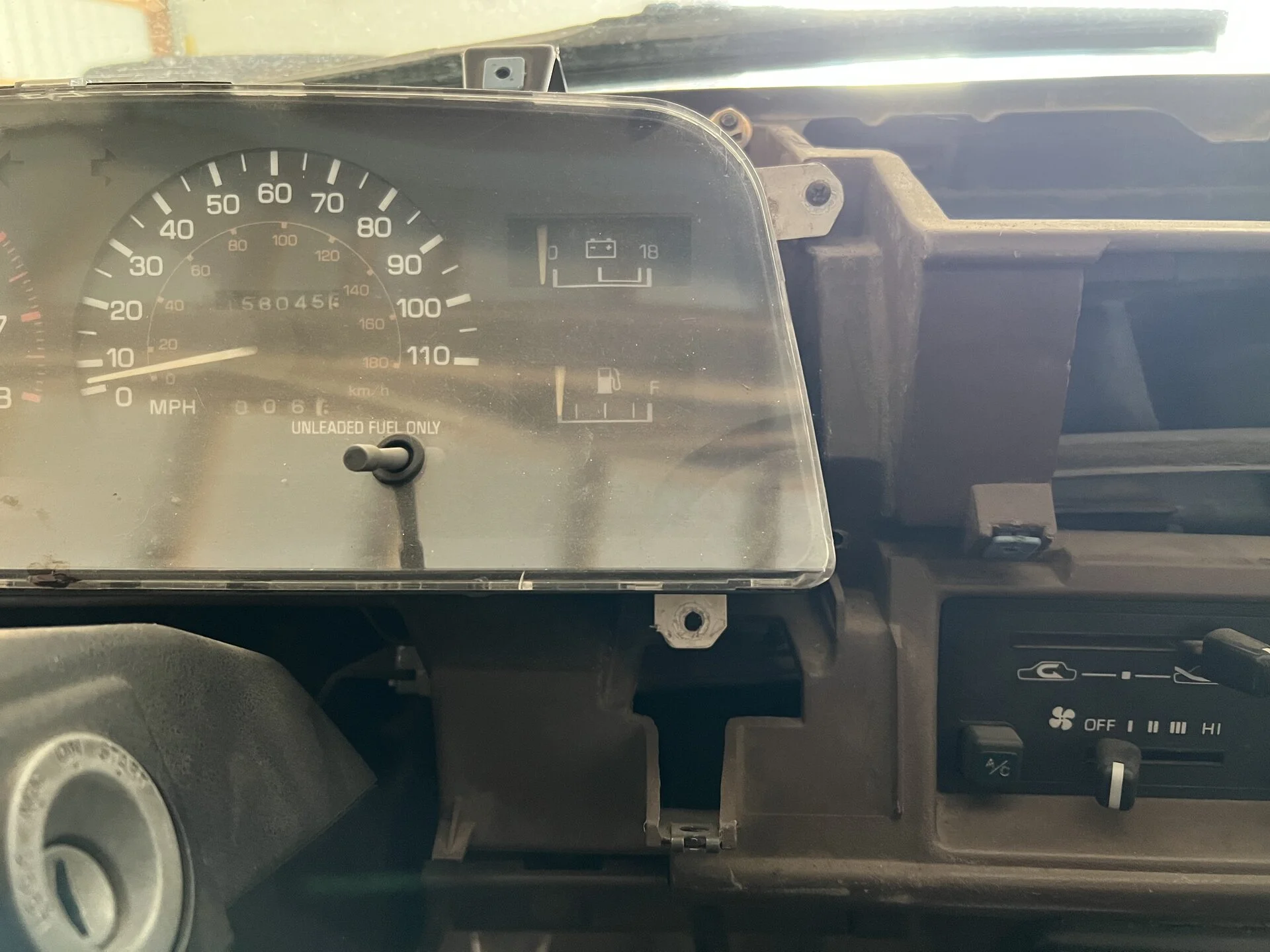

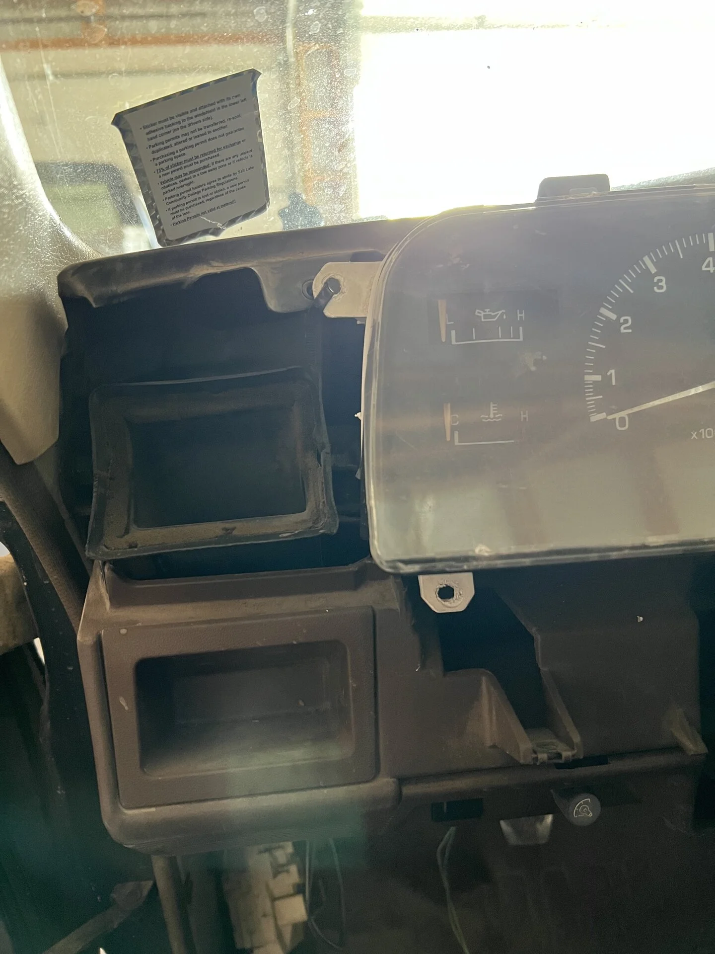

I keep making myself laugh with what I did in high school to this truck. It’s got all the wiring from a 1989 pickup and I couldn’t get the cluster to fit so it’s been held on by a zip tie and one screw. The interior wiring is something else too. I believe I cut the factory speaker wires and ran my own which are all a mess.
Oh, and that fuse box is not mounted at all. There’s a lot of little stuff that I’ll have to fix.
So that's an '89 cluster?
Aside from the mounting, how did it fit behind the '84 bezel?
It fit okay, definitely could’ve been better and I’m actually hoping I kept my old cluster and it’s hiding in a box to install it again.
Did you happen to check if the '84 harness would even think about plugging into the newer cluster?
I’m not sure honestly. If I have a spare cluster I’ll check as I had done the EFI swap in high school and it has been while.

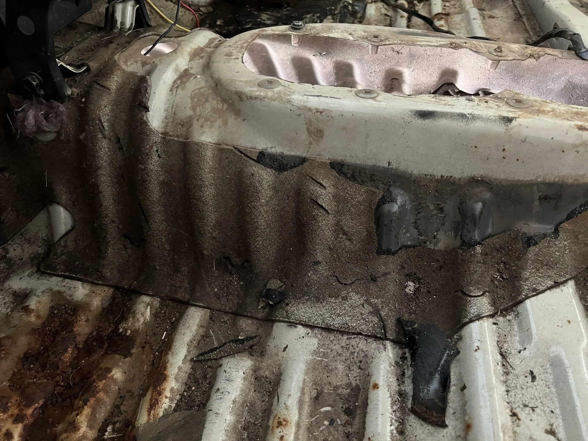

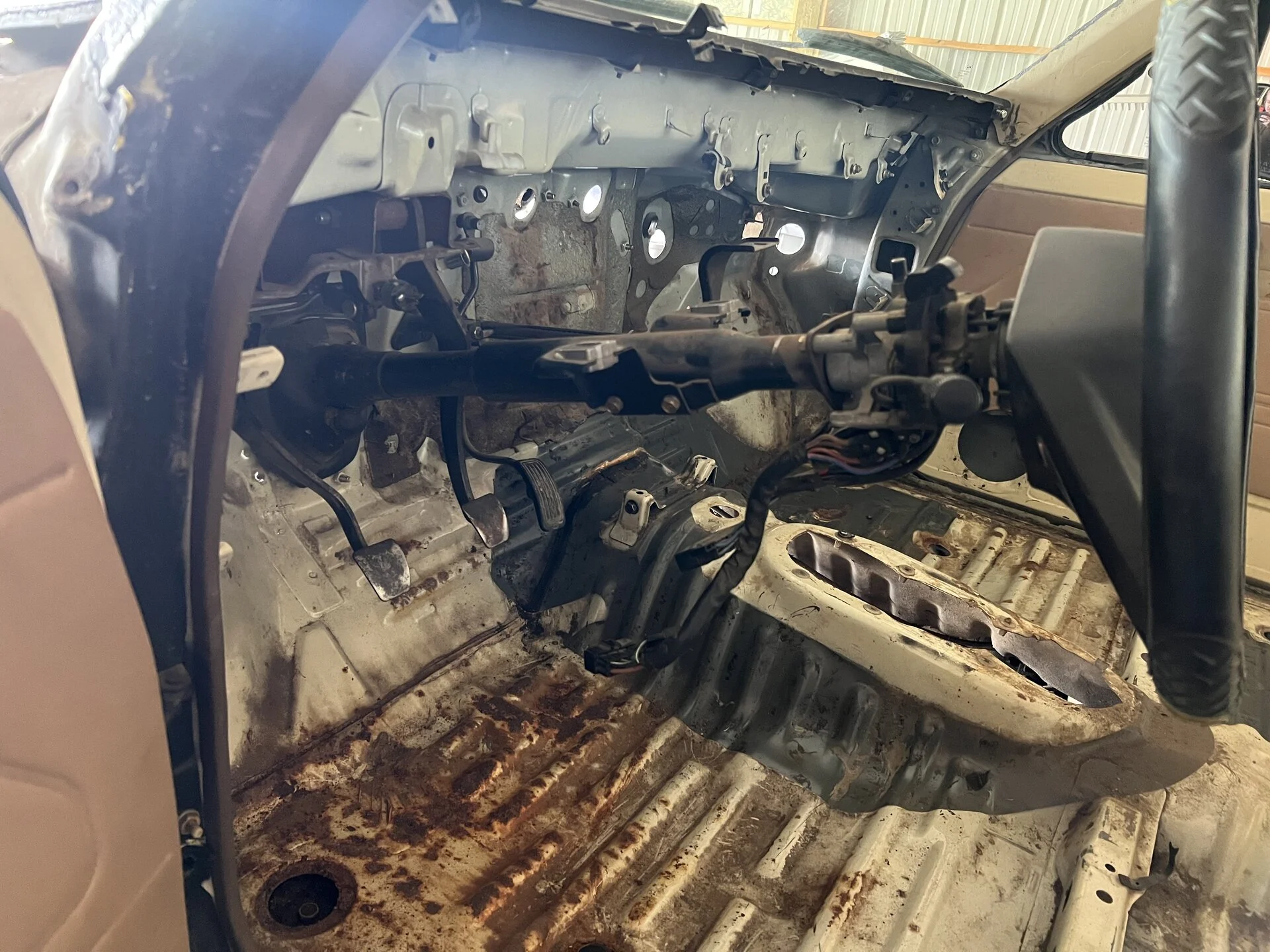

Got everything out of the interior that I wanted to remove. The old sound deadener came off with the use of a hammer and putty knife. There definitely is more rust inside than I had anticipated so it’ll be getting a wire wheel then I’ll paint the whole floor with a brush paint that also neutralizes rust.
If anyone has any good products that they’ve used in the past that are a brush application I’d love to hear about them. I may also end up pulling the cab off the frame and hiring the underside as well due to the interior rust so bonus if it’s good for inside and outside use.
