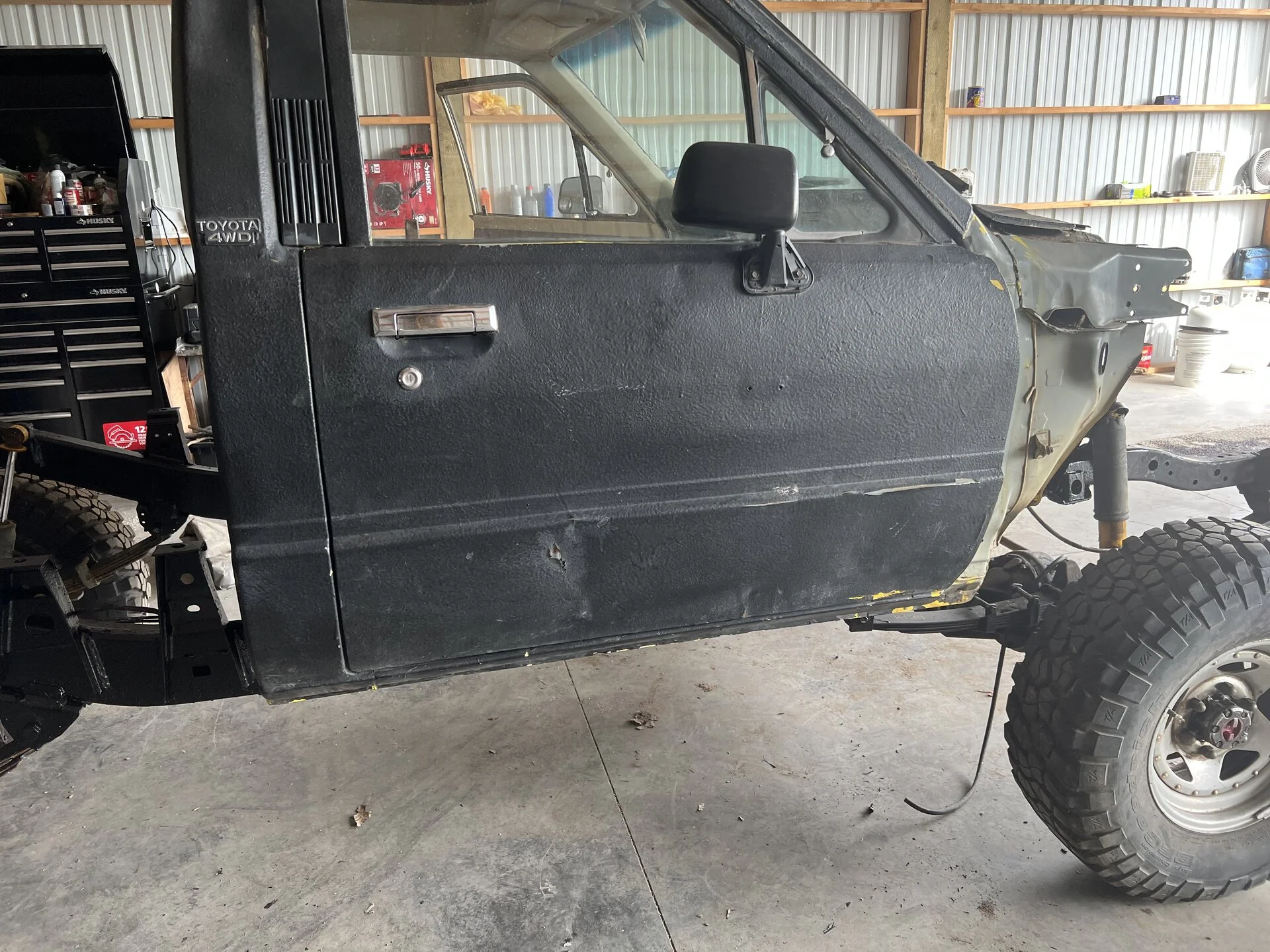

Cab is back on the frame, shocks reinstalled, brake lines attached , doors back on and the rear wiring is rang again. I ordered some Ford twilight clips and a box of assorted wring clips from Amazon to replace all the broken clips.

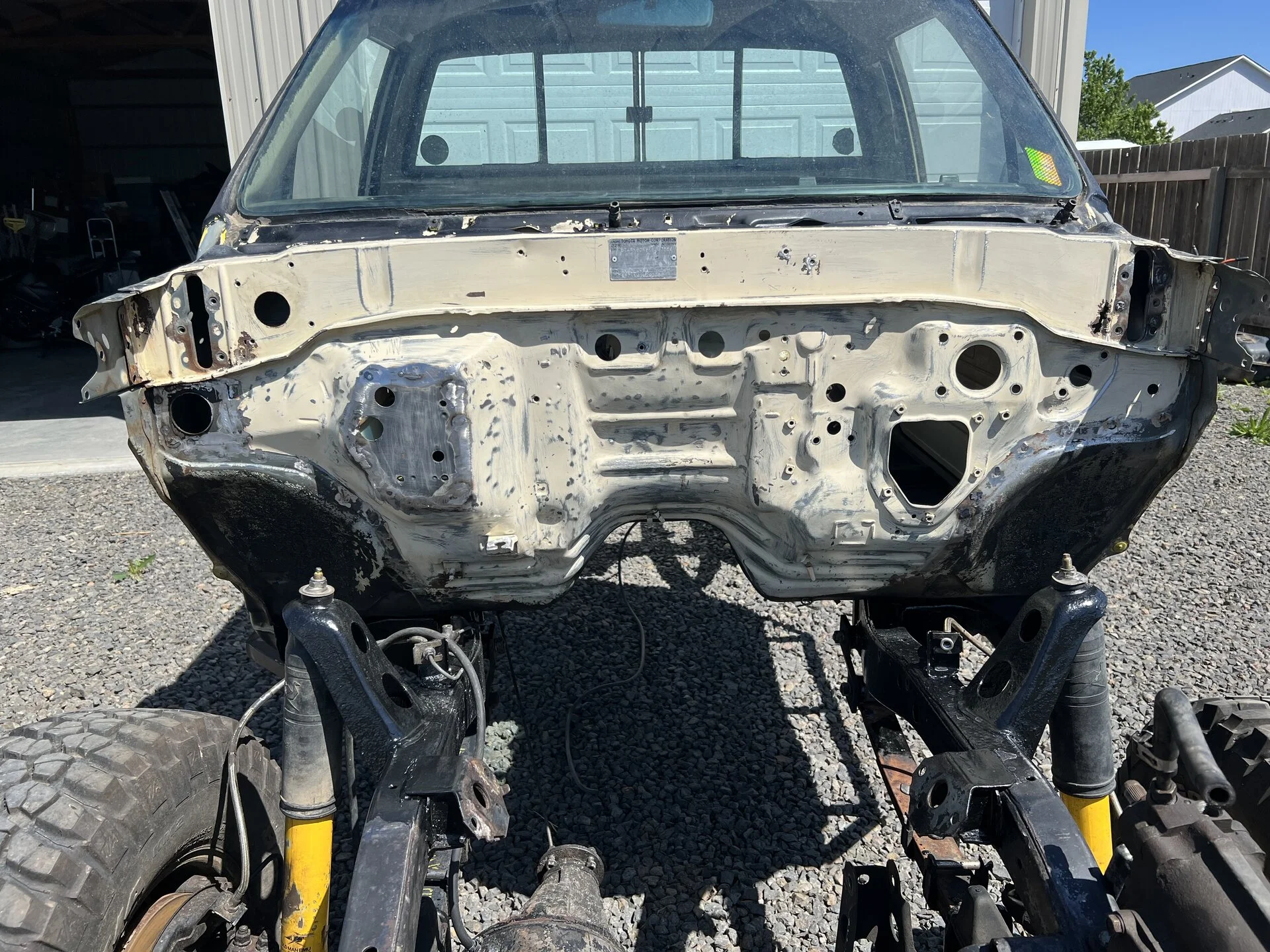

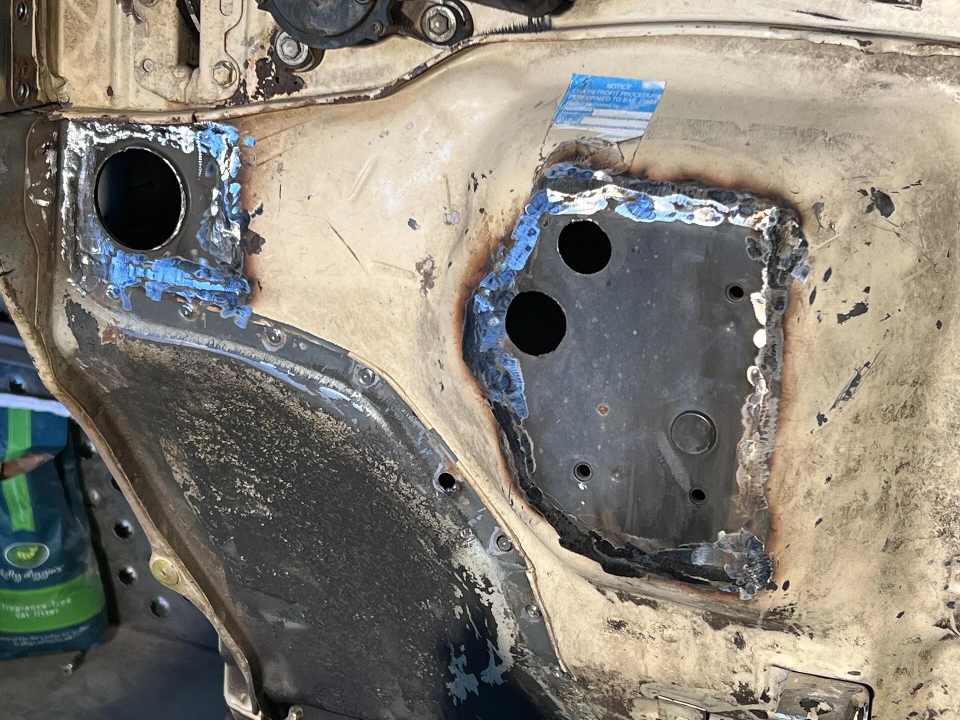

Patch panels are mostly in. There is some spots I’ll need to add extra weld, I did not take any photos of the welds before grinding as nobody needs to see that. I took the “a grinder and paint make me the welder I ain’t” seriously lol.

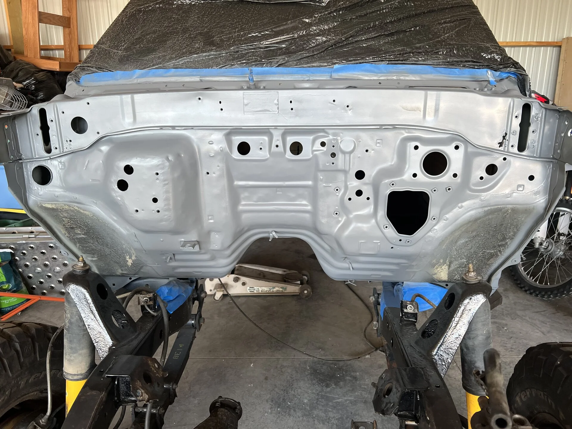

Well, I wanted to go back to the factory colour under the hood, but I refuse to pay the price for all the parts to spray it on and deal with making a make-shift spray booth. To get it in spray paint cants it would’ve been close to $600 all said and done (firewall and front clip).

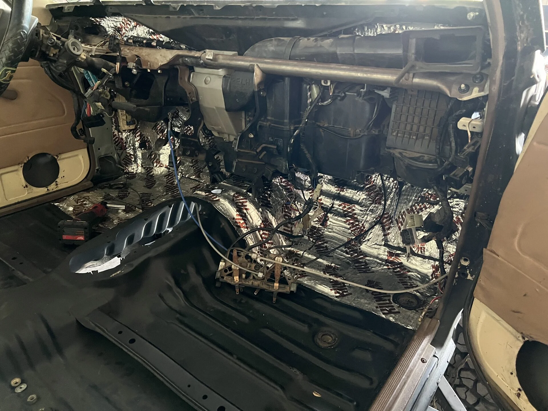

So it got a rattle can job with clear coat to gray. I’ll be adding some heat resistant material to the firewall once everything is back together to help keep the heat from the exhaust out of the cab. Time to add some killmat to the interior and start reassembling the inside.
I have simular motivations with my paint choices! Just about everything I paint is engine paint, usually makes me look like a better painter. You are making good progress and looks good!

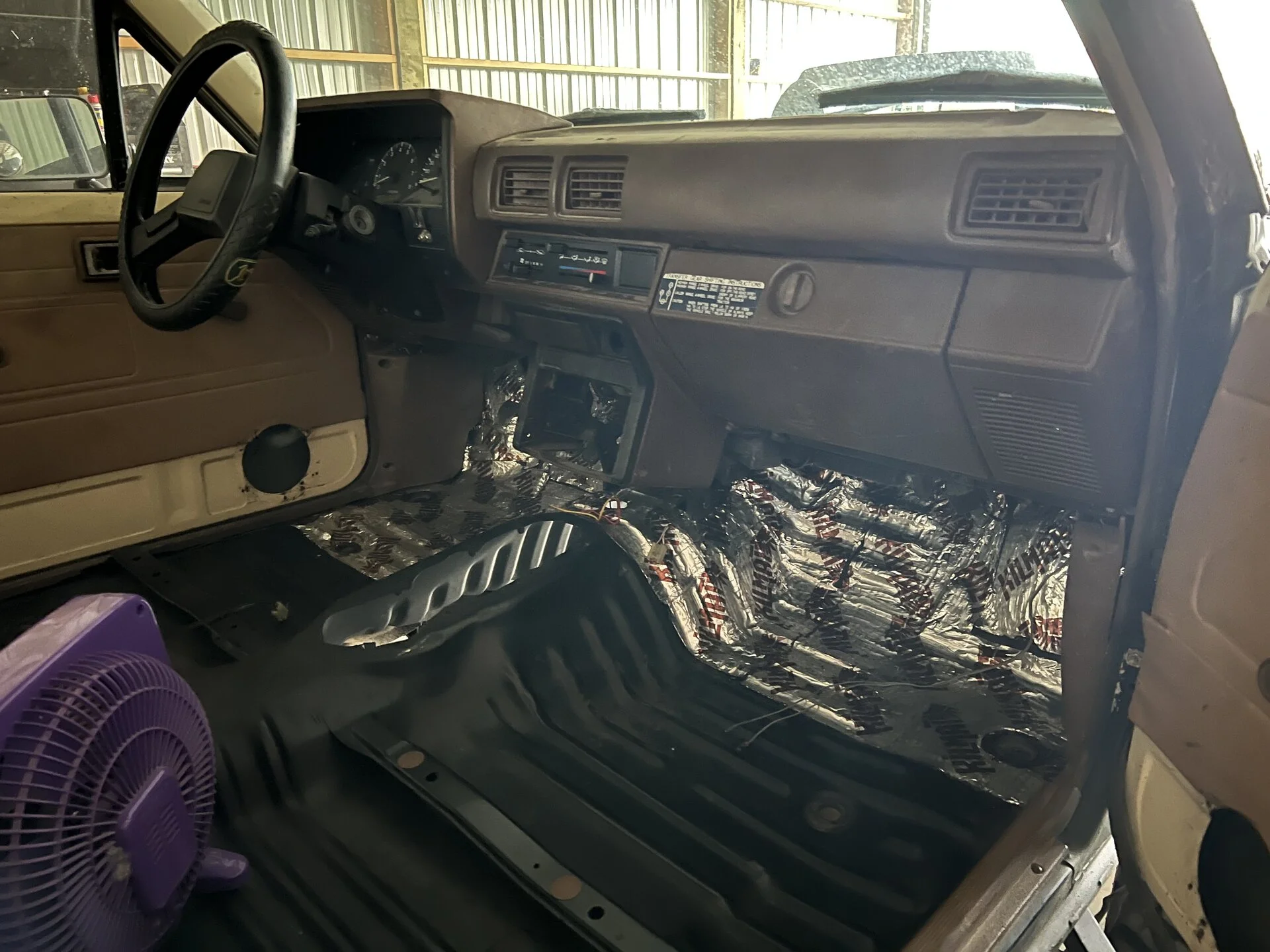

I got the interior reassembled. I’ll finish sound deadening when I order the new carpet. Got almost everything ordered for the 3RZ swap, new fuel tank and fuel pump holder. I’m going to try to save the sender and I have a pump from a 1989 22re I’m going to see if it fits.

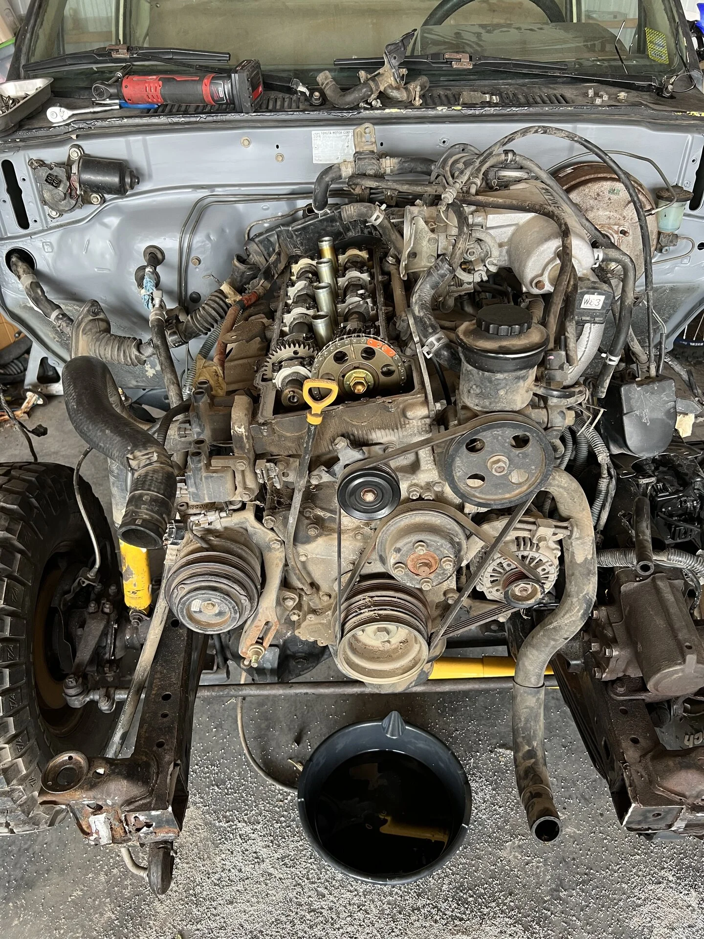

I’m preparation for all the engine work coming up (oil pan, timing chain, balance shaft delete, eft.) I went ahead and “installed” it in the truck. This was using the factory mounts on the 3RZ so it is not finished at all. I will be using swap mounts to get proper geometry, my engine stand is just tied up with another project.
The valve cover was pulled so I could see for any rust, I then drained the oil (only a quart) and found no water (the engine has been outside since 2017 under multiple tarps). I think when I do the oil pan I may remove the main bearing caps and check for scoring in case it was ran low on oil. This engine was hooked to an auto so I’m not too worried about how the cylinder walls look.

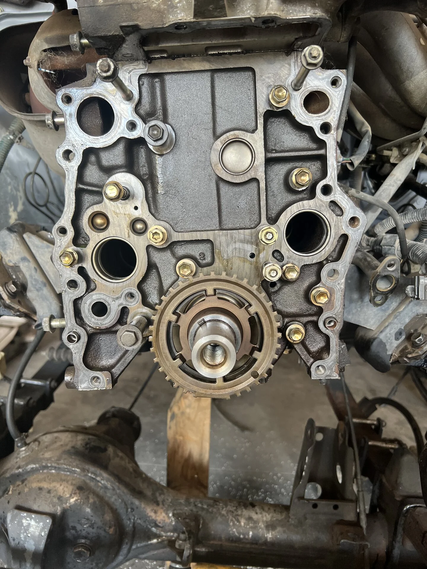

Timing cover is off and balance shafts removed, this motor did have a small knock if I remember correctly (was not that, never heard it) I’m suspecting it was a balance shaft based off of the excess wear on the drivers side balance shaft.

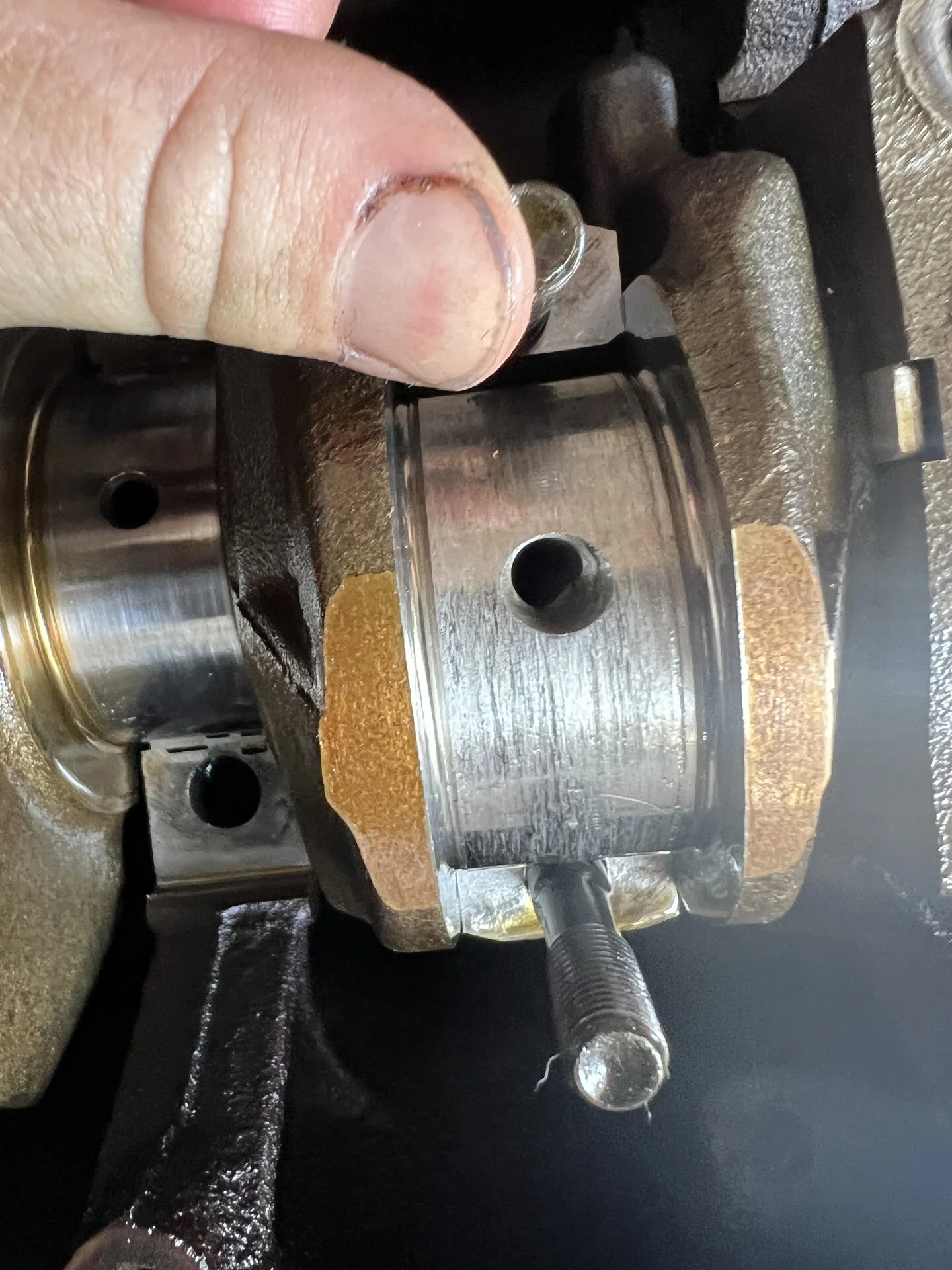

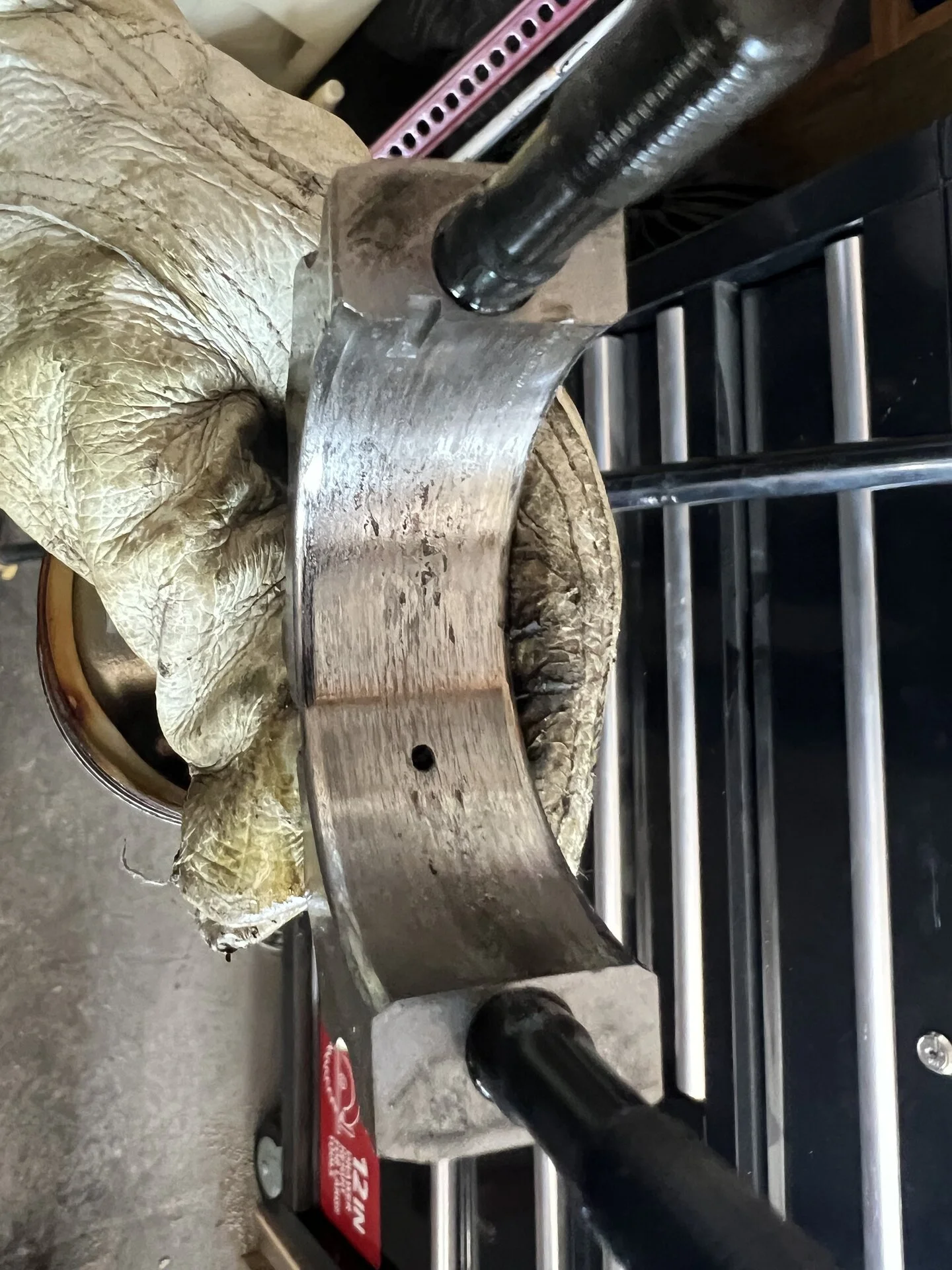

ended up having more time to take the bottom apart today, rod 3 has no bearing left in the cap or rod side. I’m not 100% sure how I want to proceed here now.

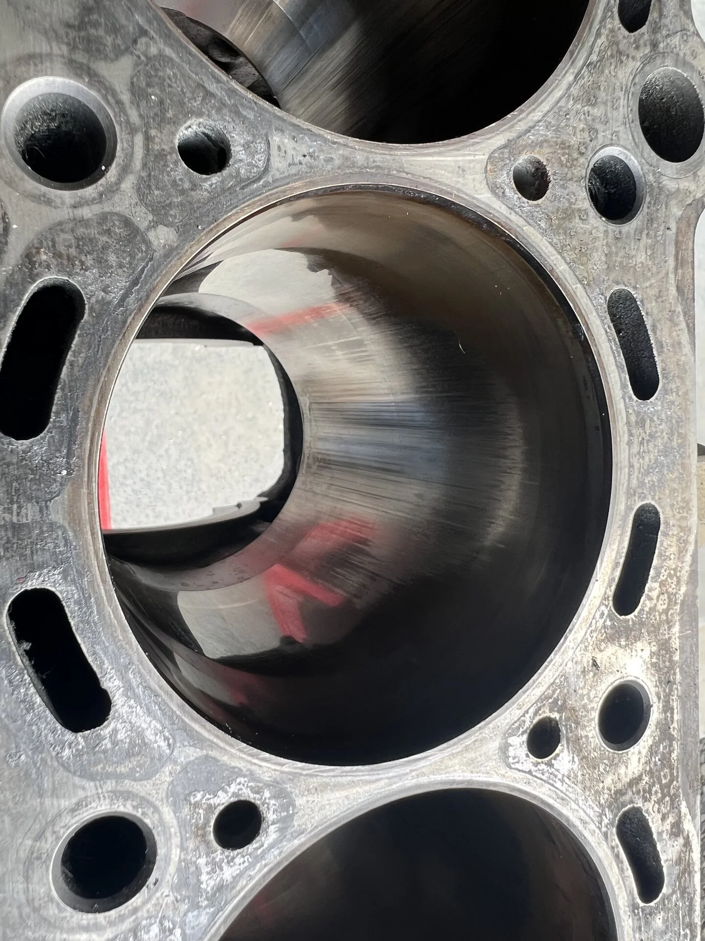

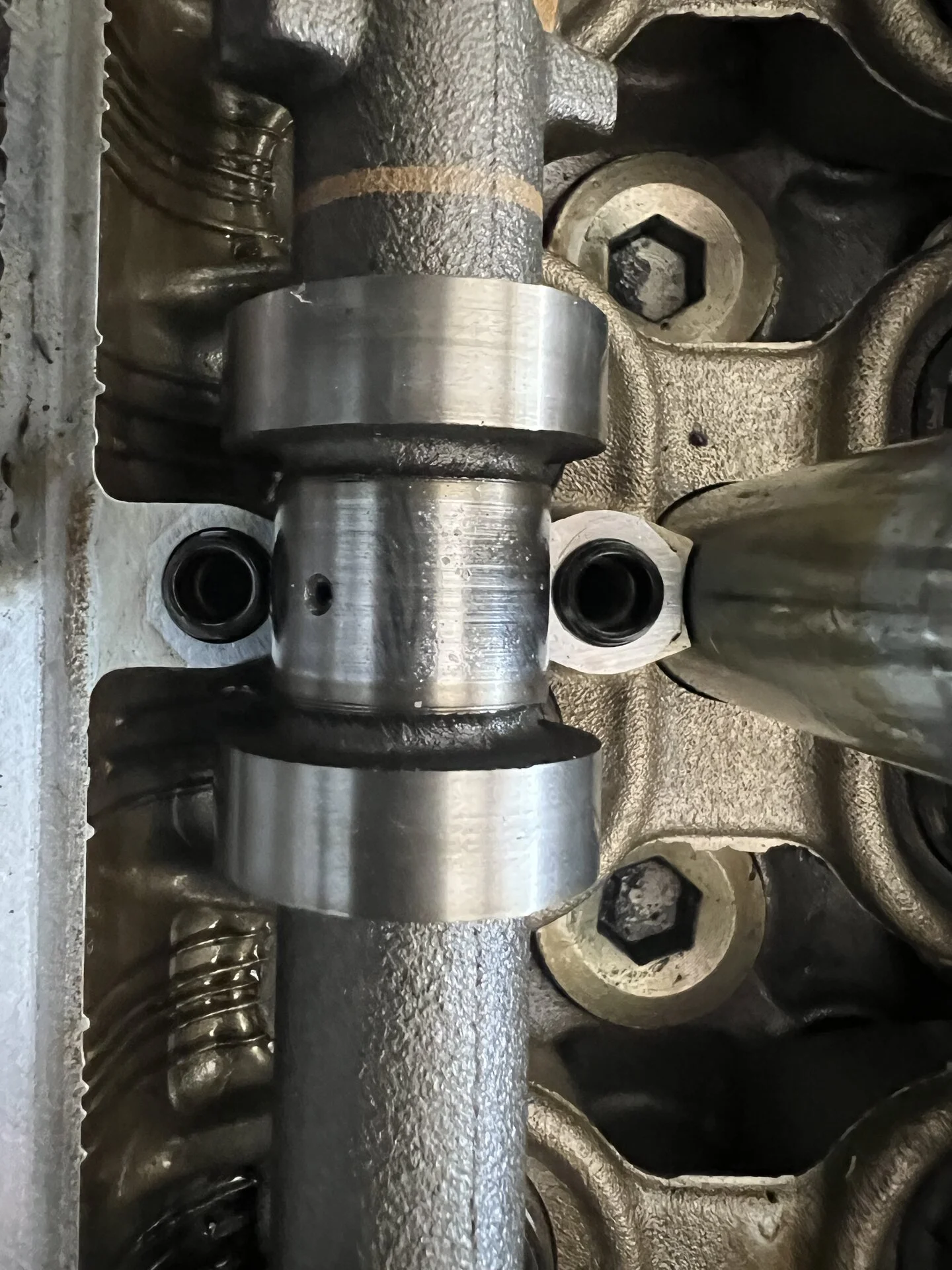

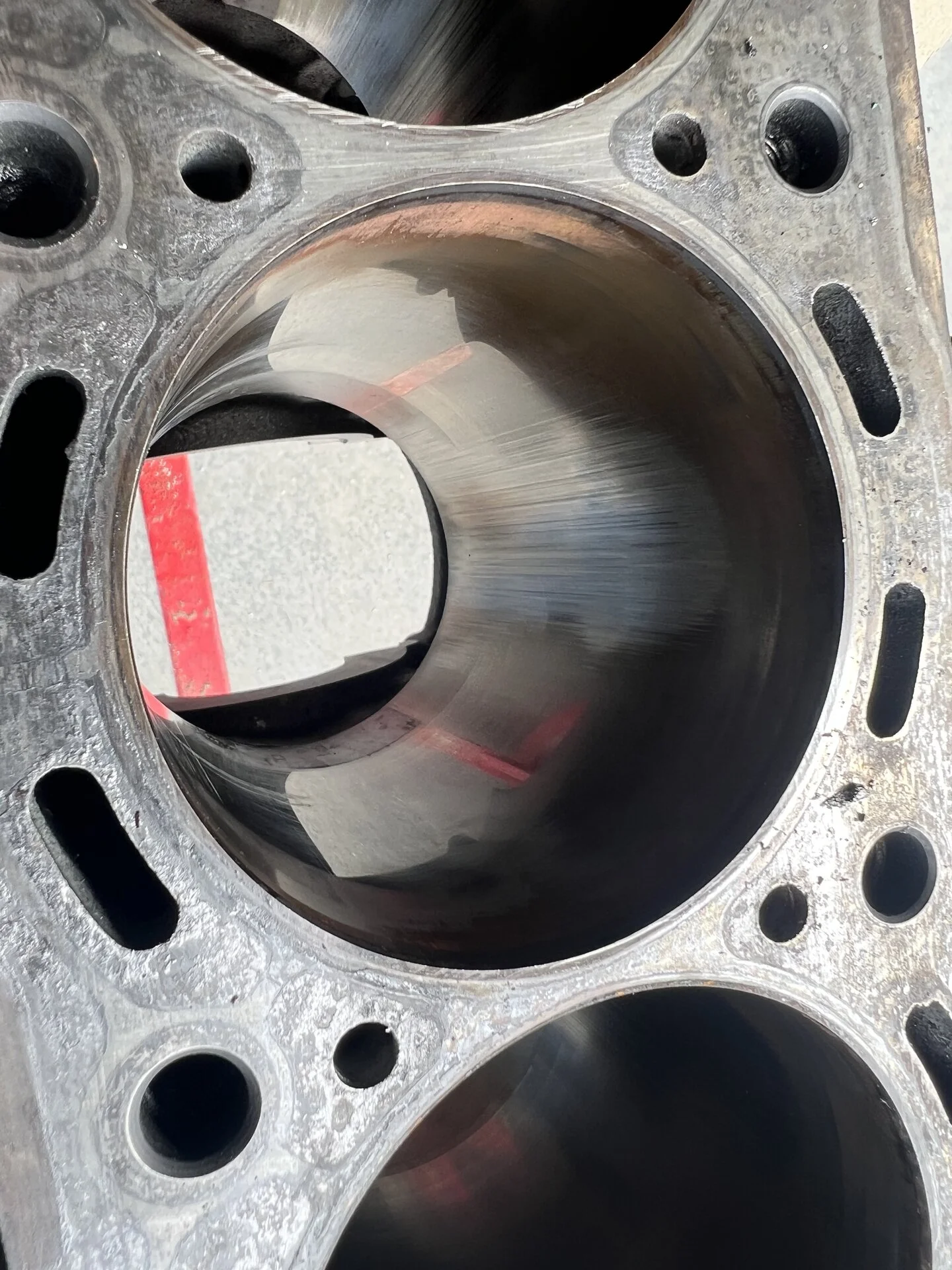

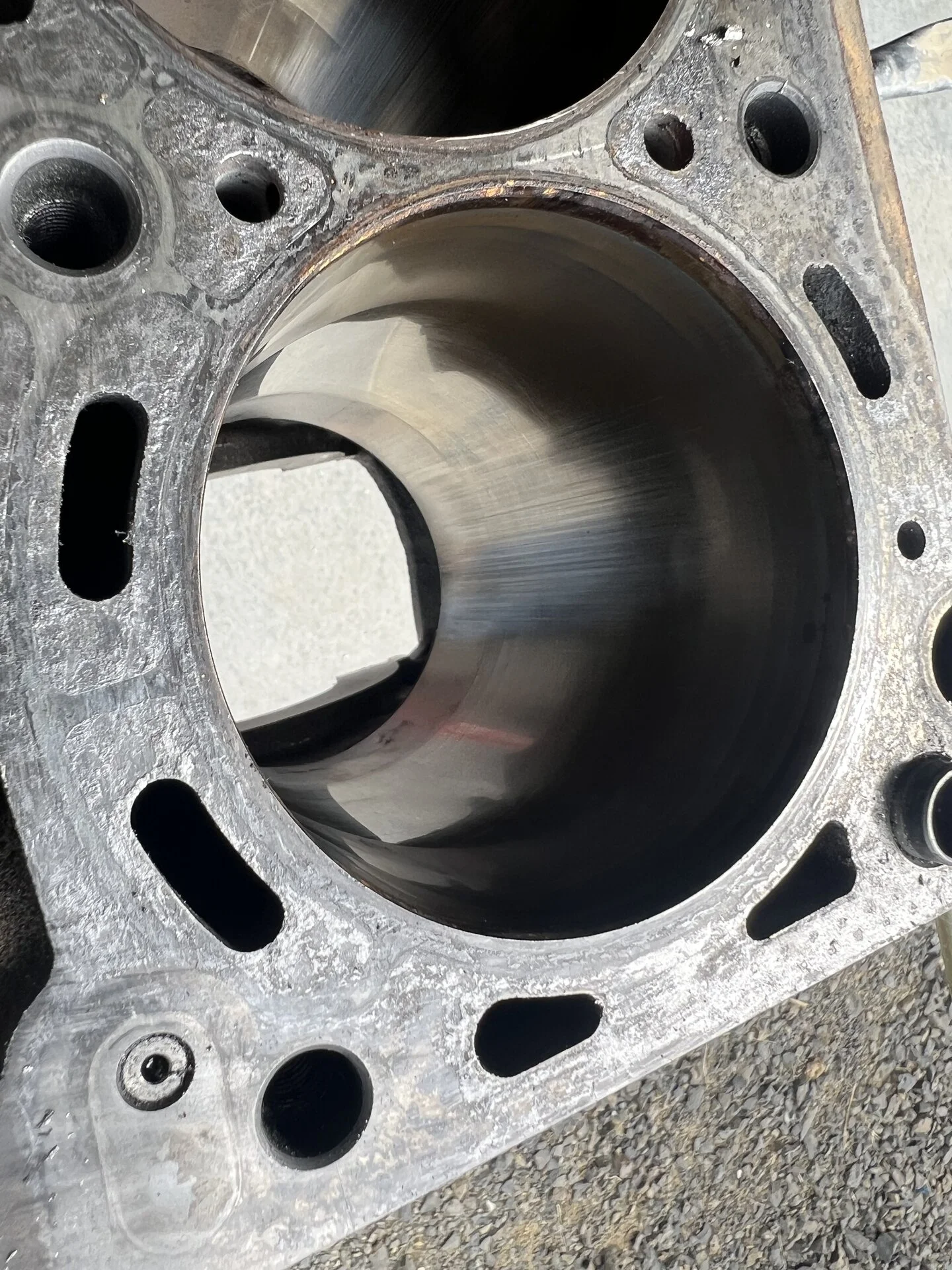

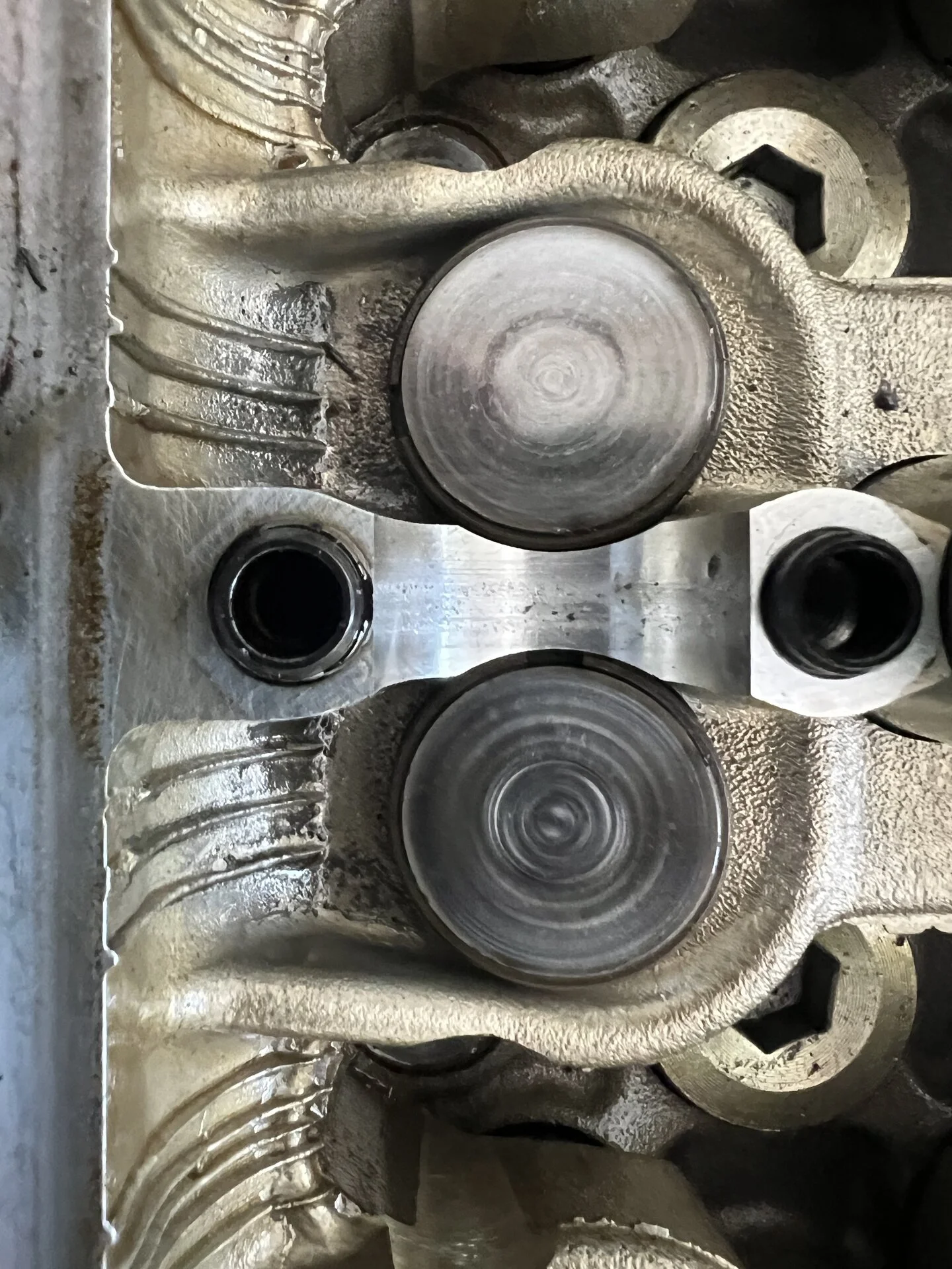

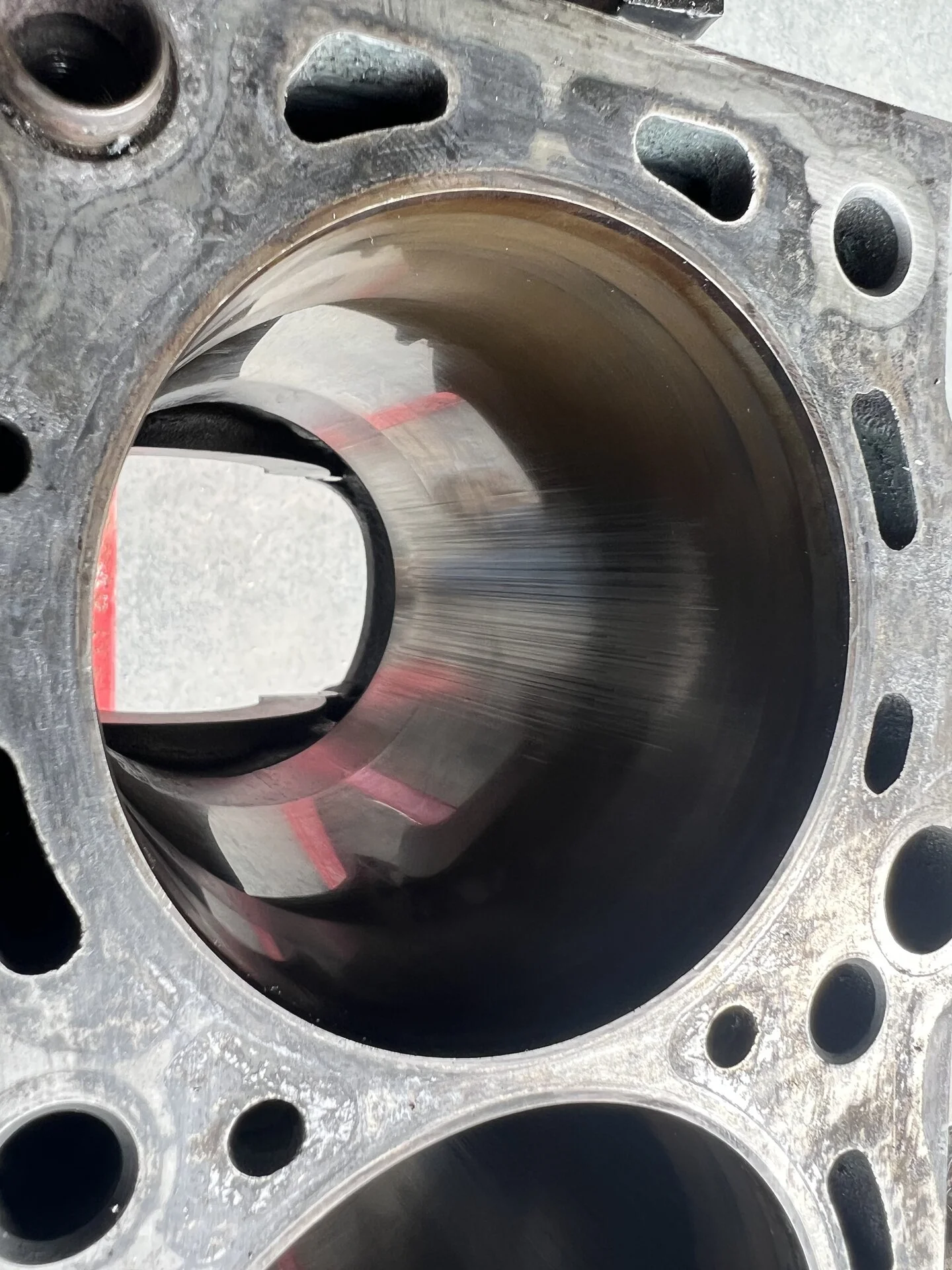

Engine is apart. The head is trashed, the cam bearings and camshafts themselves have groves in them. The block as well, some verticals grooves that you can feel with your finger. The biggest issue is no local machine shops are accepting engine rebuilds right now. So I’ll have to look into a short block and head or shipping the engine out.
Cylinder #3 rod
Cylinder #1, verticals groves on the side and they do catch a finger nail
Cylinder #2, same groves
Cylinder #3
Cylinder #4
