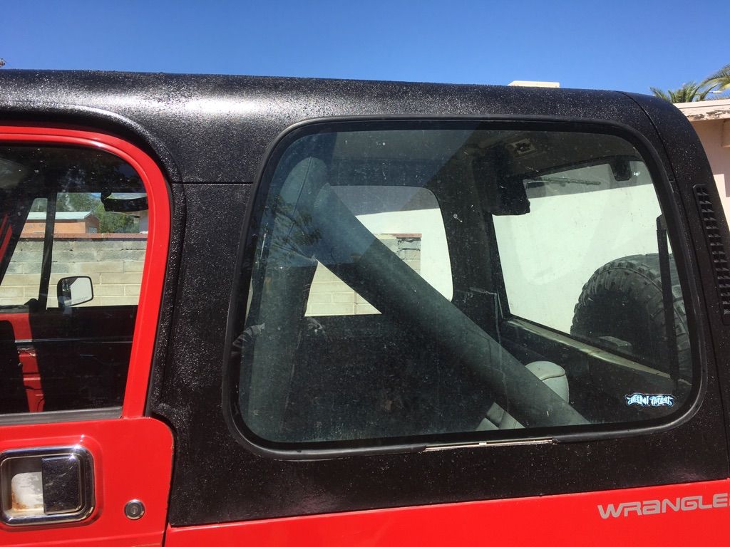

Anywho, Monstaliner is a pretty nice product. I used it to coat my Jeep YJ's hard top and it was pretty durable and looked good. I mixed a little bit of black glossy paint with it to give it a little bit more shine (just since it was the hardtop). I hit trees and all sorts of stuff with it and it never flaked off. Was really happy with it.
That’s perfect use of bedliner aside from in the bed. Frankly I can’t believe you keep reminding us you owned a Heep. Good thing you’ve moved past that now!
Ha! Yes I know I know, I'm not ashamed though. Aside from KLF's Toyota my Heep was the most reliable car I've owned. I was never hesitant to jump in it and go somewhere. It never let me down, always started and drove really well for what it was. I did a lot of work to it so it's still got a place in my heart. She's still stupid reliable, and the new owner (who I actually saw a couple weeks ago) loves it and is using the hell out of it. I guess I was just one of the lucky ones!

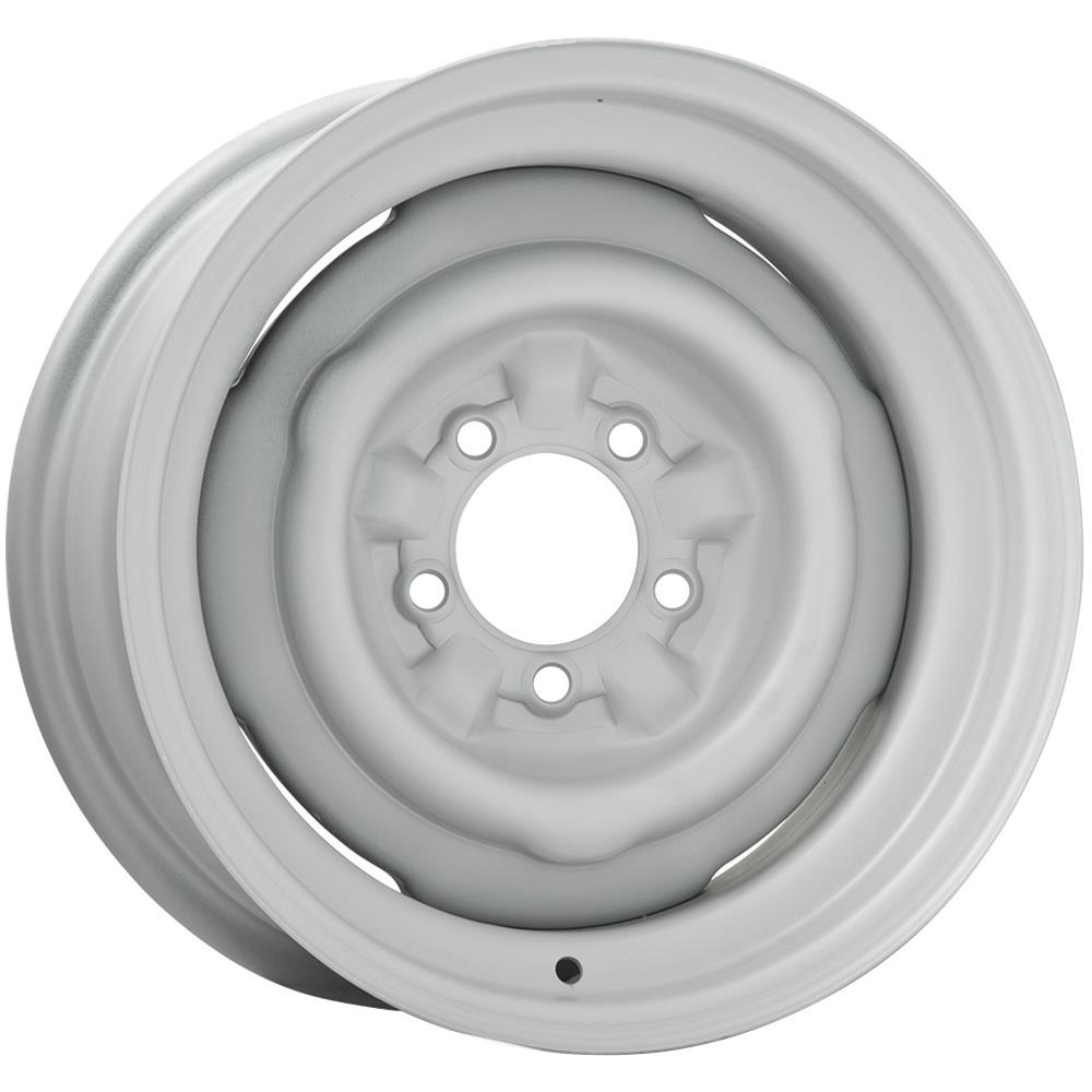

I'm thinking about swapping to some Wheel Vintiques until I can find the correct OEM Pickup wheels (Toyota Part Number: 42601-60082).
Does anyone know if this wheel will work? Does it have enough backspacing to clear the tie rod?
Brand: Wheel Vintiques
Model: Series 62
Wheel Diameter: 15"
Wheel Width: 6"
Bolt Pattern: 6 x 139.70mm / 6 x 5 1/2 in.
Backspacing: 3.75 inch
Center Bore: 4.25 inch / 107.95 mm
Lug Nut Seat Style: Conical Seat 60 Degrees

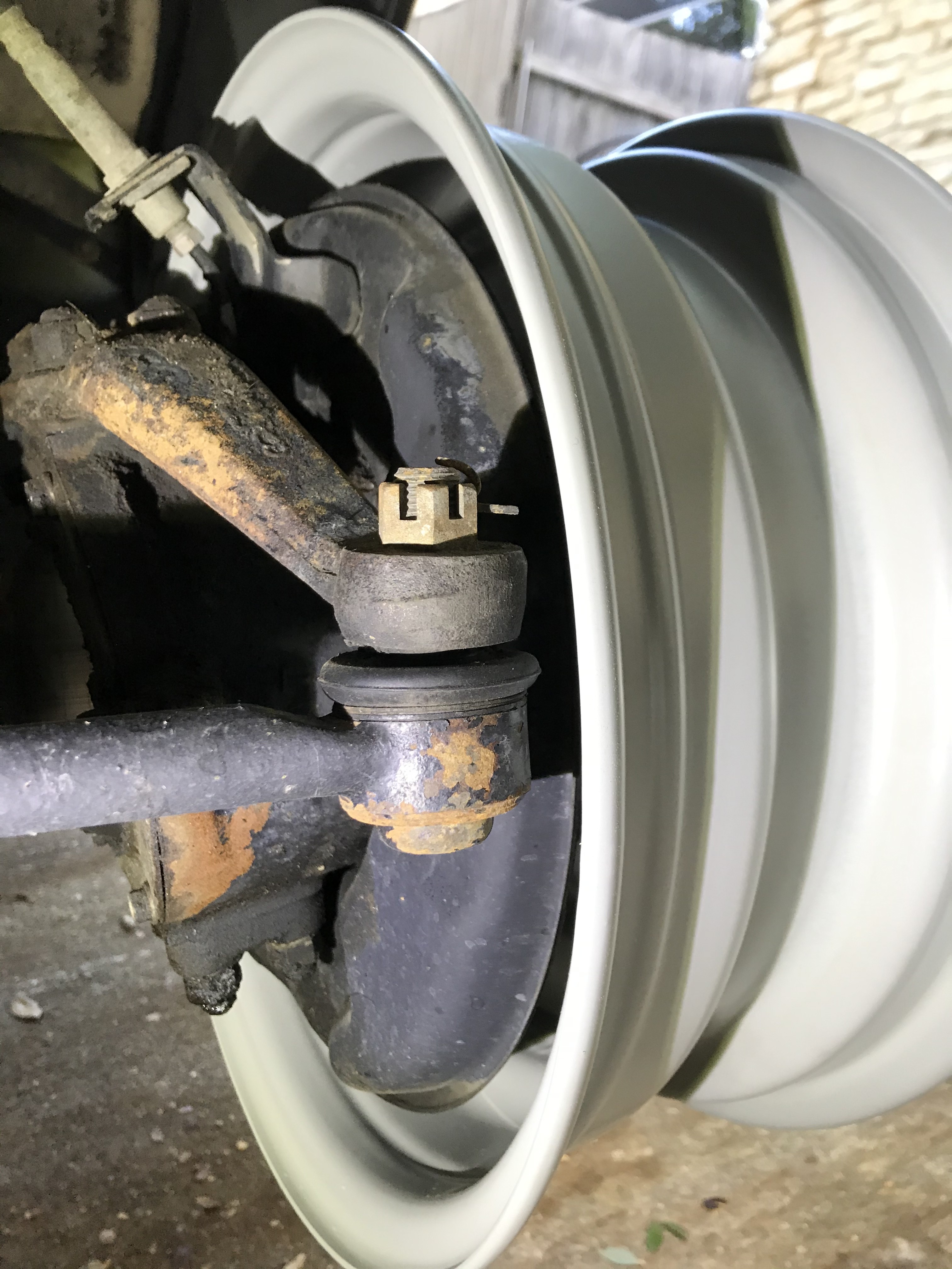

I think you need to stay under 3.5 bs. More like 3 3/8
Cross-over steering is a bit more forgiving on back spacing. If you have the factory push-pull, you can get away with 3.75". It will clear the rod ends, but it will rub the boots on the rod ends. I currently run 3.75" on my SA 4Runner.

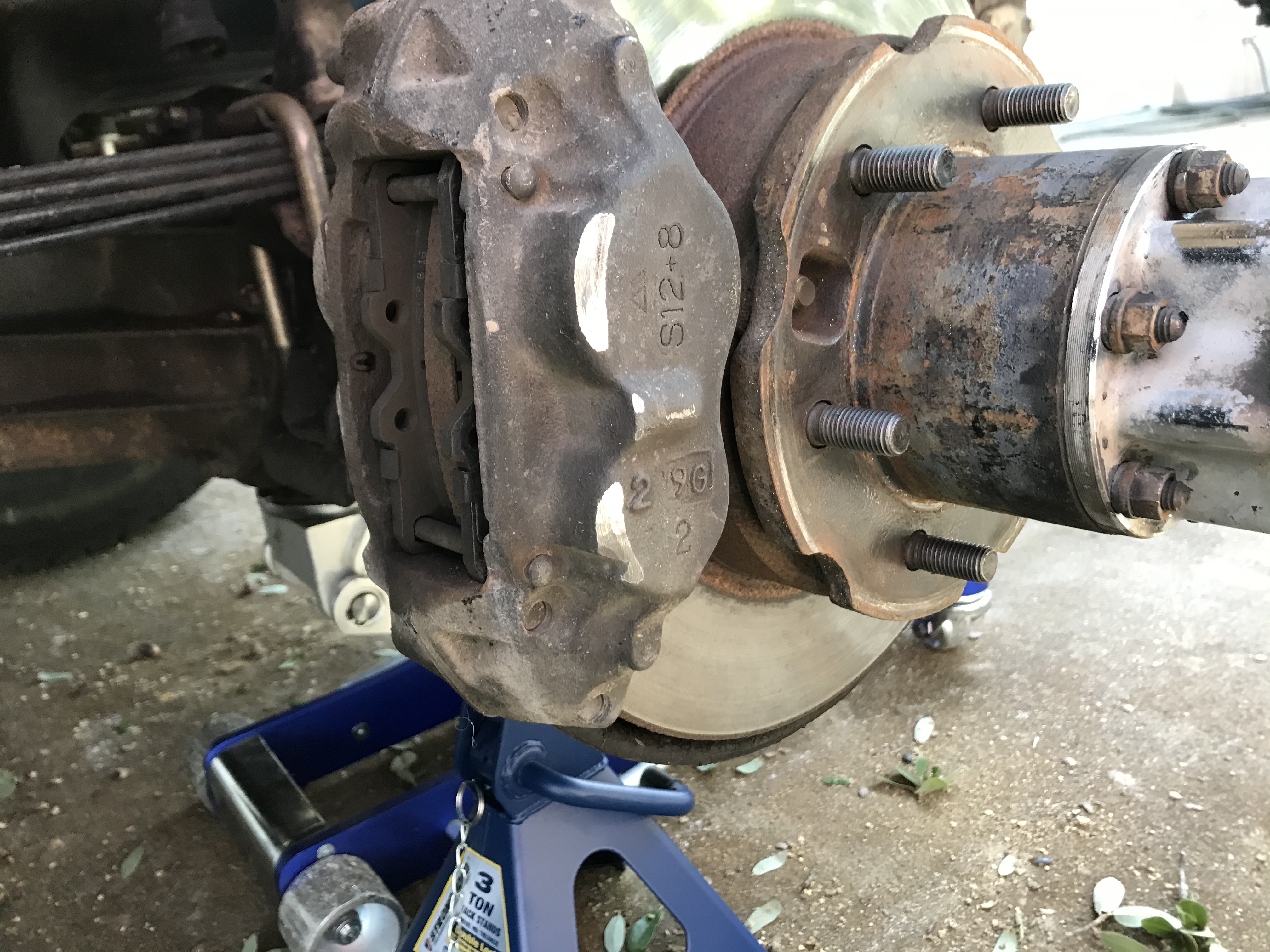

Well, I just test-fit the Wheel Vintiques Series 62 wheels I referenced above. I was trying to pick a wheel as close to factory Toyota steelies as I could.
They are almost identical aesthetically.
OEM Toyota Steel Wheel for solid axle Hilux/Land Cruiser w/o tabs (Toyota PN: 42601-35390-05)
Wheel Vintiques Series 62 (PN: 62-5606334)
The rim edge clears the tie rods.

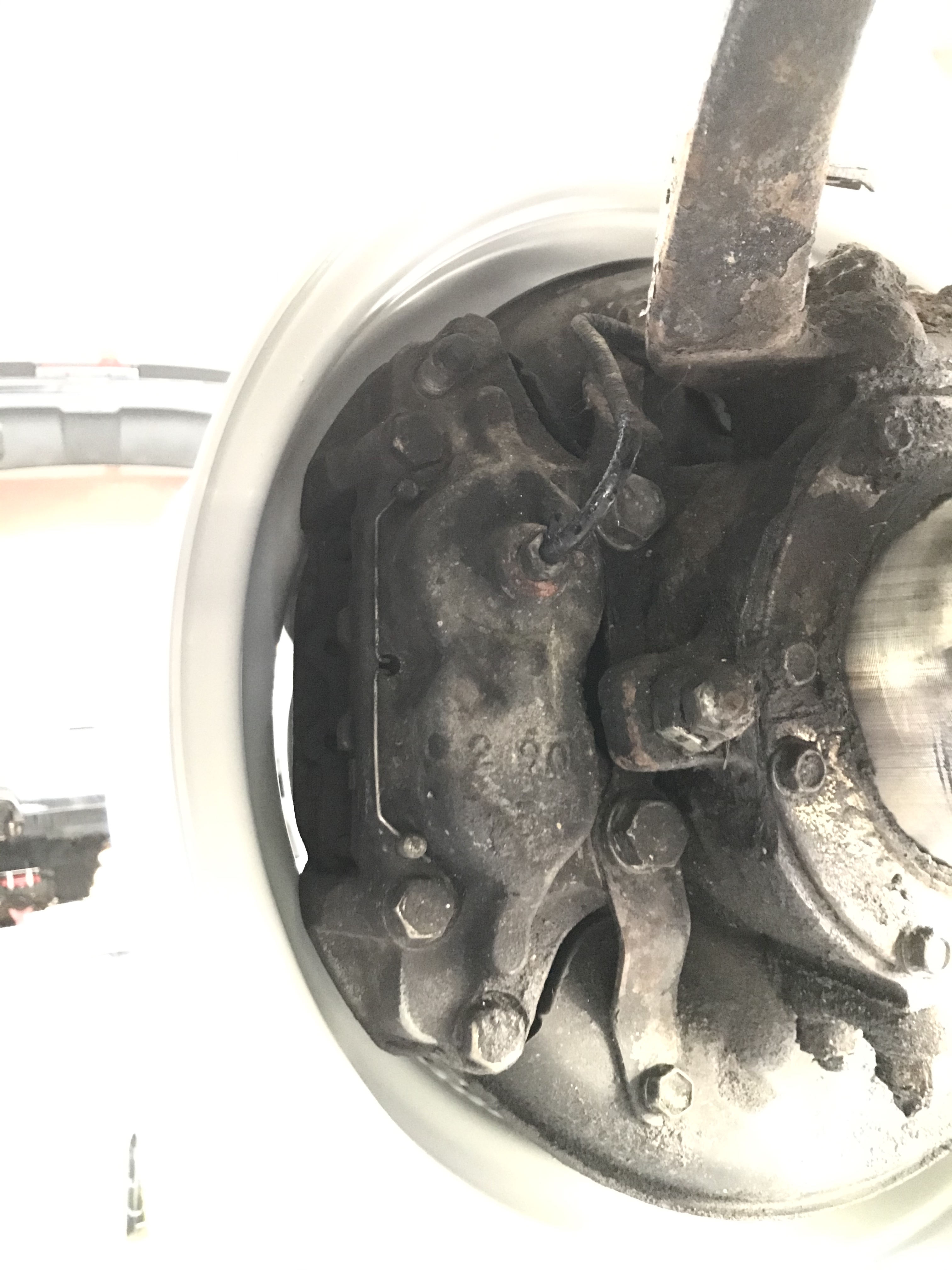

And the brake calipers clear the barrel of the wheel.

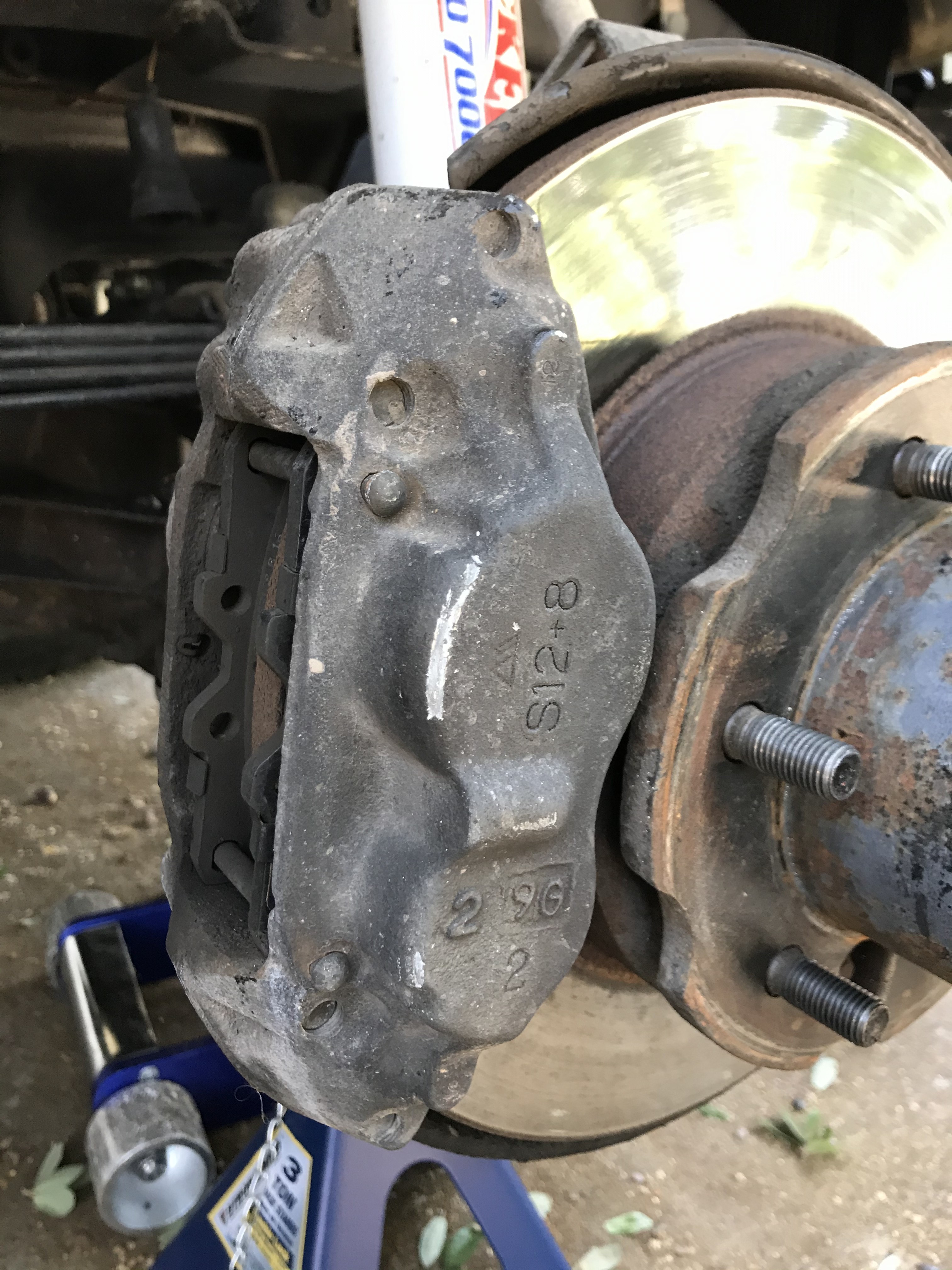

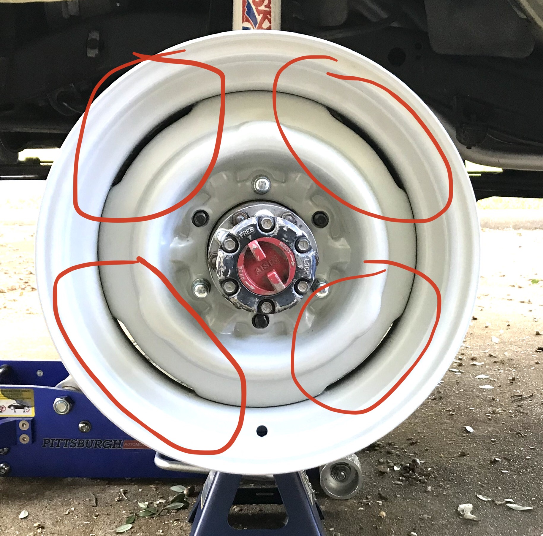

But the slots machined into the wheel do not clear the front corners of the brake calipers.
You can see where it's rubbing the caliper here.
After a s***-load of test-fitting all four wheels, and some light intermittent grinding, this is the result.
It clears the wheels after light grinding of the brake caliper.
Obviously I would approach this wheel and tire setup differently knowing what I know now. I had already purchased the 15" BFGoodrich KM3 tires before I realized the IFS Toyota steel wheels I bought wouldn't fit. In hindsight, I would have just kept the 16" wheels/tire setup that was on the truck until I could find the correct OEM steel wheels.
Regardless, I think this wheel and tire setup will work after grinding the caliper.
Now off to powdercoat. I'll post pics once I get everything mounted.
